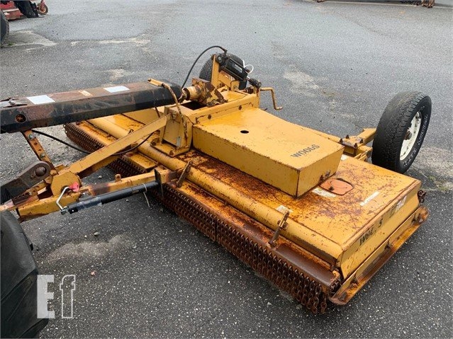

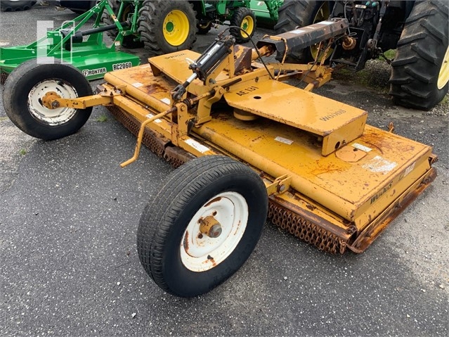

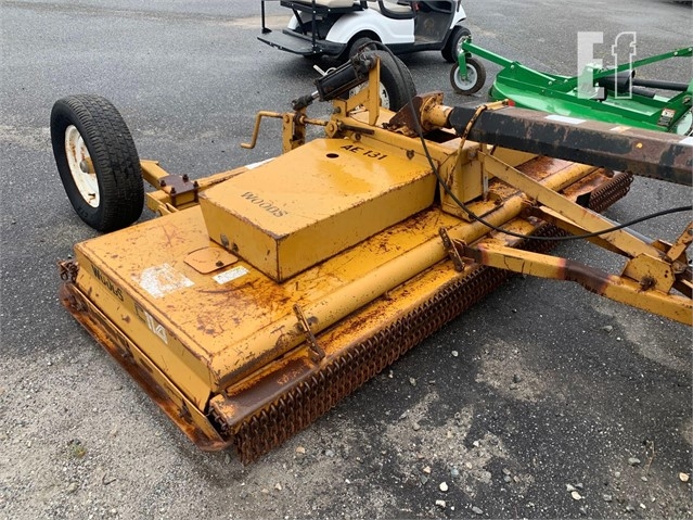

Here’s a picture of the factory driveline on a C114. I can turn so tight the rear tractor tires hit the tongue and the driveline is fine.
There are three u-joints in the driveline.
Here’s a link to one with the cover removed. What did I just buy?

The two piece pto shafts on towed equipment is designed to keep the pto u-joint angle equal while turning with the drawbar set for the proper length to the hitch pin the short shaft will be centered over the hitch pin so the u-joints maintain equal angles. That equipment will have a specification for the drawbar length as measured from the end of the pto shaft on the tractor.

That makes a lot of sense to put a U-Joint near the pivot point, so you aren't relying on a significant amount of telescoping as you turn.
I'm seeing notes that the max angle of a single U-Joint is around 45 degrees.

On the long shaft setup you should get a CV joint at the tractor end because angle differences will excite some serious vibration and potential damage. Plus, the cost of a long shaft + slip clutch + CV joint may be higher than 2 shafts piggy-backed. Single u-joints are practically limited to no more than about 25 degrees because of the 2x per rev cyclic variation in rpm.
