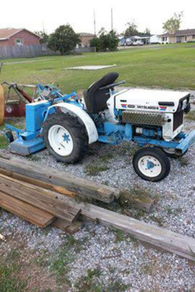

Hi All! I recently purchased a 70s Satoh Beaver 15 HP. It has a Woods finish mower and a 4 foot bush hog. Recently while testing the implements, I had to operate in 1st gear low or the tractor would bog down and smoke. My PTO settings sticker is missing so I am not even sure if I am in the right setting for the implement used. Can someone post a picture or explain the different settings of the PTO (I know there is an N,1,2,3 but not sure where they are located) and what number you would suggest to be in for operating each type of deck. Thanks in advance... Satoh.jpg

As soon as I get home I will take a pic of mine. With the lever all the way forward it is in 1(540), then one click back is neutral. The next click up is 2nd, then another neutral. And the last closest to you is 3rd.
   / PTO Settings #5
I run my 470 in 1 for bush hogging and 2 for mowing with a Woods mower.
   / PTO Settings #6
Irishman73 described the same position arrangement as my MT372. The operators manual lists the following speeds for those positons:
Position 1 (first) 565 rpm, position 2 (second) 832 rpm, Position 3 (third) 1364 rpm. this is all at an engine RPM of 2700
The "standard" pto speeds listed are 540 in first at engine rpm of 2580, and 1000 rpm in third at engine rpm of 1979.
