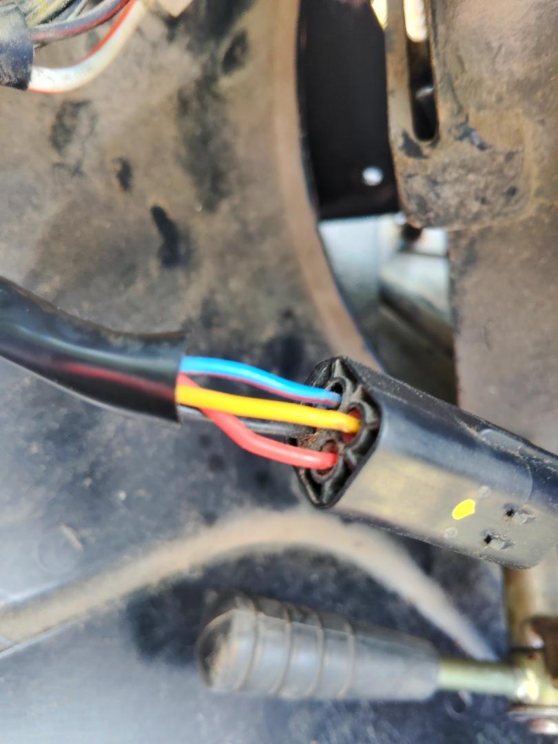

Branson 3015R
Got a question about my 2018 Branson 3015R. Got clumsy pulling my dash and pulled the wires out of the PTO Selector switch. Been all over trying to find a picture or a "decent" wiring diagram, but no luck. And of course, the wires going to the switch are different slightly different colors from the harness, but close enough. Note that the switch harness has a black wire and the harness does not. There is a plug in the hole. I'm assuming that is the ground for a different model.
Pics: Tractor 2 is the harness, Tractor 3 is the selector switch.
Can anyone send me a pick, or at least a hand diagram.
Thanks,

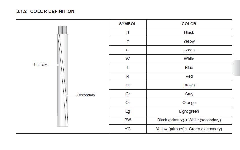

   / PTO Selector Switch #2
Let's see if any of these pictures help you:

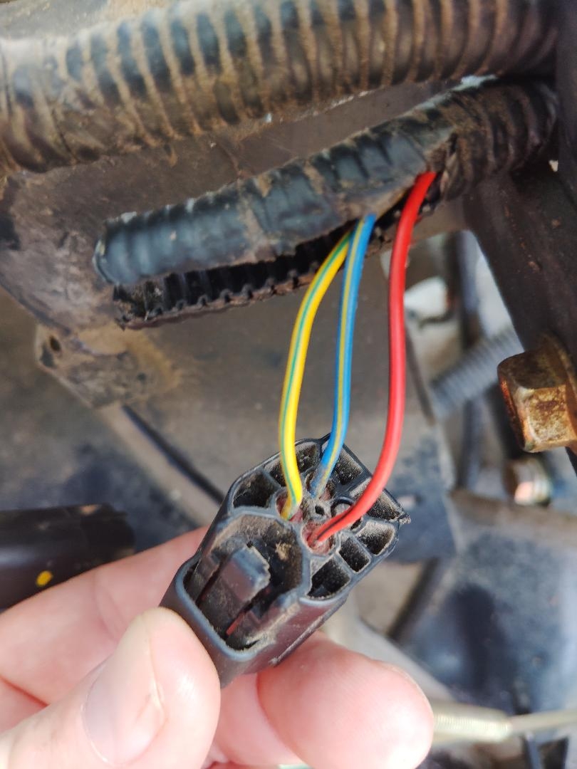

Should have mentioned, I pulled the wires from the harness, the switch was fine. It's the one on the left.
Got something like above for the harness side of the connection?

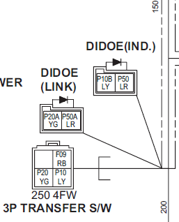

   / PTO Selector Switch #4
Maybe this one? I know it says "3P Transfer S/W" for some reason, but everything indicates that it is the PTO switch. The diodes give it away.
You can see the little tab on top of the connector diagram which should help you orient the one on the tractor to match the wires.
