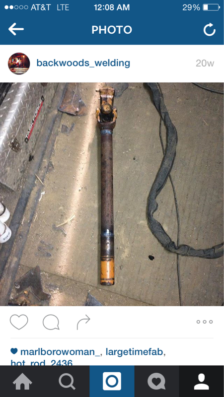

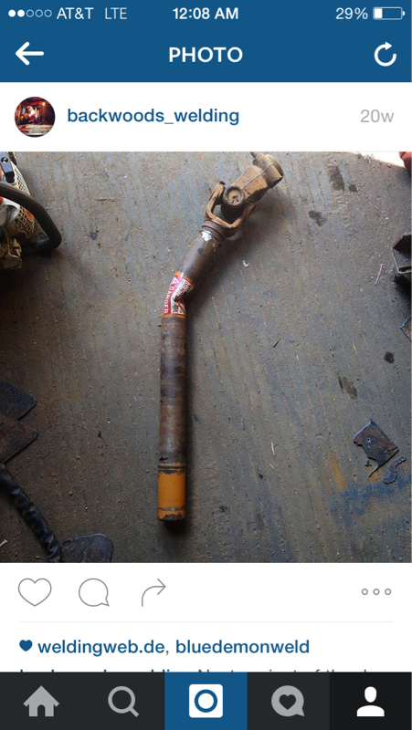

Almost everyone knows the danger of the PTO shaft when it's spinning but here is a repair I did with a valuable safety lesson.
I had a guy call and ask if I could straighten his PTO shaft off his rotary cutter. I told him I would look at it. When I saw it I ask him how it happened. He didn't get it latched all the way on the shaft and while it was spinning at 540 rpm it came off and flew 50 feet in front of the tractor! It actually stuck 6 inches into the ground. Luckily for him I had an old shaft laying around that I cut and welded a new piece in but just remember, take an extra second to double check your hook up!

Here is the after, for some reason I can't post more than one pic at a time on the app.
