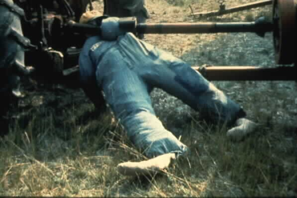

From the Canadian web site, this young 16yo was killed getting wrapped up in a PTO.

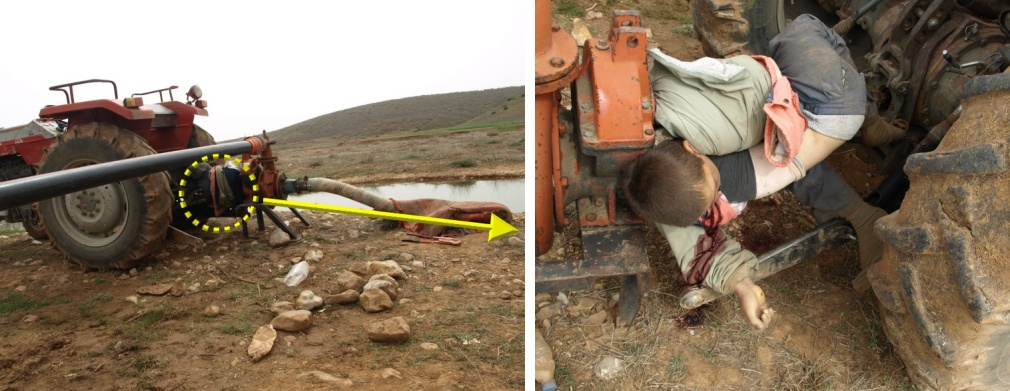

In Italy, an adult farm worker killed.
