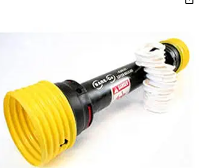

In my area most farmers don't use them saying "i don't have anything to do close to the PTO while it spinning" or "if my ass is not in the sit, the PTO is not engaged".
What says you, the ppl i trust?
PS:
The item in question is this

What do you mean by shield? The cover that goes over the male PTO stub on the tractor or the shield on the PTO shaft between the tractor and implement?
Is cover on the stub no not in use
Shield on the shafts yes.

I'm guessing the shield over the male pto output on the tractor.
Mine flip up when you're attaching the PTO shaft but they never stay up.
I've had my fingers banged by them several times.
I remove them. I reinstall them when I sell or trade in a tractor just for liability issues.
