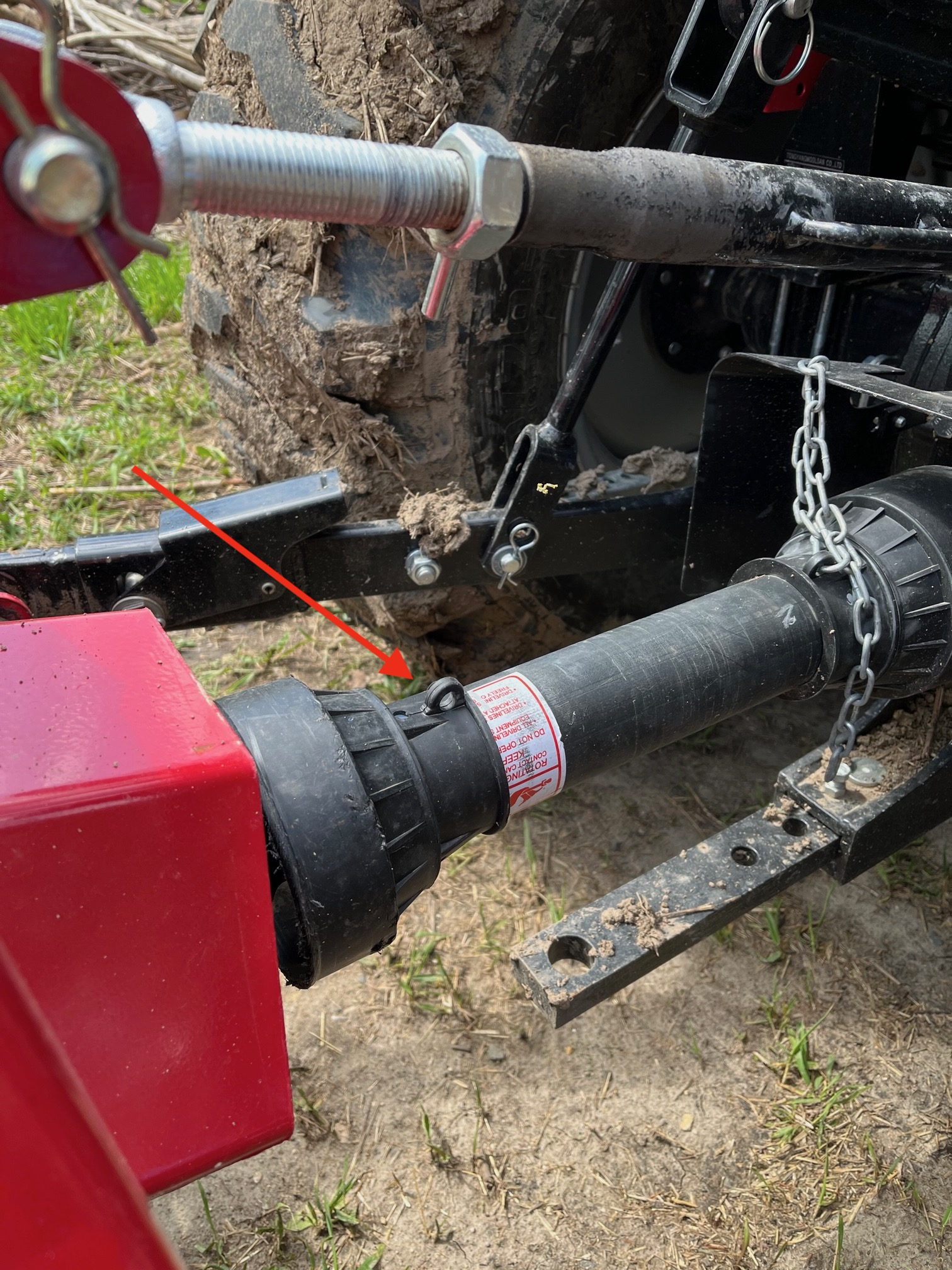

I've been busy with PTO tiller attached. I had two safety chained hooked up and heard a clank during using and found one of my chain laying in the dirt -- the clip was bent. There must have been quite a bit of force to break that clip. Should I be concerned or just get a new clip and hook it back up? thank you

Those chains keep the shield from turning allowing the driveshaft to turn inside it , Those do need to be lubed . They actually have plastic like grease zirks on each end , I would just hook it back up .

yep, the shield is supposed to be stationary with the shaft turning inside it.
Many times the chains never get hooked up though.
   / PTO Safety Chain Clip Ripped Off #7
Lube the PTO shield. You might even have to take the shield off the PTO - clean up both shield and PTO shaft - lube the shield - reassemble.

I broke both of the plastic clip points on my Woods BrushBull so the PTO shield turned freely. I ended up putting a hose clamp around the shield with the chain clip threaded through it. it works just as it's supposed to now.
