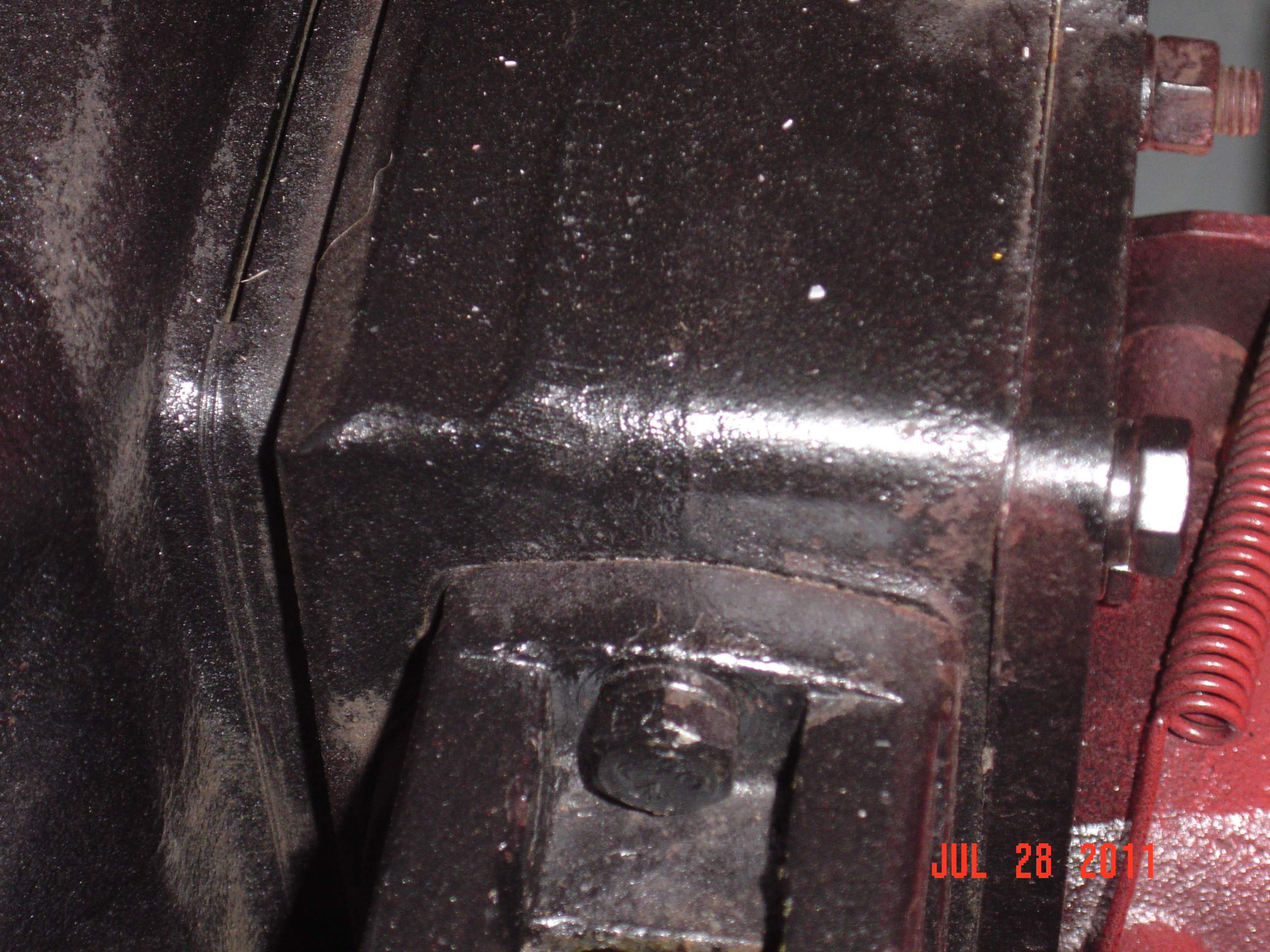

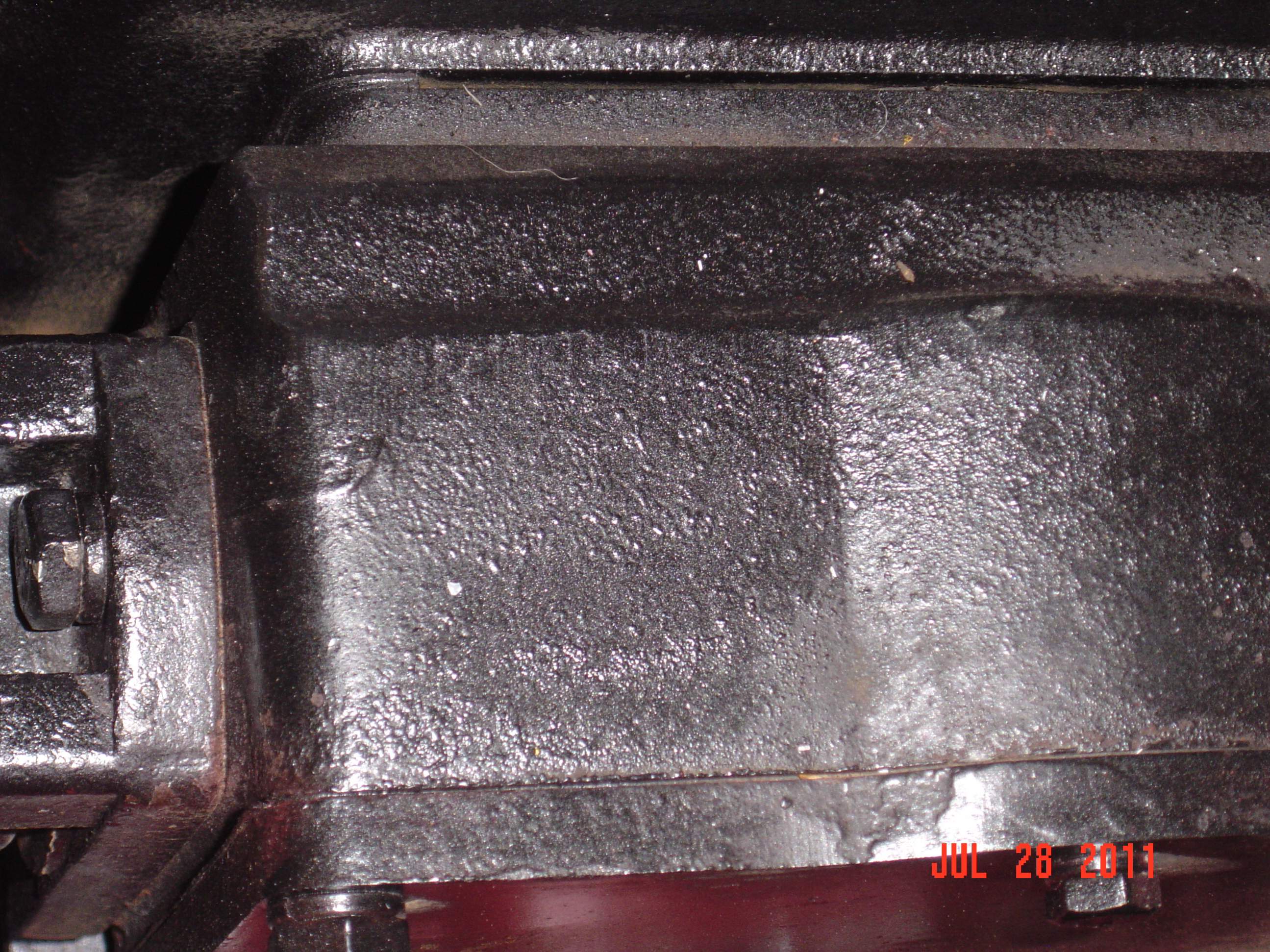

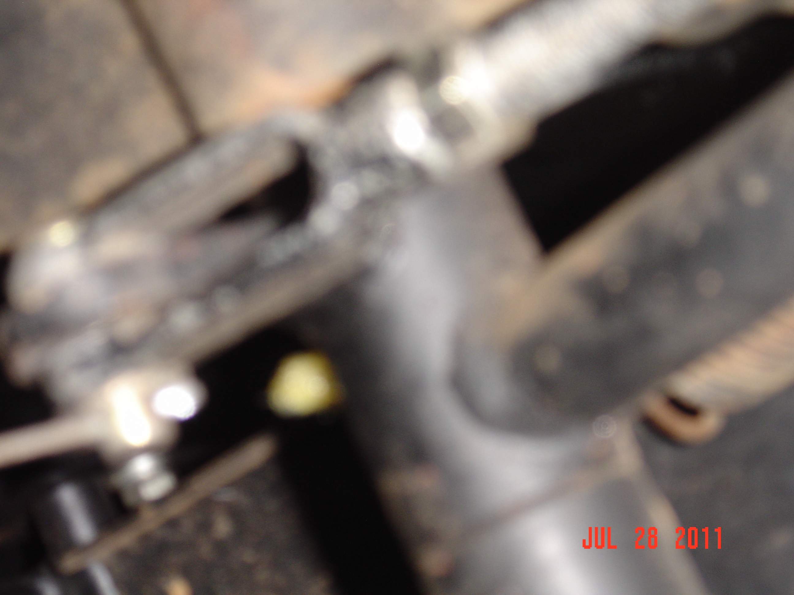

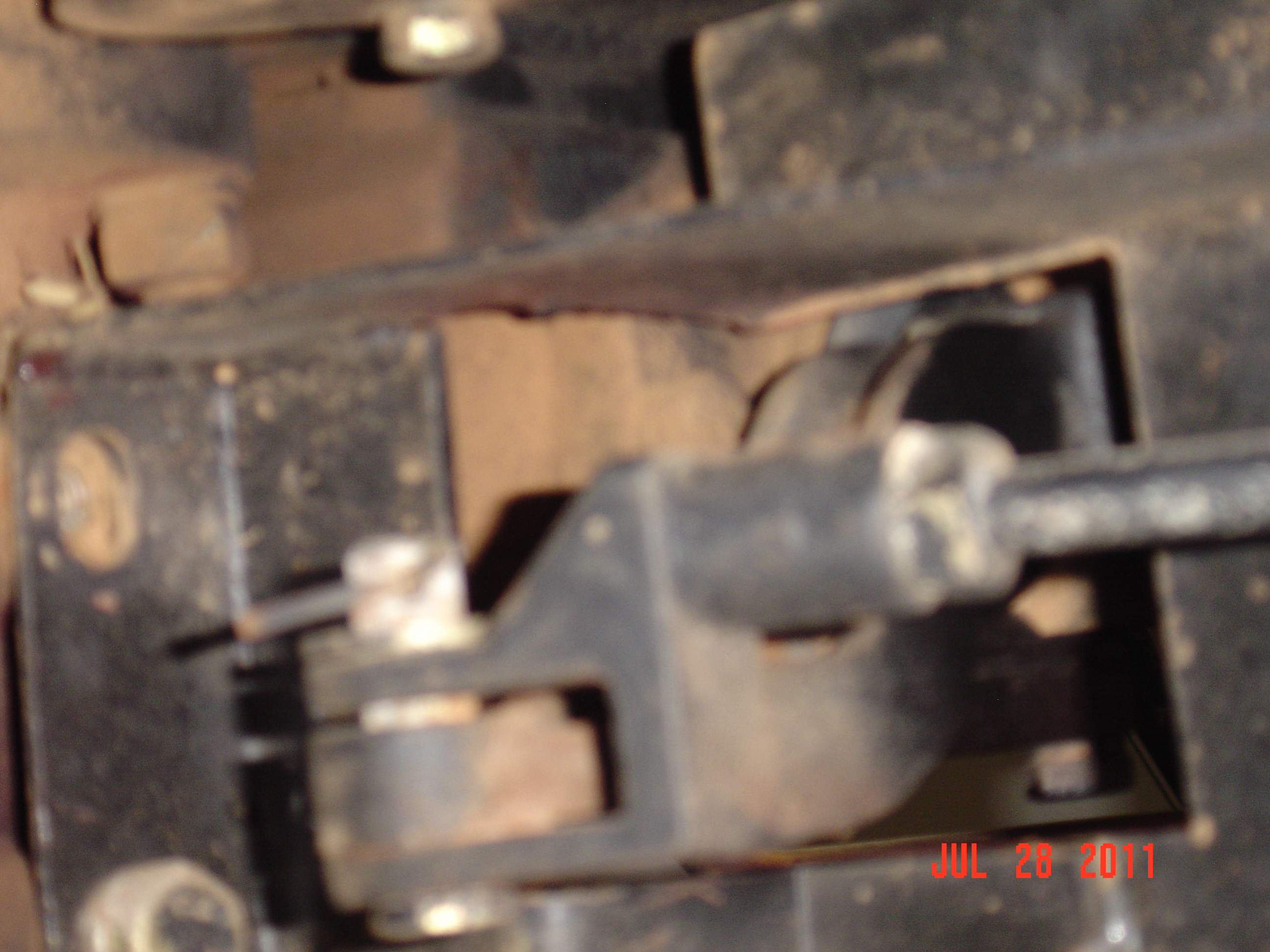

Mentioned this problem with another query. Lost track of it. Have a Task Master 425A, (Dong Feng DF254 I believe) with a Jinma Y385 engine. FEL & rear blade. Just purchased used and everything functions, no leaks. The PTO runs constantly when the engine is running. Manual shows two stage clutch, when engine off and clutch depressed the PTO shaft will not turn freely by hand. Speed selector 540/1000 seems to have a neutral position and I have tried all three with no apparent speed change in shaft turning. It does seem to be changing position internally. I have only tried changing position when engine is off, a little scared to try with engine running but believe that to be my next step. Clutch housing has only a small 3x5 inspection port although there might be a larger adjustment opening that is covered by the FEL mounting. It seems to this non mechanic that the second stage clutch is stuck, would that be possible. The shaft that the cluth pivots on also has another lever mechanism on it that is not pinned to the clutch being depressed, another words when the clutch is depressed the cluth mechanism moves as it should but this other setup does not. It in turn goes to a component (cast box) mounted on the left side of the 3pt. Non of this seems to move at any time and I find no reference to it in the manuals. Will attach pics of this other item. Other solutions? All suggestions welcome. Help please and thanks in advance.

I am for sure a novice in Chinny tractors. Thanks for the input. At no time and in no configuration will the PTO stub turn by hand with engine shut off. In what appears as neutral, low or high RPM. Clutch in, clutch out. Today I tried moving the speed (540-1000) selector while the tractor was running, with the clutch in, then the clutch out. No clashing of gears, no noise, and no change in PTO. Yet the PTO will not turn by hand, even with a pipe wrench when in neutral and clutch depressed. Do not have a PTO implement to try out the system. Main concern was if it's in some locked position it would create a h-ll of a drag when engine starting would it not.
ANYONE have an idea as to what the component was I asked about? Pics were not good, tough place to get a camera.
