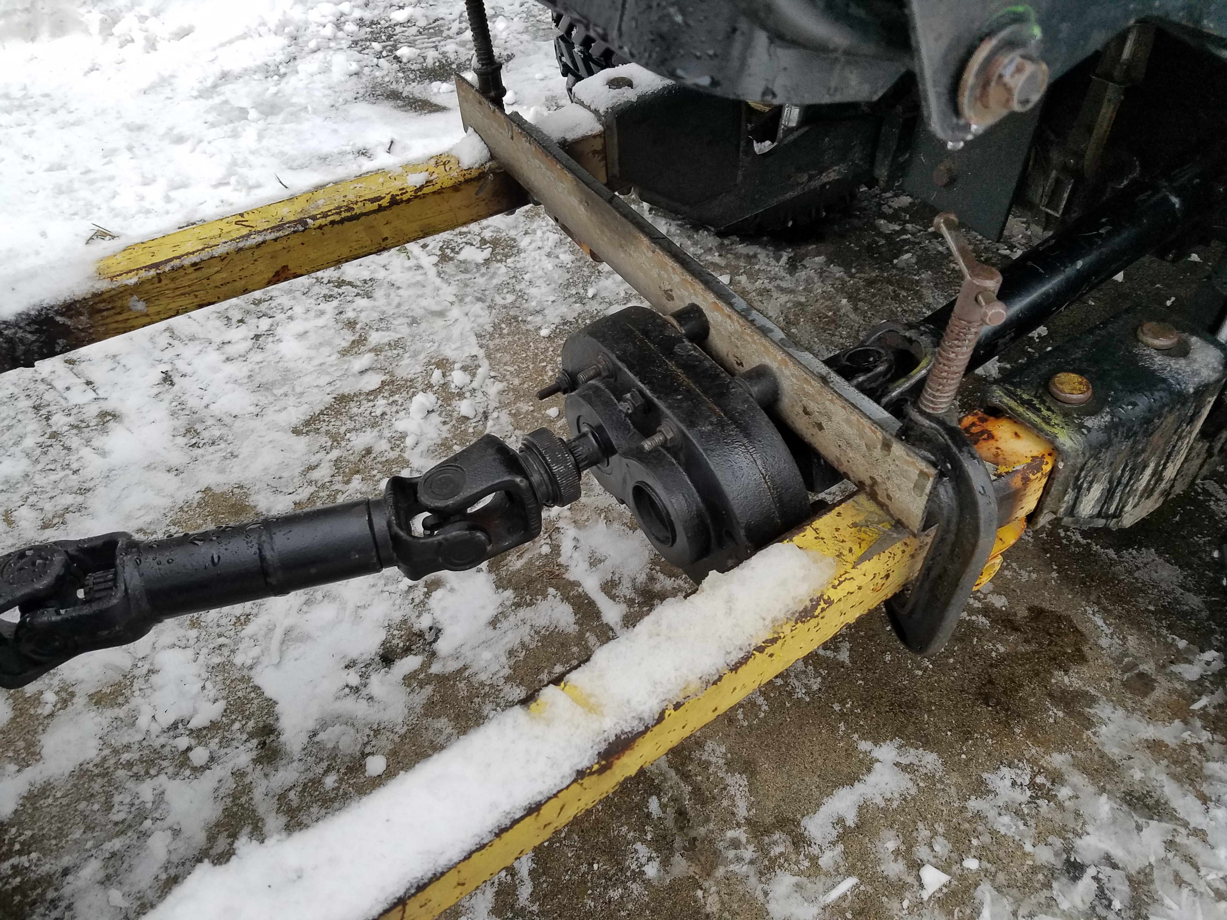

I need to reverse the direction of my pto on my kubota bx1860. I have searched this site and the web and can't seem to find anything. Anyone know where I can find such an adapter. Seems pretty simple. Otherwise I will take my free snowblower apart and try to fix that end of it. Thanks!

If you put the snow blower behind the tractor, and look at the PTO shaft, it is turning clockwise, now, take a shaft and connect the two, and if you turn the shaft at the tractor PTO end, it is turning clockwise, and at the snow blower, the shaft is turning counter clockwise, because the snow blower is facing the PTO shaft. That is the way it is supposed to work. .
   / PTO reverse adapter? #5
Hub City, who is no longer making these, made PTO adapters for changing direction and speed if necessary. They can be found on Epay from time to time. They are common on some antique tractors like the Farmall Cub.

I Just happened to notice this thread and for Ideas, here's a photo of the one I used on Max. It was a commercially built unit that I found in Canada several years ago. It can be front mounted as this one is, or rear mounted. I front mounted it so I didn't have to remove it to run the bush hog on the back in summer. The pto sprocket just runs on the backside of the chain so it drives the shaft to the blower in the opposite direction. As you can see, it's pretty simple unit and shouldn't be hard to fabricate. Here is the link If you want to see the whole thing.
http://www.tractorbynet.com/forums/build-yourself/187397-max-snow-beast-finished.html?highlight=
