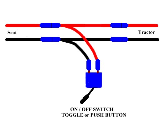

To those of you who are more experienced with the newer safety features, on my 1528 when I engage the PTO with the trans range and gear in neutral and I want to get off to run a chipper the engine wants to quit. Is there a sequence that I must do to maintain the PTO running while I feed brush into the chipper as it does not magically jump off the pile and into the chipper by itself? Thanks in advance! Firejake

Uhhh, I think you'll need to jumper your safety switch under the seat. One of those things where you don't really want to tell someone to overide a safety item yet in reality there are a few attachments that you need to run when you are off the seat...

firejake,
I installed a bypass switch. just a single throw toggle switch splice it into the 2 wires on the seat safety switch. I placed mine behind the seat and use it with my BH. My Bh has a PTO pump and the safety needs bypassed.

I don't know about the 1500s, but I had to put a push on and off switch under the edge of the seat. That way I can turn the safety feature back on when I am done driving a post.

Thanks Guys! I thought I may have to fiddle with the switch. A toggle switch sounds good as I can reactivate the safety feature while riding around. Should the switch be spliced to the switch side of the wires or seat side? (I figure the switch side.)

   / PTO question on 1528 #7
This is how I did mine. The plug in connectors that I used are compatible with the factory connectors. That way, if I ever want to remove the switch, It will not even look like anything else was ever there.

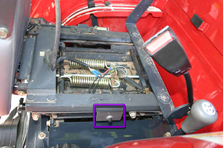

   / PTO question on 1528 #9
Hi Scott,
I didn't think that I had a picture of my switch, but I did. Here it is.
Thanks Jerry! Looks like a good set up will have to try it.
