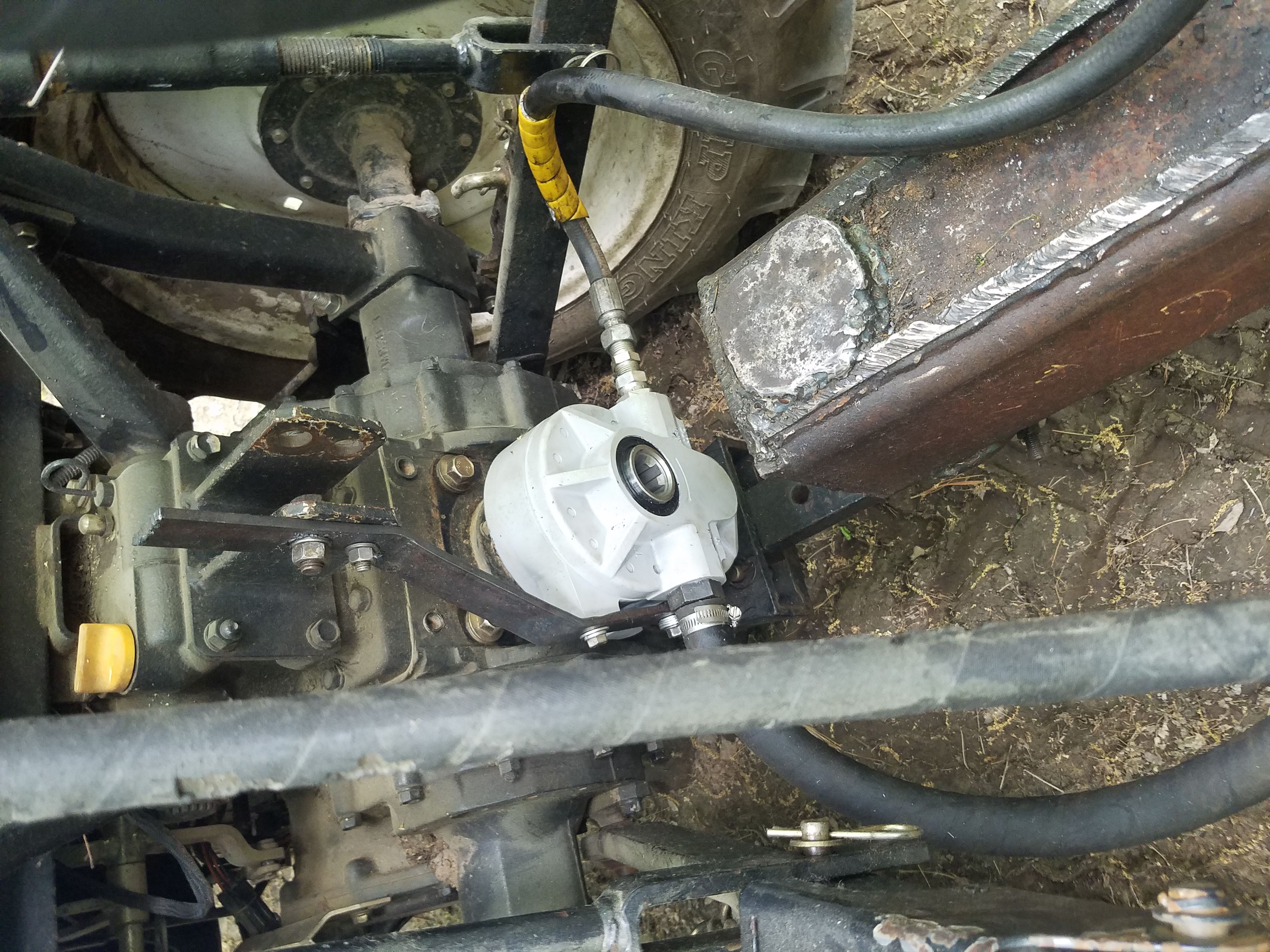

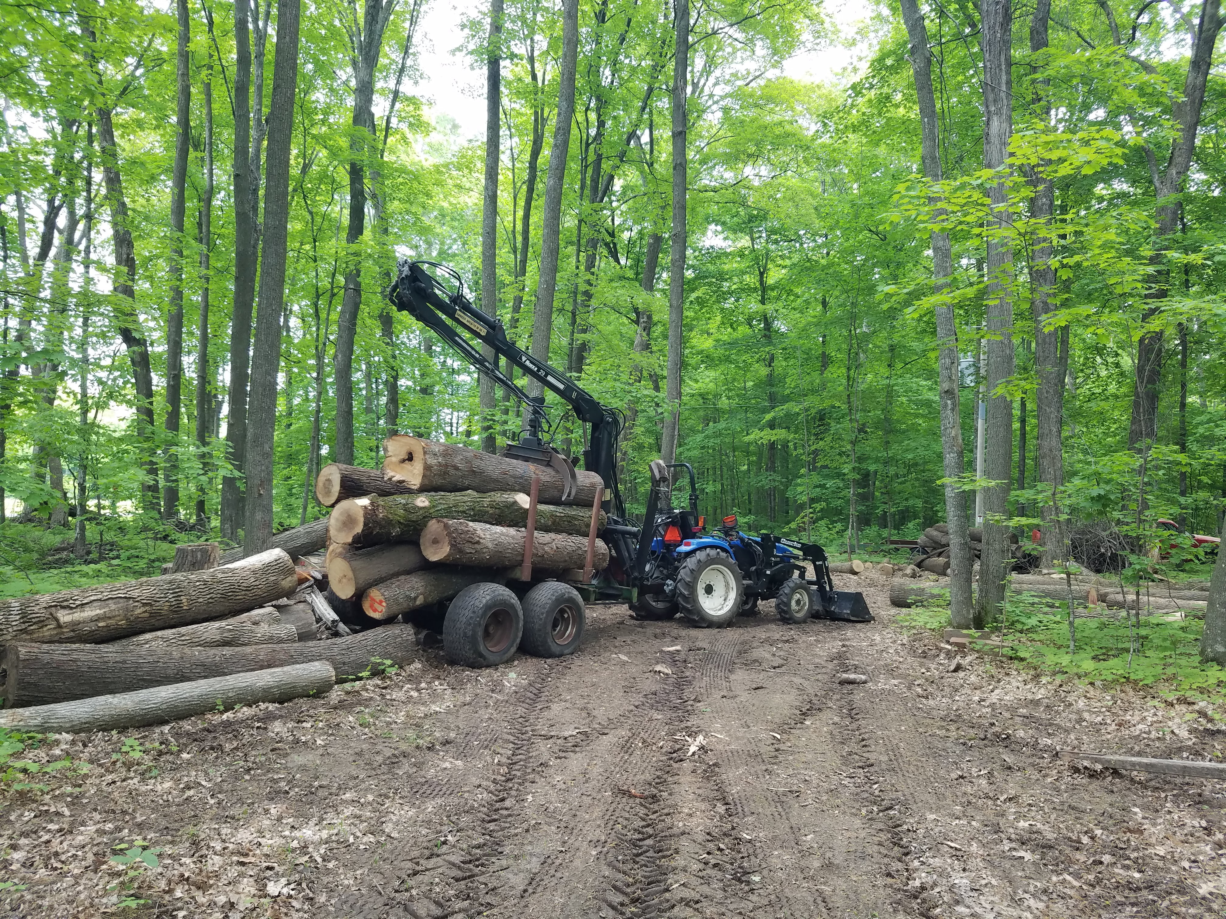

Thought I would post some picture of my log loader . I put the 7.5 gpm pump on and it seemed to clear up the problems . The little TC33 seems to pull it just fine , I have not had to add anything to the bucket for weight . Should be a great tool to add to my horse logging business..
Thank you everyone for the help, great site with some good guy on it ..
