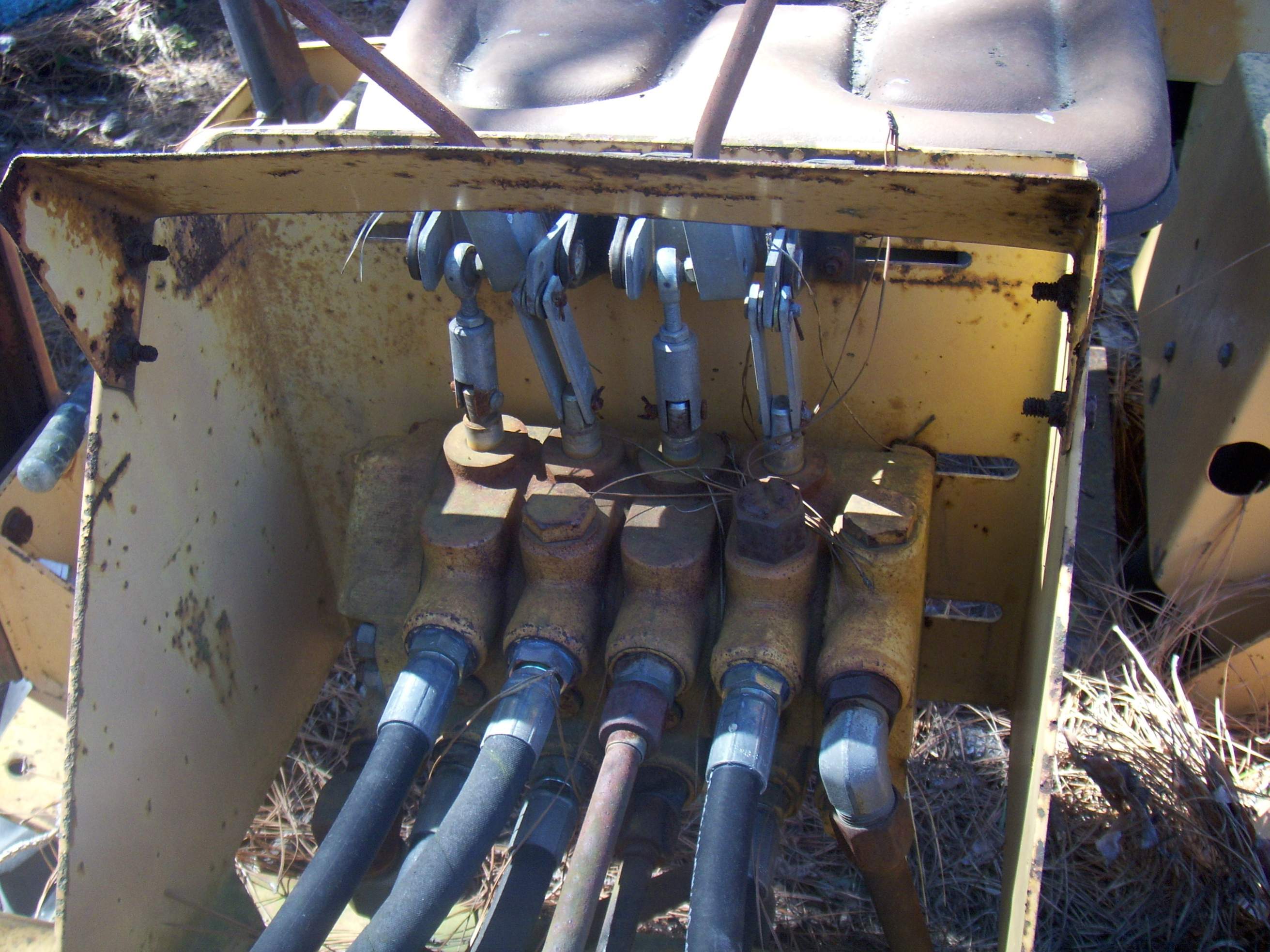

Can you show a picture of the valve, especially the input side. It should be in that area.
   / PTO Pump plumbing #8
Here is a picture of the joystick on my Case trencher BH. the relief valve is on the right in the input housing.

Some more data to add on to the situation. Since the PTO pump is only 2000 psi, the BH relief valve is probably set to maybe 2500 up to 3000 psi. If it is adjustable, you can adjust it down as the pump will probably never get that high.
Also since the pump is 7.2 GPM, you should get a larger tank, if the one you have figures out to 4 gal. Should be 1 to 2 times the pump GPM.
   / PTO Pump plumbing
Thanks the PRV is on the input to th valve. The tank held 5 gallons. Can larger tanks be bought? Seems like a lot of weight hanging on the back of the tractor. I am going to pick up an old 8N and use it just for the hoe. Thanks again for your help.
