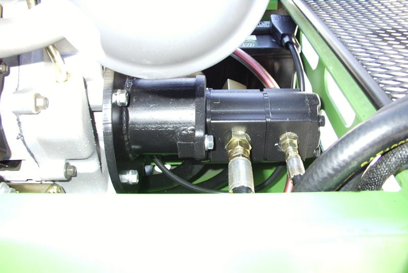

You probably have three pumps, The steering system only needs about 3 to 5 gpm to operate. PTO pump put out about 18 gpm I believe. Do you have two pumps piggy backed on the tram pump. there should be an input hose and an output hose on each pump.
Post a picture of your pump system, left and right side.

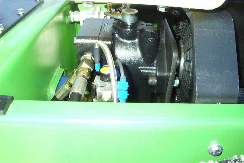

   / PTO Problems #10
On our 2001 model year PT425 there is one pump for travel. That is the variable volume pump. It is located in front of the engine.
http://www.mossroad.com/PT425Pictures/PT425VarVolPump.jpg
Then there is a second pump with two sections piggybacked onto each other. One is the main PTO pump and the second section is the aux pto/lift/steering pump. It is located on the rear of the engine.
http://www.mossroad.com/PT425Pictures/PT425PTOPump.jpg
On the newer model years, all three pumps are piggybacked together on the front of the engine, which moves the engine more towards the rear of the tractor.
There are several variations of the pump layouts from year to year. And, of course, the larger model tractors are different as well.:)
