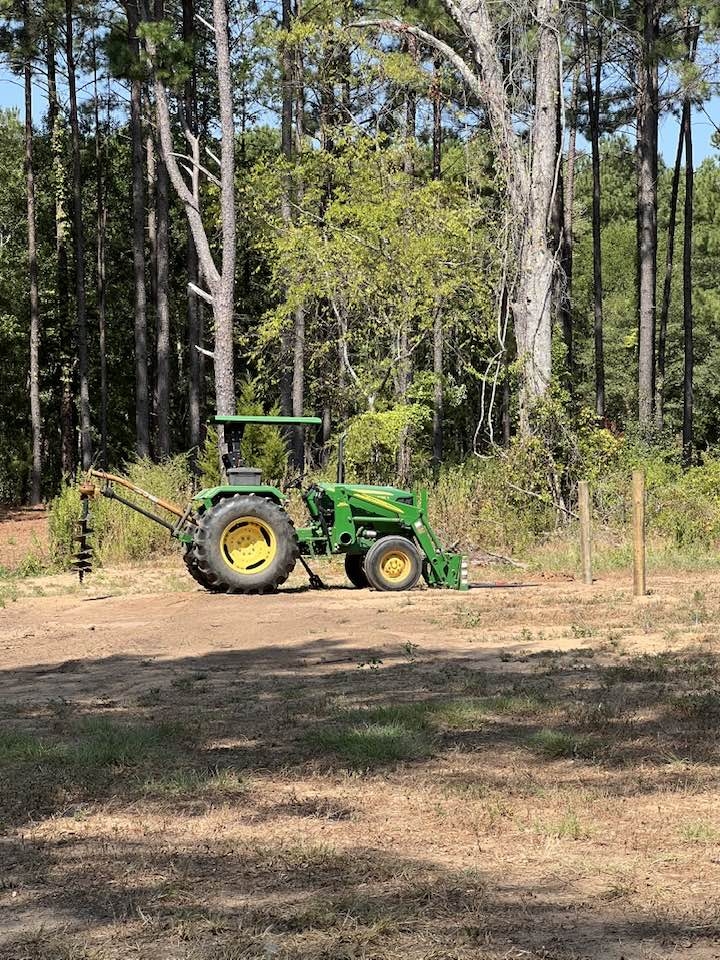

My County Line post hole digger wants to screw itself into the ground . I am letting the lift down a small amount at a time but when it starts screwing in it will bow the 3" pipe to the point that I am afraid it is going to bend. I am running the tractor at low idle speed. Wondering if a higher RPM would help this. Or other suggestions that might help this thing to dig and not screw in.

My County Line Auger is the third brand that I bought. The first two brands barely dug. The Country Line is super aggressive, and it digs so fast that it will bury itself. I've done it more times then I can count.
Fortunately for me, I have a backhoe that I can use to pull the auger out of the ground. Sometimes it comes up easy, sometimes it creates a crater!!!
Trying to take small bits, and go slow doesn't work. Once it digs in, nothing will stop it from burying itself.

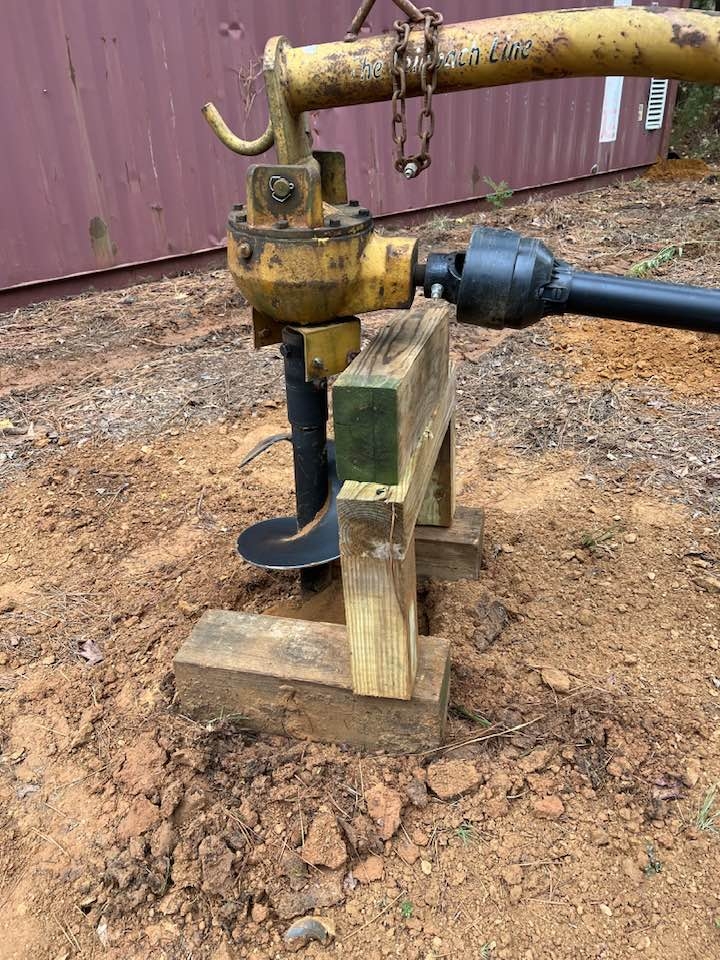

My solution was to put wood blocks under it. I created a bench kind of thing that sits about a foot off of the ground. When I feel the auger dig in, I stop everything and put the wood under the gear box. It straddles the hole, and stops the gear box from going any deeper. Once the gear box hits the wood, I rev up the RPM's, and the auger breaks free.
That was with my 37HP tractor. I now have the auger on a 65HP tractor, and I've never buried the auger. It's tried to bury itself, but having more HP has allowed me to spin it free and pull it out.

Those blocks are a clever solution!
For the op, another thing to try is adjusting your 3 point drop speed slower, so that it doesn't get augered in so fast.
