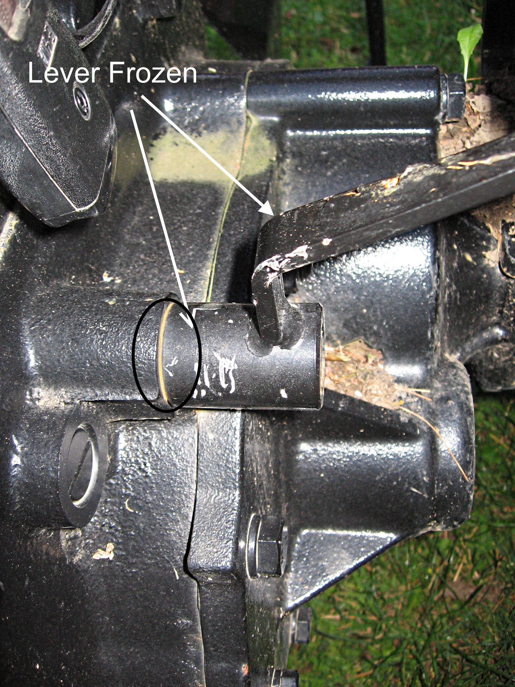

Farmtrac 270DTC

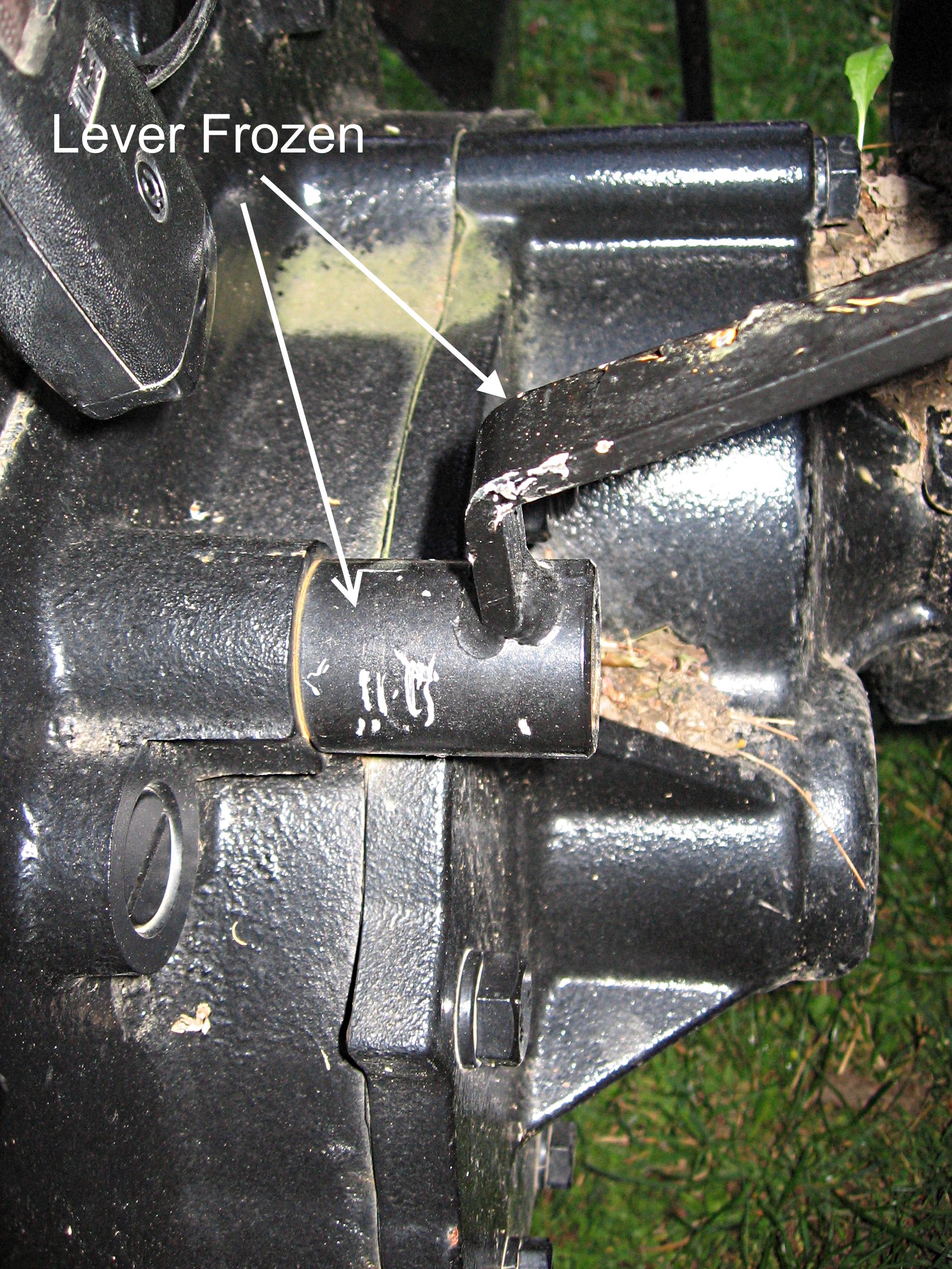

Farmtrac 27HP tractor (same as Montana 2740) with dry, dual stage clutch. This 3-year-old unit is closing in on 200 hours of flawless service. I made my final payment on it earlier this month.
I had a new Bush Hog 5' Razorback Rotary Cutter delivered yesterday morning and after using it for about 30 minutes in the field my PTO lever froze in the disengaged position. The PTO engaged smooth as silk for the first 2 years allowing us to drill almost 100 holes for pole barn and fencing using a PHD. The PTO had not been used since late last year. When I engaged it a few weeks ago for the first time this year I noticed it took a great deal of force before engaging. Then yesterday after engaging successfully (but with some difficulty) 3 or 4 times I disengaged to make an adjustment to the cutter and when I returned to the saddle, pushed clutch in ... and (tried to) push lever back ... the darn lever would not budge. Today I adjusted the clutch pedal but the lever remained frozen.

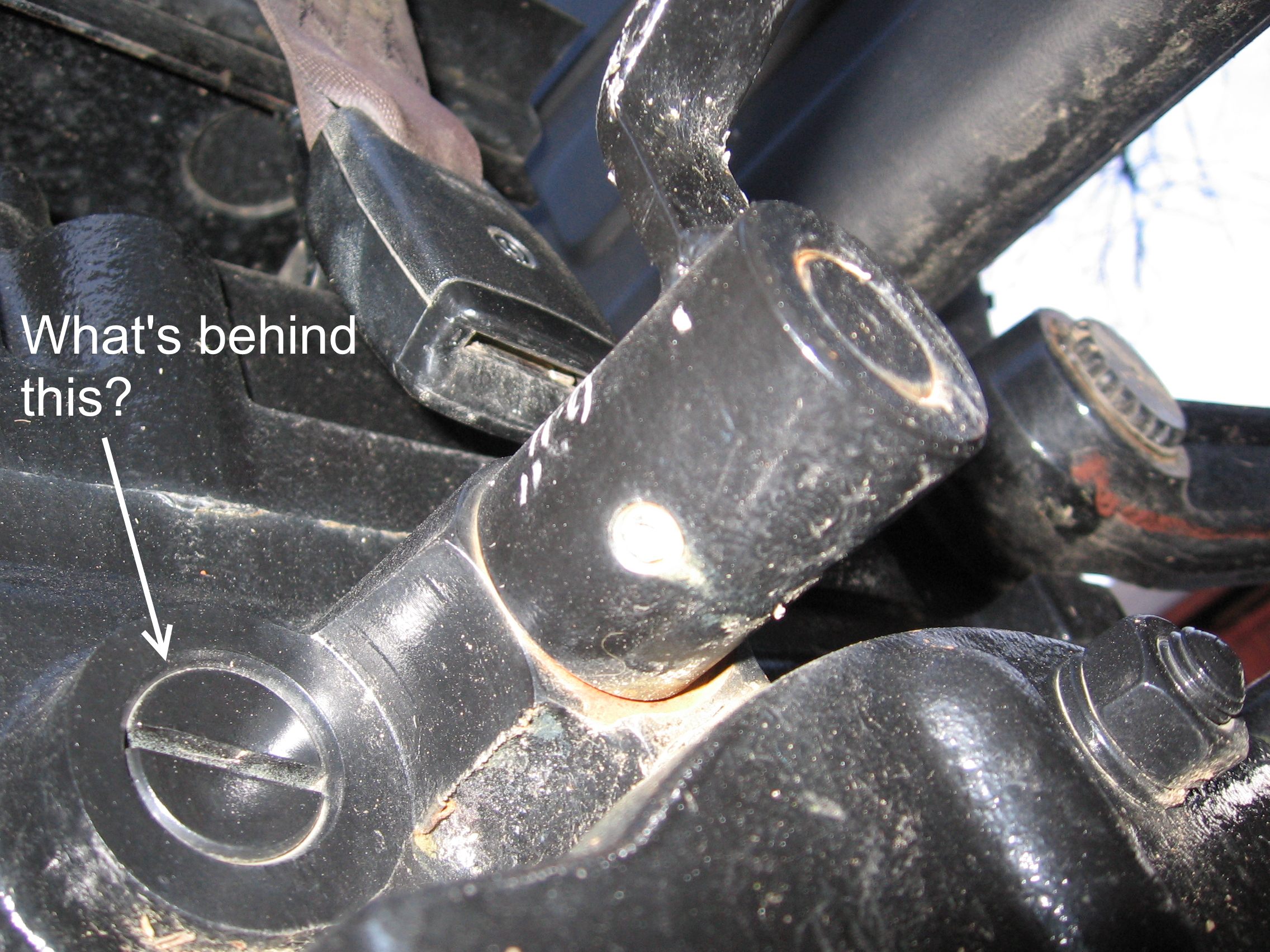

Photos show the now slightly bent (frustrated operator) and scratched (frustrated vice grip) lever that is connected to a rod that extends out from its housing. Next to this assembly is some type of screw off window that I would guess has something to do with the PTO linkage. Please fire away with recommended solutions to my dilemma.
Finally, many know the deal with Farmtrac. I am in desperate need of a service manual for this unit and am willing to pay reasonably for one.
Meanwhile, my shiny new Cutter sits useless in my overgrown pasture.

I don't know the exact inards of your tractor.. but most tractors that have a trans pto.. IE.. dry, single stage lutch for drivetrain and pto, use a sliding collar to couple the shaft.
perhaps there is rust on the male shaft splines or female splines.. perhaps the edges are a little rough. i think i might have someone manually spin the pto shaft or work it rotationally as i tried to slide the pto engagement in.. do this of course with trans in neutral, and engine off. the gears normally have a bevel so will slid ein place.. however.. with a lil more friction.. may not be sliding so easilly.
try it and post back.
soundguy
/ PTO lever frozen #3
maybe try some penetrating lube from the outside and see if that helps.
i assume you checked the hydraulic oil level in the reservoir to make sure it was topped off. looks like that is the upper most lever on the case and if oil isn't slinging up there internally it might dry out.
amp
/ PTO lever frozen
Well you both were correct. Soundguy pretty much described what the set up looks like on the inside. Ampsucker nailed the problem that was (fortunately) external. I soaked the circled area in penetrating oil, gave her a few taps, soaked it again, and finally the lever gave way. The whole time I was out there spraying and tapping I admittedly was convinced that it would be to no avail and I was looking at hundreds of dollars in repairs, if parts could even be had.
Rusty stuck parts is the price I pay for not having a nice barn to store the tractor in during inclement weather.
Now I'm heading out before it gets dark are hook up the new Razorback and do me some cutting. Thanks to you guys!
