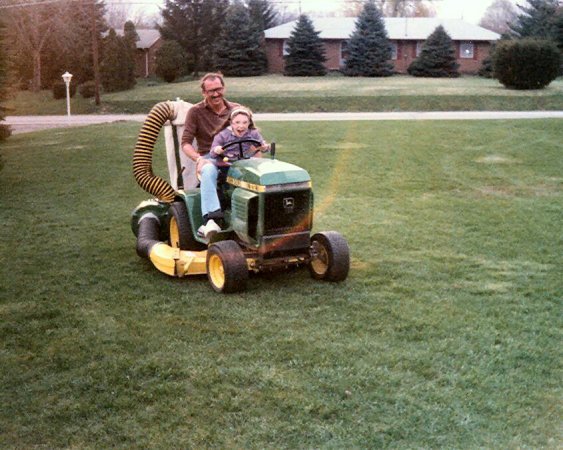

Years ago when I lived in the city and my kids were young I had a John Deere with the attached rig. It did a good job of picking up both grass and leaves and deposited them into a zippered canvas bag on the back of the tractor. This was store bought, not home made, and it was powered by an independent gas engine. It wasn't cheap as I recall.
This type of rig could be adapted to most any tractor.
