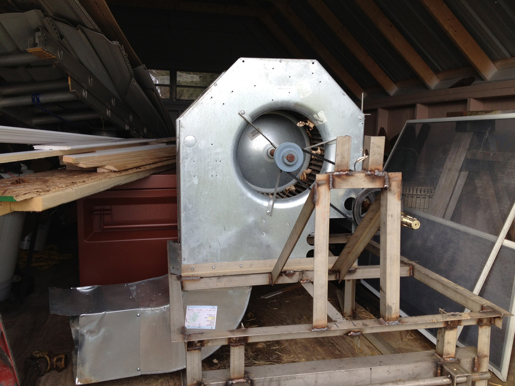

I put one together in time for "leaf season". It is a squirrel cage blower from a 10 ton A/C unit our guys removed on a project. I wanted to get it painted before shooting pics, and before that happened I turned my interest towards another project. I do have a couple short cell phone videos shot from the seat of my old Ford. You can see the leaves moving but the blower isn't in the picture.
Figuring the optimum speed is the speed it was designed to operate at, I calculated pulley sizes based on the electric motor's speed and the 540 pto. It blows right around 4,000CFM at 540 RPM on the PTO (checked with an instrument at the shop).
I had a bud in the sheet metal shop make a sweeping reducing transition to get to 8"x8" at the outlet. Afer tinkering with different designs for nozzles it worked out the raw 8"x8" end works best. Trying to reduce the nozzles more than that tended to decrease the CFM's.
/ PTO leaf blower #16
Here's a picture I snapped this afternoon of the blower in a shed. The shaft for the PTO is carried by two pillow blocks on the far side:
