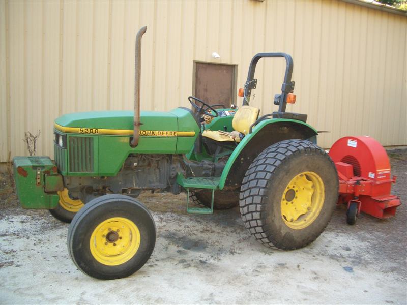

Have you thought about adding gauge tires rather than skids to your blower?

jgbanshee - I like the guage wheel idea! I think I'll try that.
