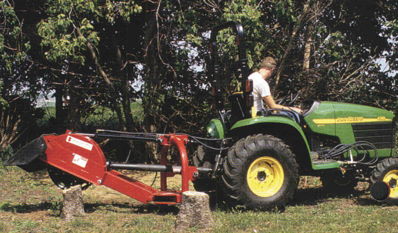

You might could if you scrounged up all the parts.
However, you can find a PTO stump cutter for about $2500 or less, or purchase a used one and replace the teeth. Should work like new.
