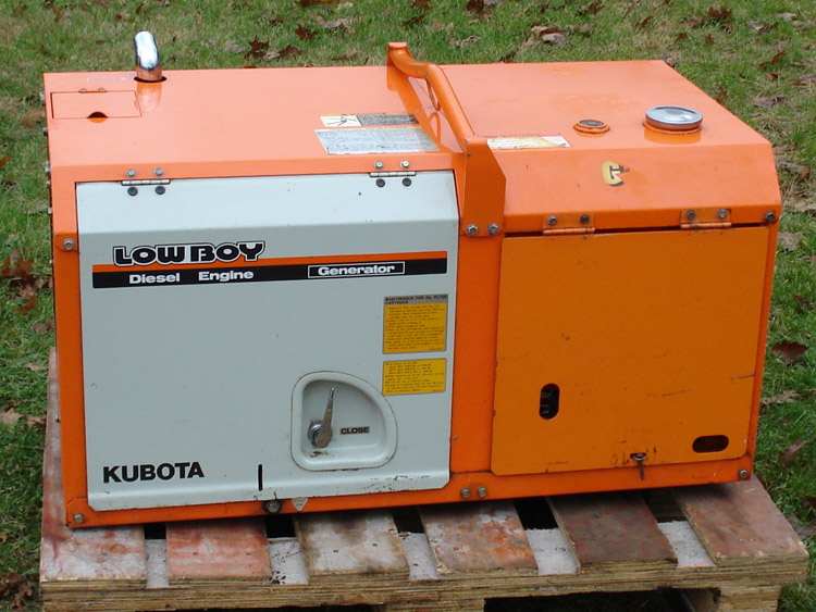

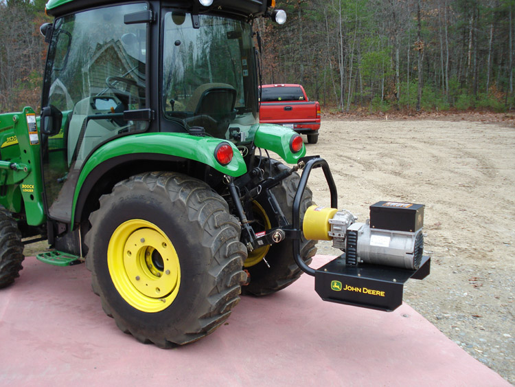

Similar thing happened to me last fall....was in a bind and picked up this Deere unit.
Used it for 4 hours and then I returned it back to the dealer. Nothing wrong with the unit, worked GREAT, but I just couldnt see the point of letting my poor baby (aka 3520 :laughing:) sit there turning WOT for hours on end...
Ended up getting this Kubota GL6500 GenSet...MUCH better Solution. Less power (PTO unit in Pic is a 10k, This Kubota is a 6.5k), but its way quieter and more fuel efficient....actually BETTER power output as well, on the PTO Generator I could see some "wobble" in the intentisty of the Incandescent light bulbs, with this Kubota, everything is as if I'm still on the grid.
IMO...I'd stay away from a PTO Generator for extended use type applications...now if you wanted to run a welder or so out in the brush to fix a fence, I'd probably say PTO is the way to go.
