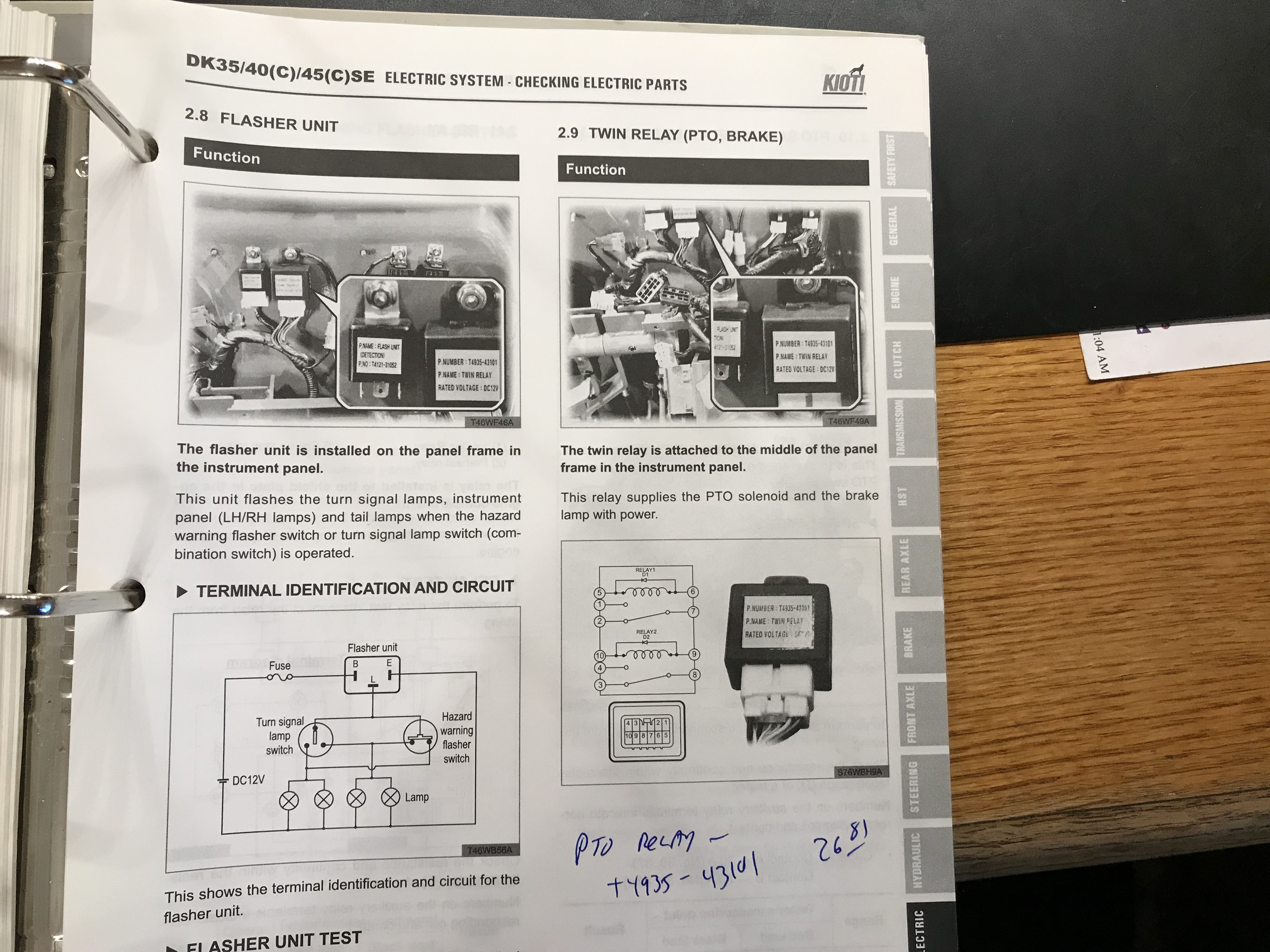

i had the same issue, it was the pto relay. i replaced it a few years ago, issue has not reappeared
   / PTO doesn't come on when switch first engages
#9
OH man I sure hope its that easy... I have three relays on the back wall. I have replaced the far right one when it wouldn't start 4-5 years ago. So that leaves the middle one and the left one. Your diagram shows I think 4 relays. I may replace the other two just because... As if the two went out the third can't be too far behind it when it fails.
If you don't mind where did you get the book? I would love to buy a copy.
   / PTO doesn't come on when switch first engages #10
These are not in the engine compartment, there under the steering wheel cover section.
I purchased this from my dealer when i purchased my tractor.
