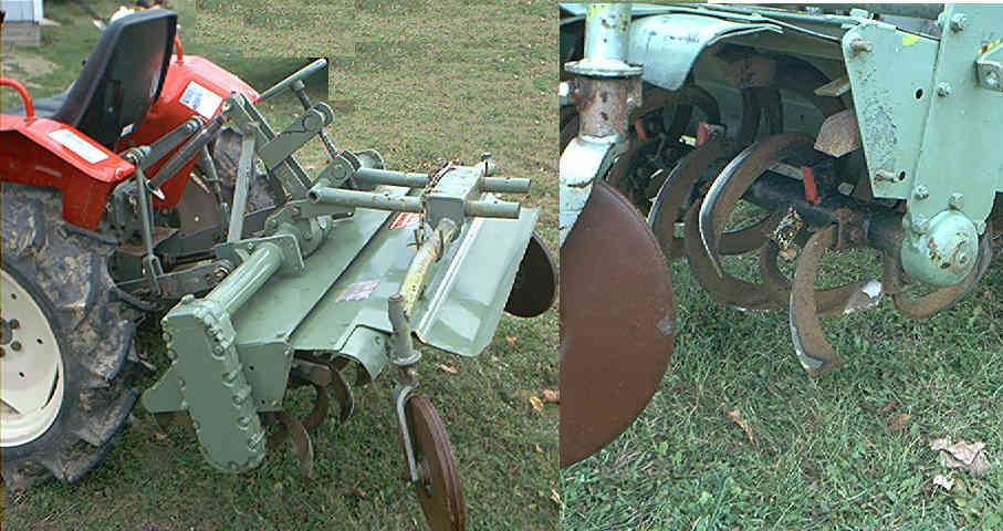

Here's a picture of it. I want to hang it on my 1220. It's an Ebay auction but the guy is local so I emailed and asked if I could come take a look at it.
I hadn't thought of the three point not being compatible, if he gives me an address I'll go look and see if the geometry is similar to my rotary cutter.

   / PTO direction #5
Curt,
He is using the typical 3PT hook-up on the Yanmar that every tractor uses. The top link for a Yanmar tiller is completely different than the standard one pictured.
If he is using it like that, chances are you will have no problem at all. Oh yeah.......I use a Yanmar tiller behind my TC18 with a standard top link and have no problems.
