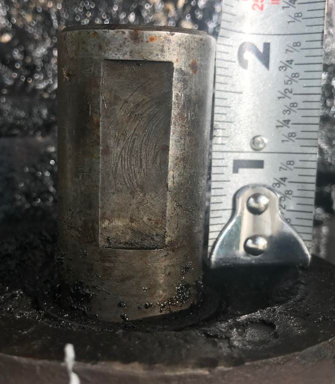

I do not have a lot of experience with various PTO shafts, but I received an old log splitter with the PTO shaft shown below. I have a JD 4115 that I would like to run it off of, but don't know where to start or find a PTO shaft. Any help would be appreciated.

A shop that deals with agricultural drive lines can help you out. I needed a new drive line for my mowing deck. I purchased a standard PTO drive line and a local driveline company swapped out the end it came with for one that would fit my mower. I don't know where you are. Here we use a company called Six States Distributors.
   / PTO Connection unknown #3
There is a lot of different configurations, but my local tractor dealership had the right pto universal joint for my generator.
I replaced the yoke myself as it is very easy...
