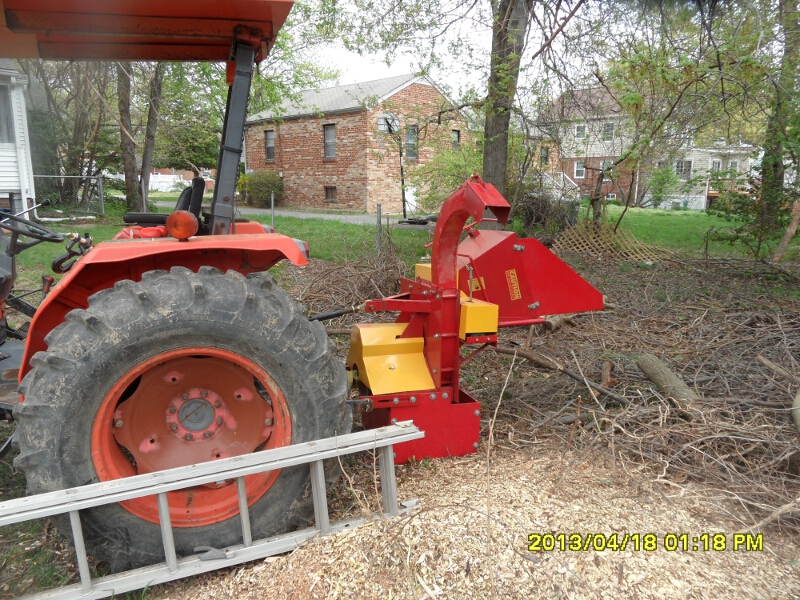

A few comments based on many hours of use with my 8" Jinma and M4700:
You can stuff a log in a self feeder and let it feed while you get the next log. But it doesn't always feed well with a branch with lots of side branches or a bent shape. With those you need to keep pushing it in (without sticking arms in the chute of course). When the branch has a lot of side branches and foliage that fills the chipper opening it will stop feeding. Then you have to pull stuff out of the chipper chute and push the remainder in.
I had lot's of vines and twisted stunted apple limbs with perpendicular side branches. Frequently clogging the chute. I'd keep a 6" diameter sacrificial pusher stick. Very rarely did I have to pull stuff back.
At the other extreme, sometimes it self-feeds too well and bogs the tractor down. The self feeding "feed speed" depends on the material being chipped and the sharpness of the blades.
Very rarely would it bog down because it fed itself too fast.
With all self-feeding chippers the chute is at an angle, so you have to lift logs to get them down the chute. Sometimes I chip 20' long branches or small trees and lifting them up into the chipper chute takes some effort.
<SNIP>
My Jinma is only slightly angled, as soon as I get some stuff in the chipper it eats it up.
attachment.php
I've feed 20 foot saplings in lifting the bottom up to the chute and just walk with the top.
I guess that if I could have spent several thousand $$$ more I could have gotten a nice hydraulic chipper. But I had an immediate use for a big chipper and we might have used it for 60 running hours for the first job. Then I moved it down to Mississippi and have only run it for about 10 to 20 hours since. And anticipate using it for about 10 to 20 hours a year from now on.
I had been waiting for rswyan to finish his thread "Re: YAJCMT: Yet Another Jinma Chipper Modification Thread" :)
But from my viewpoint as a non-commercial user, where time is NOT money a $1500 8" Jinma chipper w/ a good set of belts does all I need compared to a $2,800 Woodmaxx hydraulic or a very expensive Wallenstein.
