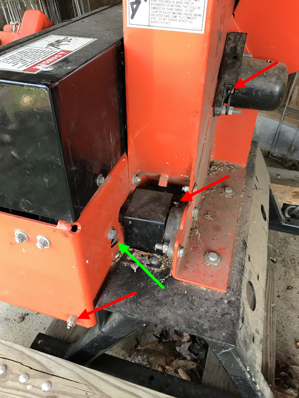

I got some photos this morning.
Here's a view showing the zerks on the rear of the machine:
The two upper red arrows point to the zerks on the rear of the flywheel shaft and the jack shaft. I mis-remembered last night, it's the rear jack shaft bearing that easy, and the front one that's difficult. The green arrow points to the hole you are supposed to use to access the front bearing zerk. The lower red arrow points to my relocated zerk for that bearing.

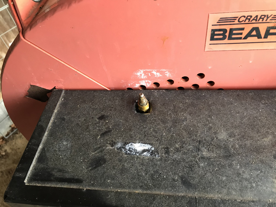

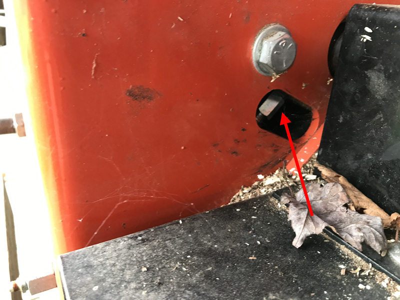

Below is a closeup of the opening you are supposed to use to access the zerk on the front of the jack shaft. It looks pretty big, but there was an angle zerk there, and it was so close to the edge of the opening I couldn't get a grease gun on it. I didn't have any tools that could enlarge it with the zerk in place, and after taking it out I couldn't reach back behind the pulley to get it back in anyway. The shaft had rusted enough that moving the pulley seemed like a challenge I wasn't up to.
You can see here the adapter that replaced that zerk, with the end of the extension hose screwed in to it. I couldn't get a photo of the hose itself without removing the belt guards, but you can see again the zerk at the end of it at the lower right corner of the photo.

Terry, I can't thank you enough for taking the time to do all of this!
What a project that was, but you only had to do it once! I bet the designer of the chipper never had to greese it😂. I'm in the middle of doing my winter clean after wind storms, but will tackle this project next month. Love this chipper, it's a workhorse! Stay safe out there!✌🏻

Hey Terry, I was able to greese the front of the Jack shaft by loosening the zerk one turn and using my Lock & Lube, it was bone dry it took many pumps with the DeWalt cordless to see greese start to come out. I never knew there was a zerk there and I have the manual.
So thanks again bro!✌🏻
