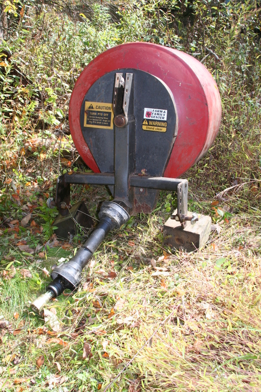

I have a PTO Cement mixer. Got it at Central Tractor 20 years ago for $50, but that's another story. As has been mentioned in various places before the drive shaft length is a real challenge for this application. It is so short you cannot raise it high enough to mix a full load or ( with the same mech conn) lower it far enough to dump. I have managed with 6 80# bags of gravel mix and hoeing it out. When I added Pats connects it moved the mixer 4 inches out. I did not want to buy a new drive shaft so I got a 4 inch extension. It works a little better but the hyd top link is not long enough. It came with a single acting cylinder which may be longer , I have to find it.

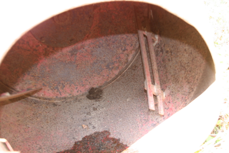

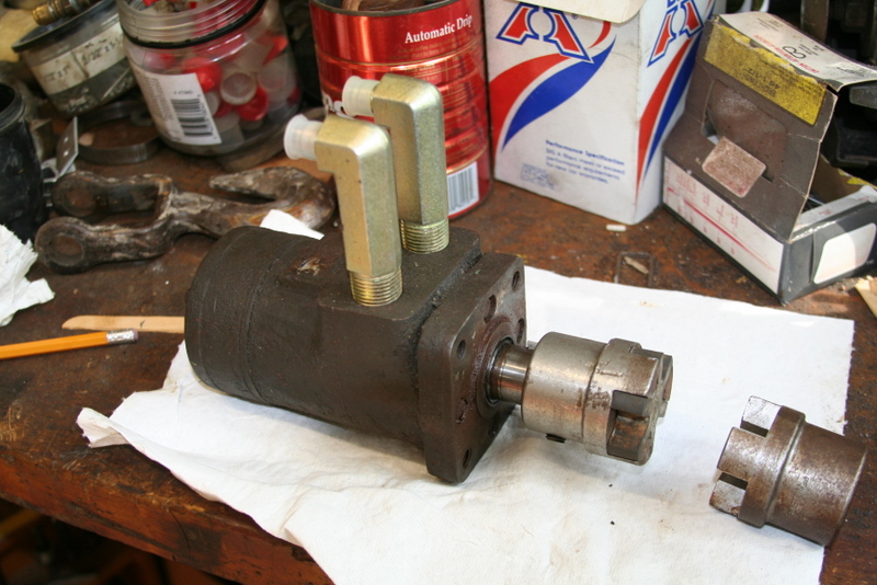

Here are pictures of mixer and a hyd motor I found on my hyd shelf. I have no idea where I got it and the tag is torn off but I matched and measured and it is a Charlyn H around 8ci displacement 1" shaft It turns by hand and had plugs in the ports. should work well if I ever get to it.

If that has 8ci displacement, you are in the right range, Bob.
Your paddles are similar to mine....they will not push the mud out very well,
in my experience. You have to eliminate that gap between them and the
inside of the drum and extend them closer to the opening. Check out the
readi-mix truck drums. I have mixed tons of stucco (glutinous liquid) as
well as concrete with 0" slump and 1.5" aggregate.
I am from the KISS (keep it simple) philosophy. You don't really need or
want that LoveJoy-style coupler. It is unnecessary and it pushes the
motor out from the mixer quite a ways. I considered mounting my motor
right to the input shaft that the PTO driveshaft uses, but my shaft was
something like 1.375" in diameter and I would have to fab up a support for
the motor. Consider mounting your motor right to the mixer frame as I did.
Remember, this is a very low speed and fairly low torque application.
SurplusCenter has a great selection of sprockets and solid couplers.
   / Pto cement mixer
#9
If the coupling is solid and the mixer shaft is in a sleeve bearing and the motor is flange bolted to something then nothing is floating and I think there would be premature wear on one of the bearings. Hopefully the sleeve but probably the bearing in the end of the motor. I think the purpose of the lovejoy joint is to provide flex for slight misalignments. ??????
Never mind I looked at the way you did it. You took out the sleeve bearing for the sprocket shaft. That works.
   / Pto cement mixer #10
Yes, but you are turning very slowly and there is little side load on the
small sprocket. Since it is chain drive, small misalignments can be
tolerated without damage.
I DO use LoveJoys for driving hyd motors at high speed, as with a 3600
RPM engine and direct drive.
Just trying to save you some unnecessary work....
