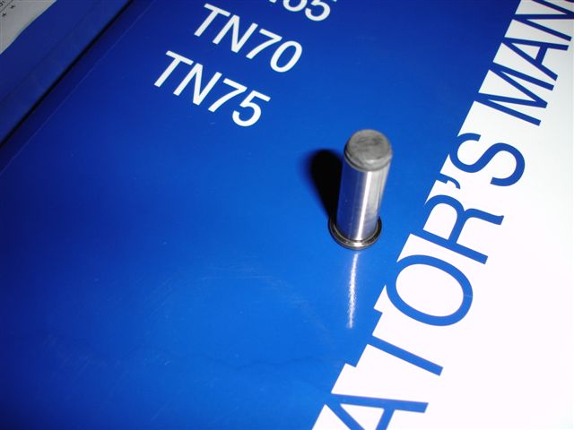

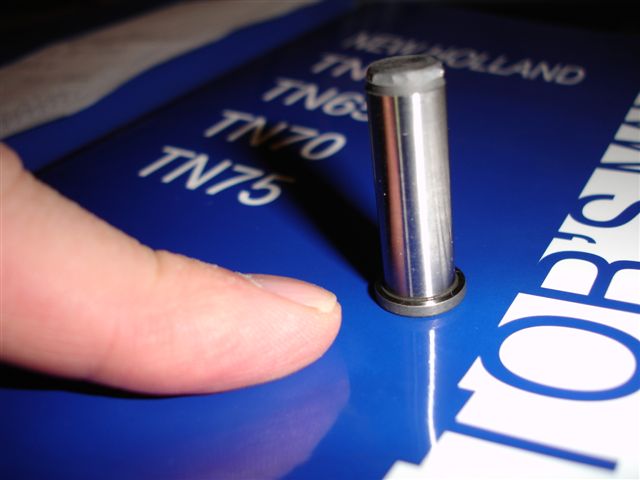

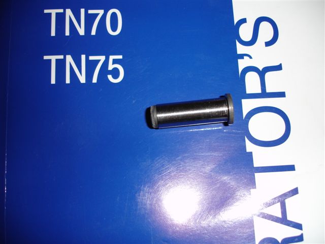

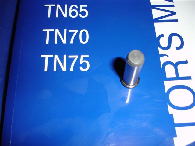

Rick, this "fell" out of the end of my TN70A lower lift as as I was changing the fluid, is it a "finger"?
Bob
   / PTO Brake on TN75 #7
Wow.. that'd worry me a bit... looks like a pin made for a retainer clip/e-clip/circlip.. etc.
soundguy
   / PTO Brake on TN75 #8
soundguy
Yes, worries me a bit as well.
Bob
   / PTO Brake on TN75 #9
Probably from the 3PT internal linkage. Most likely the draft control; as if it were from the position control linkage, you would have lost all or part of your hitch function. Purely speculation, however.
