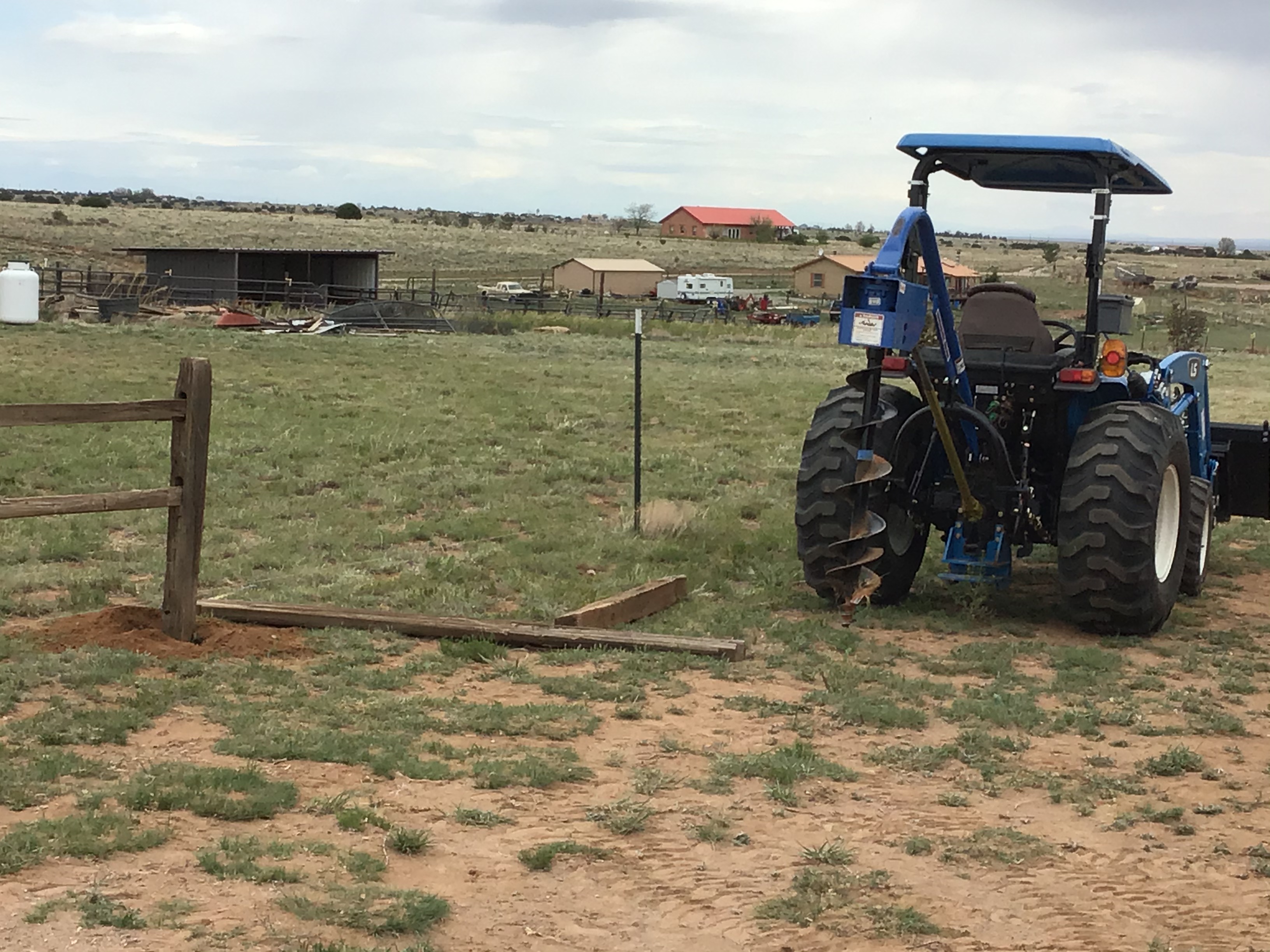

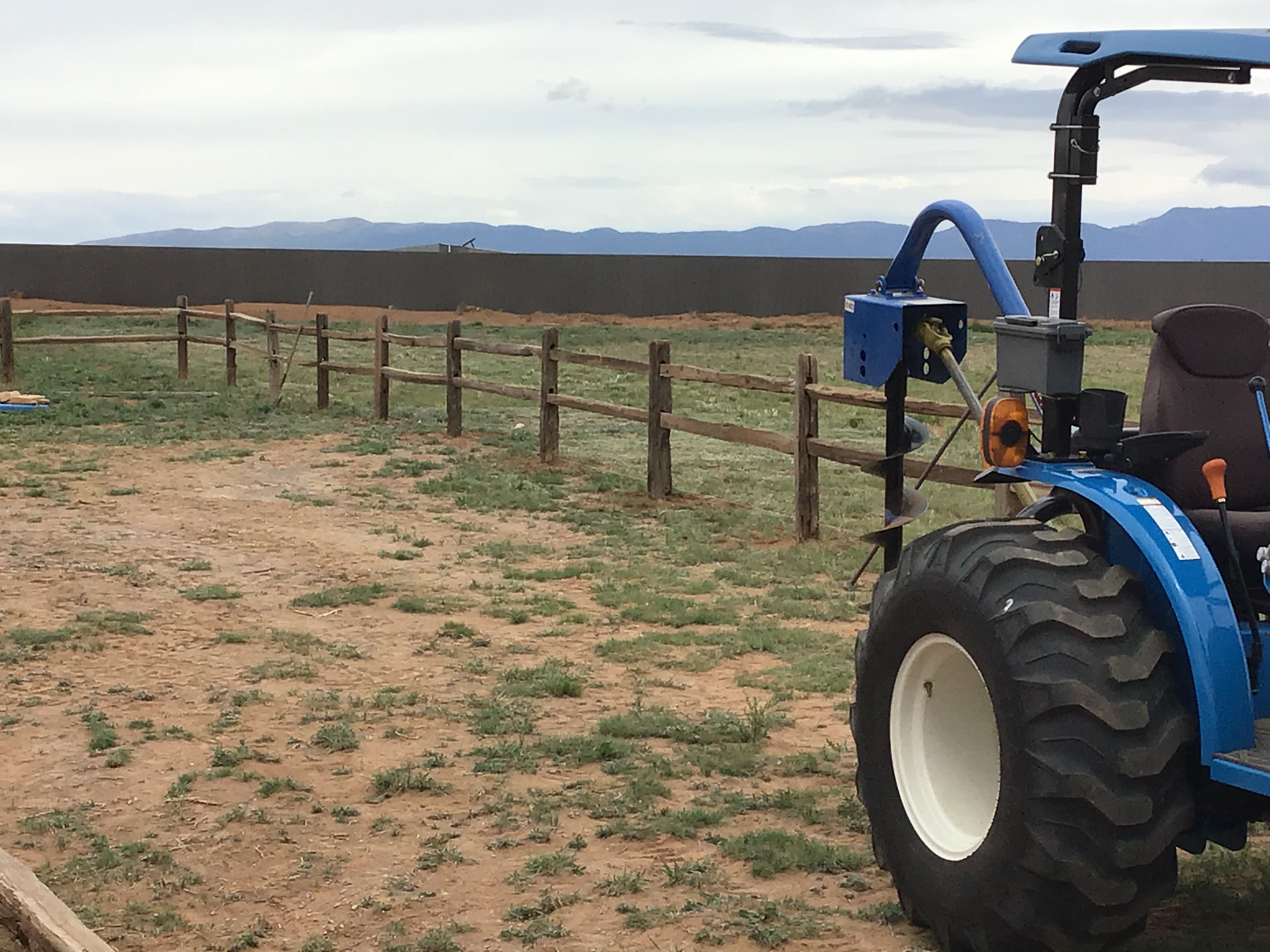

Make sure you have your stabilizers (links) on the 3point arms tightened up to prevent a lot of side to side movement. This will help prevent an angled hole side to side. I usually place the tip of the auger in the starting spot, then move the tractor forward about 2 inches. As the auger digs in (about a third to halfway), the auger is vertical. I just did about 30 holes today installing a split rail fence. I only had a problem with one hole starting to go angled... I lost my pin on the stabilizer link and it loosened up.
