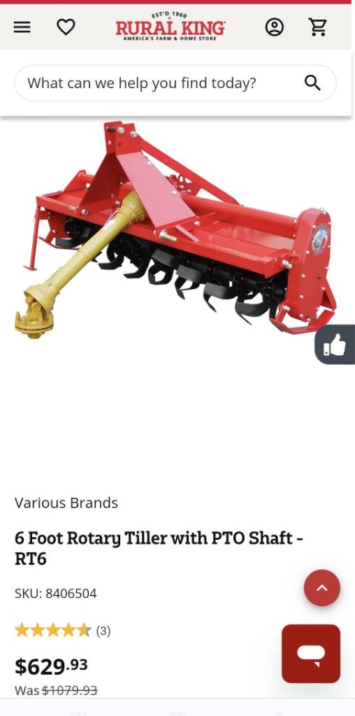

First, I understand buy the best and cry once, but FOR THE MONEY has anyone experience with this tiller from Rural King? Attachments are all great, and a tiller I could use but at 73yo and probably 5 to 10 hours use a year...$630 for this 6ft one seems like a great deal.
I have a few pasture areas this along with my back blade would make it better.
It probably would be good for my compost bed occasionally. I probably would make a small garden spot also.
I called the closest Rural King (75M) and the 'attachment guy' I spoke with said yes...it's made in China, but they sold a lot of them and never had a single complaint. I think he said it was Titan (?). They are able to get parts if needed.
I looked at good ones but they're about $3,000 and the little I'd use it even $1,500 wouldn't be worth it.
Thanks in advance as always.

I think it would work fine as long as you treated it gently in your situation. Rocks are the main hazard.
   / PTO 6ft. Rotary tiller. Advice for this one? #3
IF I were needing to do the work you describe, my bills would come out SMOKING for that unit.
But... I would be sure to walk every inch of what I planned to till and dig out every rock . Bent tines and torn up drives will make a man cry. Still, there is no guarantee a more costly unit wouldn't tear up just the same.
Check for fluid in the drive boxes, lube the chain. Go rip up some soil.
(For gardens, I've stopped tilling, Mulching is a much better way)
