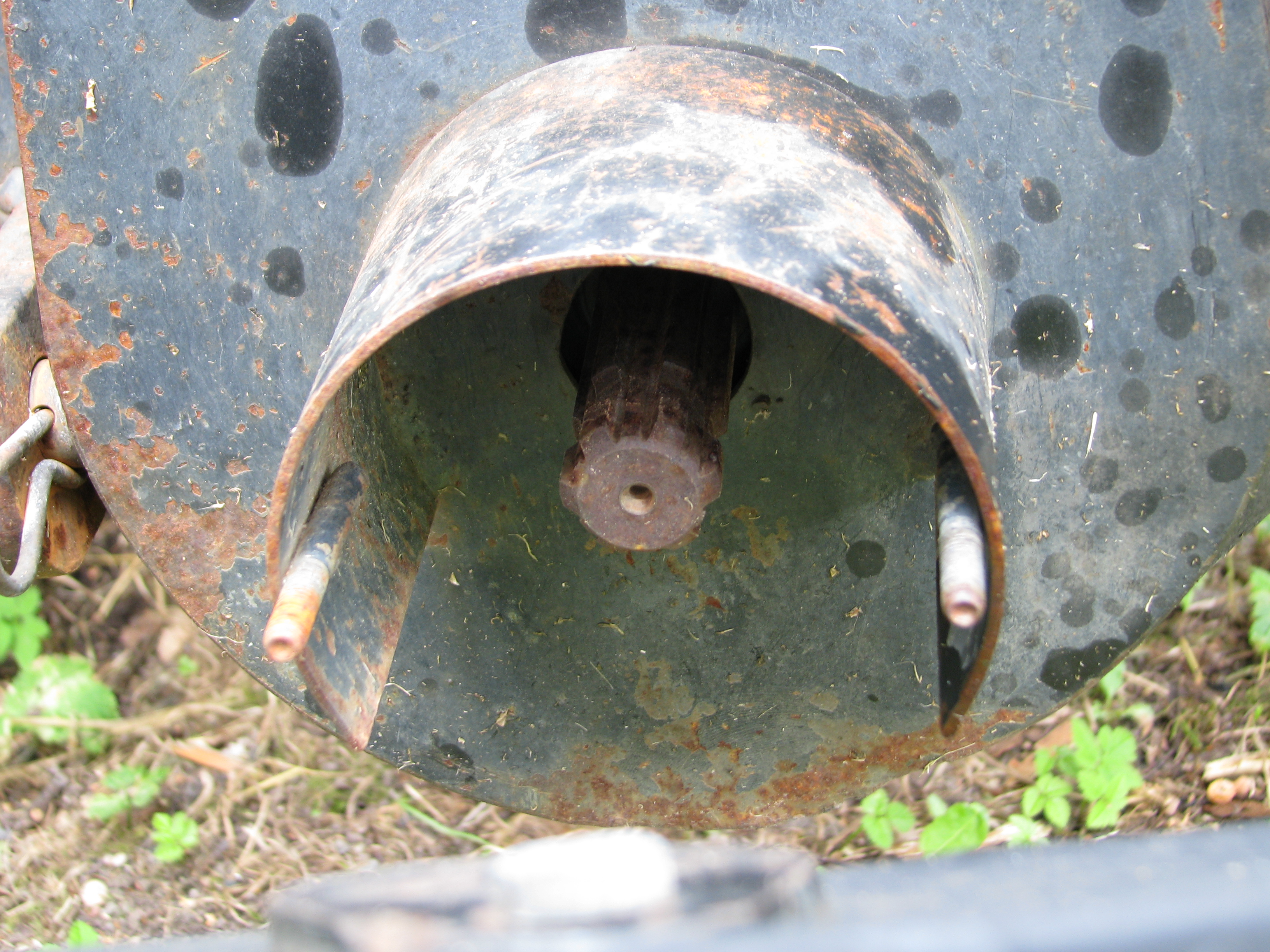

Thanks for the tips!
That document contained some interesting parts. 0332-00341 is close and might work! I did the conversion again and 24mm is actually 0.9449" and not 0.98". But 1" might still work.
This is how it looks like
When I look at this picture and then one of the rear PTO, which is 1 3/8", I can't really tell the difference. But in reality the one in the front is much smaller.
In a perfect world I would like to have female 0.9449" -> male 1 3/8" adapter. But anything converting it to something more common would be great!
The reason for me looking is that I want to fit a mower to it. I could use the rear 3-point and PTO but I prefer to have it in front if possible.

I am confused.
Did you actually take a caliper and measure it? Was the .980" just an error that you had converting 24mm?
Where did you come up with 24mm?
15/16" is within a few thousandths of 24mm. 0.9375" to be exact.

Sorry for messing it up. Yes I used a caliper to measure it and it is 24mm. I get a little different numbers when looking up what it is in inch.

I've found out that Walterscheid have yokes that fit those PTO. They call it 6x21x25. ISO14 also gives you a hint in the right direction.
This might come in handy for someone in the future.
