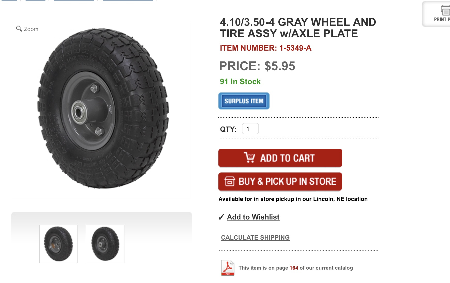

Would these work?
$5.95/ea, plus a can of foam from your local hardware store...

That's the correct size. The rim is not correct.
At that price, I'd be tempted to buy 4 of them, and cannibalize one set of rims for this side with the outer offset. You need that offset on both sides, or really long spacers.
My luck with cheap wheels at local surplus stores has not gone well. But for $25 plus shipping for 4, I'd be tempted.

Also, those have a 1/2" bearing bore where we need 5/8". I wouldn't be confident that they could be converted successfully.
