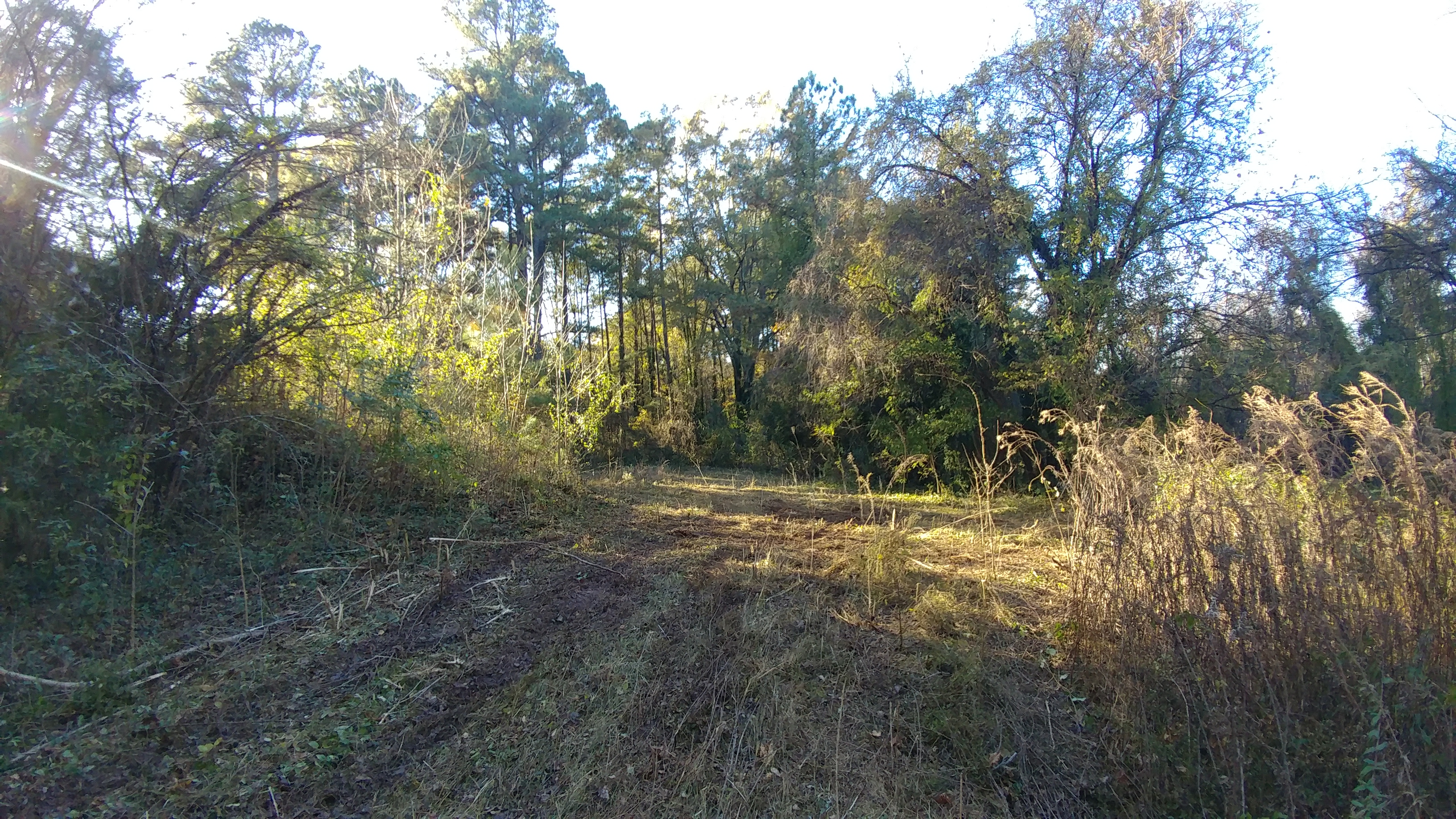

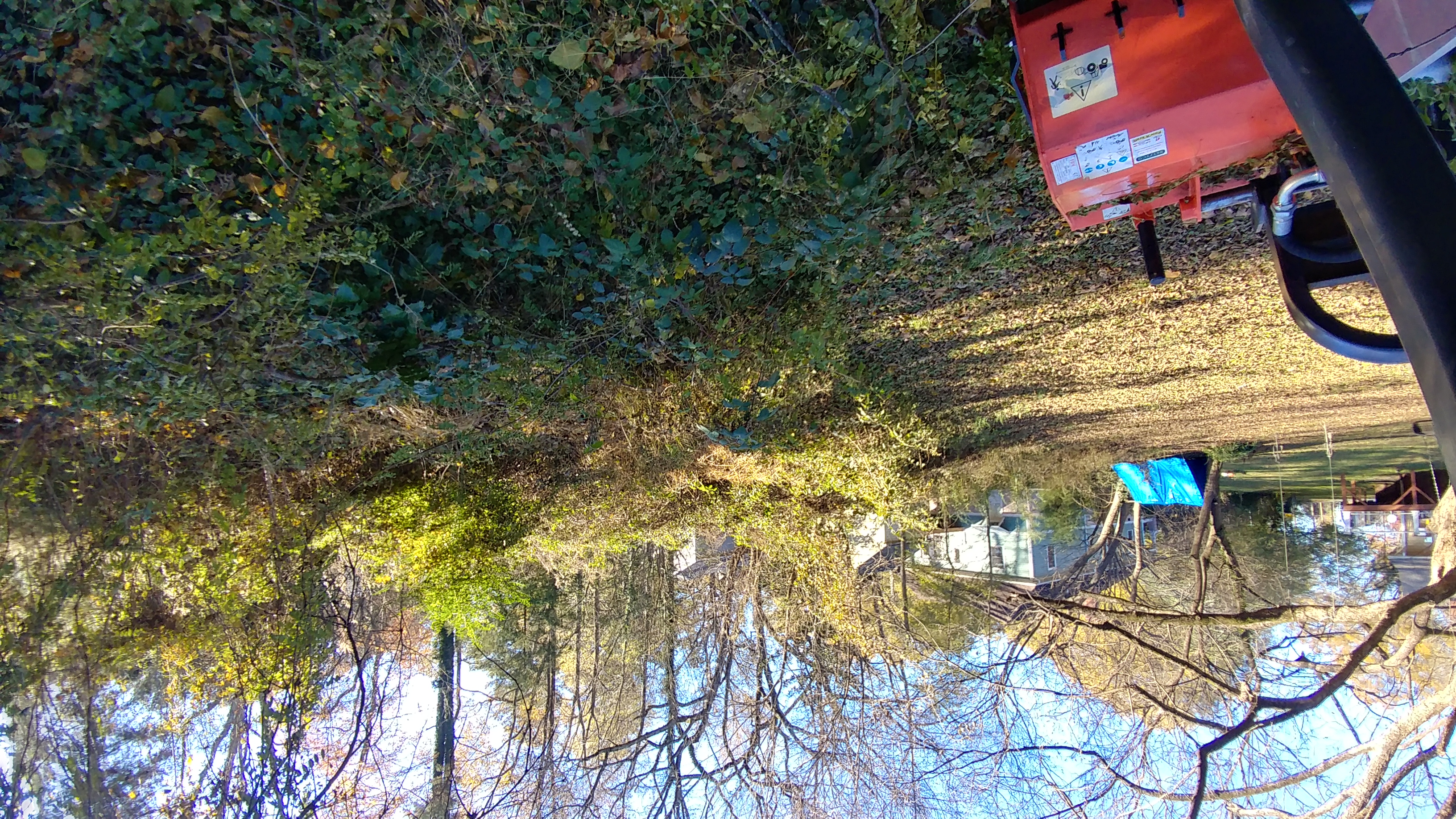

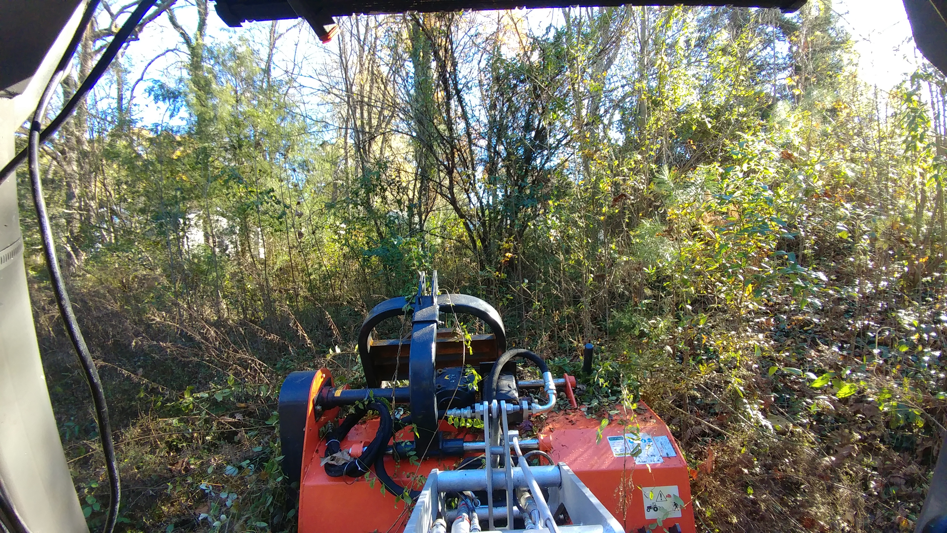

Here's a couple of pics of the tractor mulcher I've just adapted to hydraulic for the PT 1850. Fh-d160 from betstco.com.
   / PT1850 Mulcing Blade Options? #3
That upside down part was hairy... But the PT handled it. :thumbsup:
