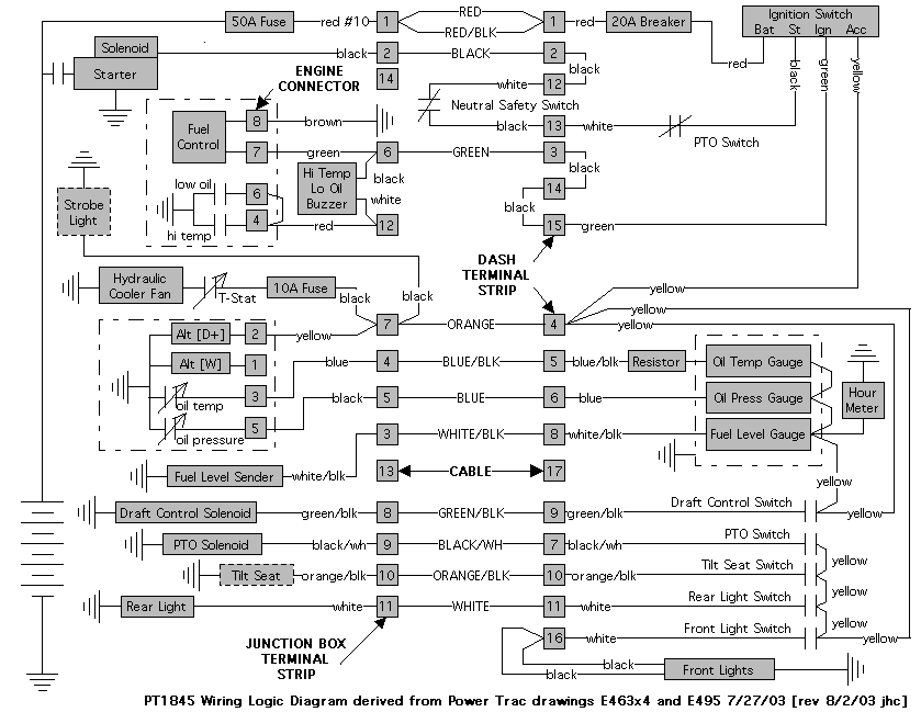

Greetings All,
Just purchased a used PT1850. The unit came with no manuals, but I ordered one from PT. However, the manual doesn't include a wiring diagram.
Could someone explain the fan set up to me. It looks like the cooling fan is wired into a solenoid with wires heading back toward the dash. I was guessing there was a temp sensor based auto kick in and a manual overide switch on the dash. Any help appreciated before I start digging.
I see there is a thermal relay for the cooler.
I have only operated the machine to off-load the machine at delivery and a bit around the yard and then into the shed. The fan has not kicked in and the dash fan switch doesn't cause the fan to come on.
Checked the fan operation already using the supply to the flashing light. Fan seems to work fine.

Welcome to the club. there are a few of us here with 1850's Happy to help out.
First thing is that you should let us know the year and take a few pictures of the beast. The machines change subtly and it leads to some confusion for sure. I don't believe the two of us who have 1850s have a dash switch for the fan. Ours are on relays. the relays are located on the passenger side of the engine tub, toward he back on the "frame rail" there should be an aluminum block with hoses running into it and a thermostat on the outside with a couple of electical wires. I have enclosed a couple wiring diagram. take it with a grain of salt. Its a good starting point but not the be all end all
I have also included (and i forget who did this) a wiring diagram should you ever decide to redo your wiring from ground up. Its a better design IMO and something to work off of should you get bored..
Oh and if you have to replace the fan, the factory version for mine machine is SPAL 30100385

Thanks for the diagrams. That will certainly get me on my way.
I got the machine through an auction. It is a 2007 model. I haven't taken any pictures yet, but the auction site still has several photos up, so here is a link.
Used Construction, Agricultural Equip., Trucks, Trailers & more
Comparing this machine to the manufactuer's website pictures, it looks like the previous owner used the "rear lights" switch and converted it to a manual fan circuit. They also appear to have rotated the seat leveling switch to left right...if that is indeed the original position.
I spoke with the PowerTrac factory and they confirmed that this machine did not come with a manual fan switch. So, now I've got to sort out what has been done. At present the manual fan switch doesn't cause the fan to engage. When I checked the fan with another power source it ran fine. The thermal relay for the fan seems to still be in place. I'll spend some time with the diagrams and report back.
One question. How long does the machine typically operate before the thermal relay kicks the fan in? I need to be sure the thermal relay is functioning.
Also, forgot to mention the battery is draining down. It had to be jumped to load and unload. I thought it was a bad battery, but when I replaced it with a new battery it drained down overnight. Perhaps something to do with the wiring modification.

The hour meter should not run with the machine off. That suggests that you have a +12V leak, possibly through the "added" fan switch.
The thermal "switches" are button disk switches. They are, in my opinion, under rated for the load, but they are cheap. A hot air source (hair dryer, heat gun) should cause it to complete the circuit. I'm not sure what yours should be set for.

My meter stayed on with the switch engine off but switch on. You got that for 6K? SCORE!!!!!! It is very similar to mine and Kens.. You have a new series engine but that doesnt mean much.
Usually the fan is on in 10 minutes of mowing on a warm day. I put a streamer in the fan so I can see it running. I have used it in the winter with no implement and it never came on. But it is a weak link and as it has been possible hard wired there is more than likely an issue.

extremely nice deal - congratulations. The disk thermostats fail fairly easily. I have bypassed it when it failed until i could get a replacement.
Ken
