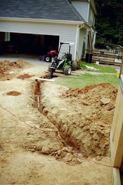

Good questions, sorry I'm no where close to you. I can help answer some questions though. As far as your slope 22 degrees is the upper limits of slope the 425 is useful on but you can certainly mow across that , just not anything steeper. The wider stance you get turning the wheels around will make this much better, just be sure to get the 60" mower or your tires will be wider than the mowing path. What do you want a backhoe for? If you only need to go 4' deep and 9" wide bucket is adequate the mini hoe is for you. It's much easier to learn to use than a backhoe, and is way better for picking up logs rr ties etc. and moving them. The articulated steering gives your l-r swing and once you get used to it it works very well. If you need a backhoe you won't be happy with it, if you need to dig 2 or 3 foot depp trenches across the lawn you will be very pleased with the mini hoe. Going through th woods is great on the PT because of the articulated steering . Parts are either easily available locally (like standard hydraulic hoses) or readily shipped from Tazwell. The two warranty issues I've had with mine were handled in a timely fashion by Terry. They are good , no frills workhorses and a great value. There's a used one on the PT site now that appears to be an excellent deal. db

</font><font color="blue" class="small">( What is the deal with the mini-hoe? )</font>
<font color="red"> The MiniHoe will dig anything except a well, a basement, or a pond unless you have lots of time! /forums/images/graemlins/shocked.gif
It also won't rip up your sod driving across the yard! It will get into places that a backhoe can only dream about! With reversed wheels it will straddle the ditch, and if it falls in, it will climb back out!!
