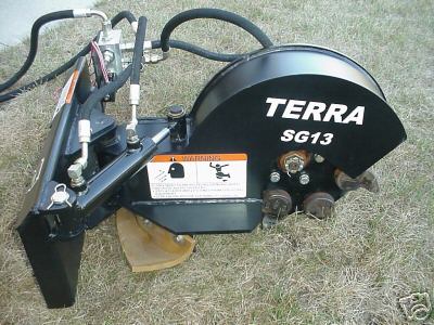

This picture shows a stump grinder made for a skid steer. It uses a hydraulic cylinder to swing the stump grinder. Small and compact .

   / PT attachment on Bobcat #7
I hadn't seen that model JJ!
I looks like the same style as the SS ones I've seen, only smaller and I think it's blade runs toward the operator like an "unreversed" PT cutter.
The ones I'm thinking of run about $5K and 25GPM, so I figured either $$$ or GPM was the reason for the PT version. But if that one is the right size, why "reinvent the wheel."
By coincidence; something like that is what I'd like to have on the rear of my 2445. I designed one, but on indeffinite hold as the parts would be over $1000; $1000 more than I better spend on any PT toys; for a while anyway. /forums/images/graemlins/wink.gif

JJ - Thanks for the picture. I looked them up and my friend has an email into them about pricing. The thing he liked about the PT stump cutter was price. He doesn't have a big need to justify the $5K Bobcat offerings but maybe the mini-skid steer version you pointed out will be more reasonable for his needs.
Well JJ, my friend got a price back on the SG13... Here's a quote from the email:
"The list price on the SG13 is $3499 - Delivered!"
Yikes! Well it's not $5K but it sure isn't $900 either! /forums/images/graemlins/shocked.gif I think he may end up trying the PT one at that price range.
