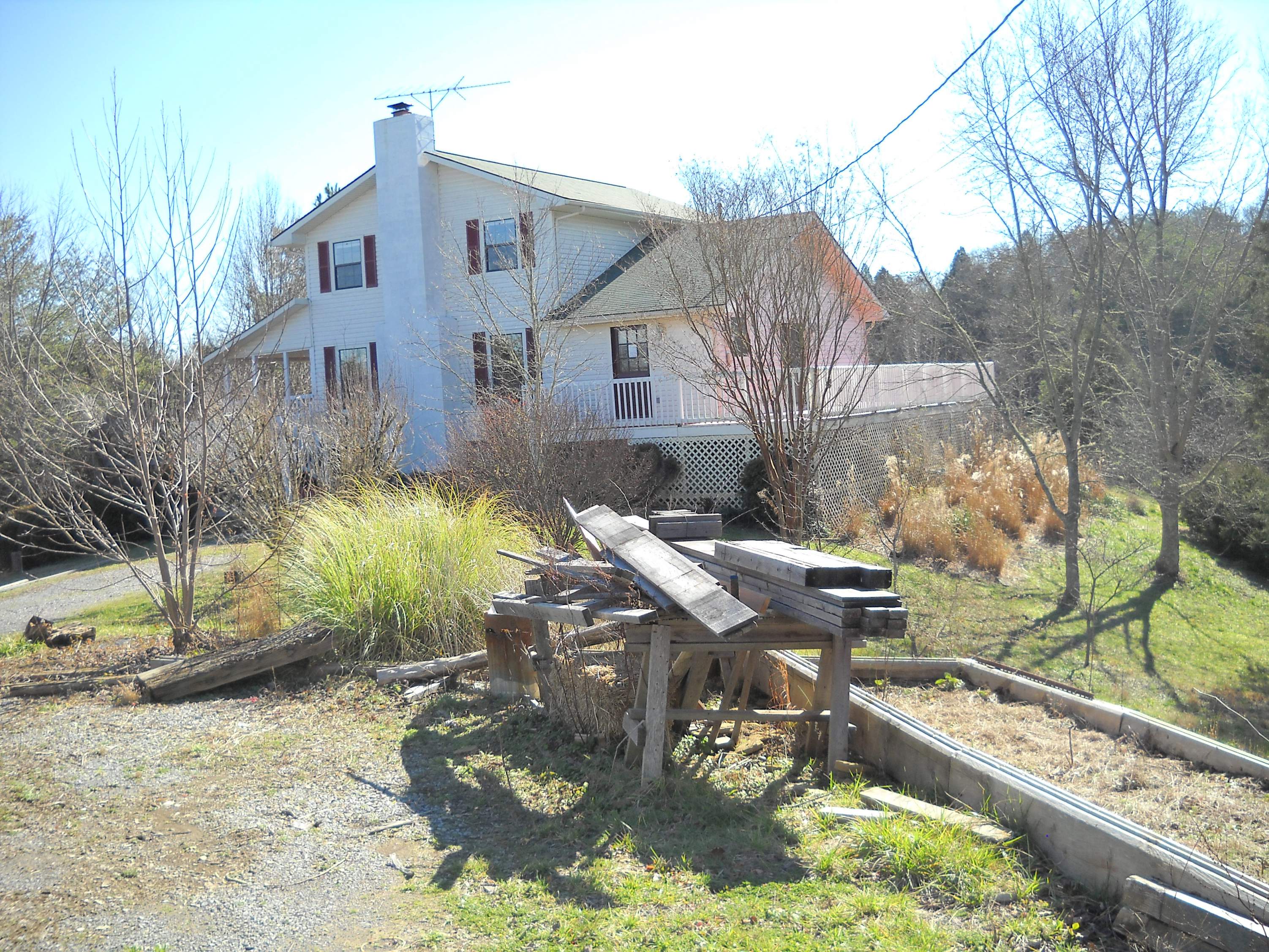

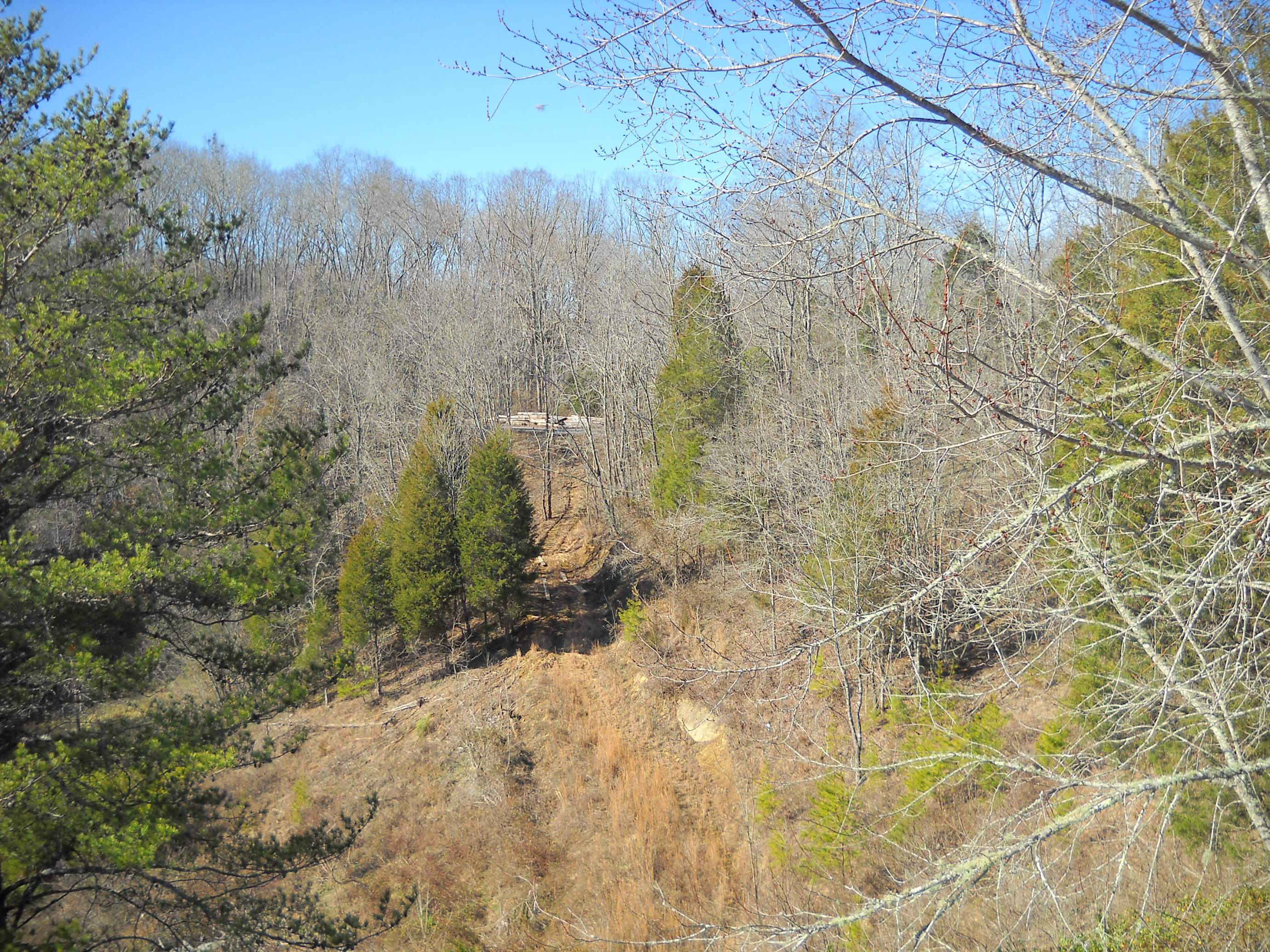

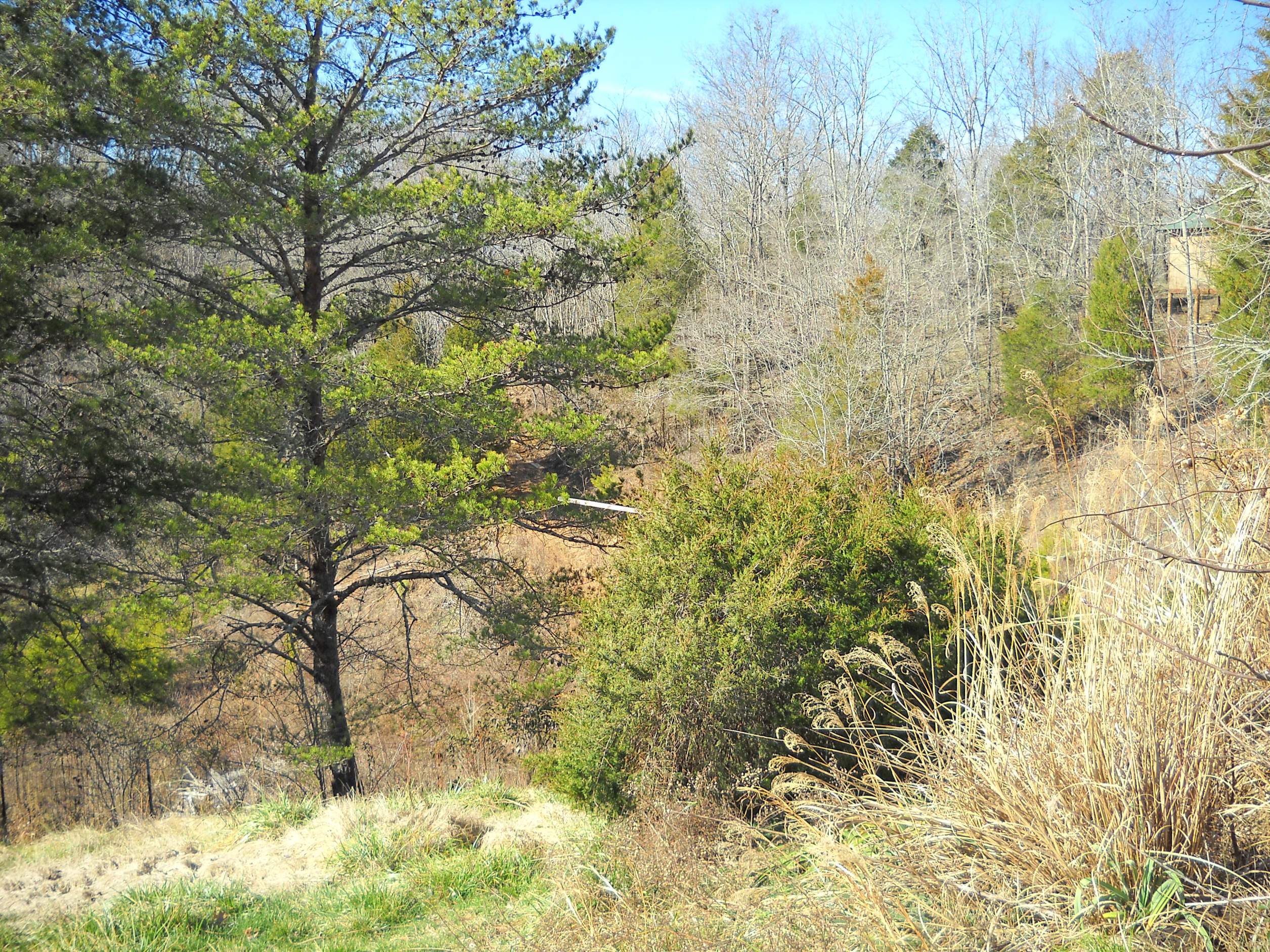

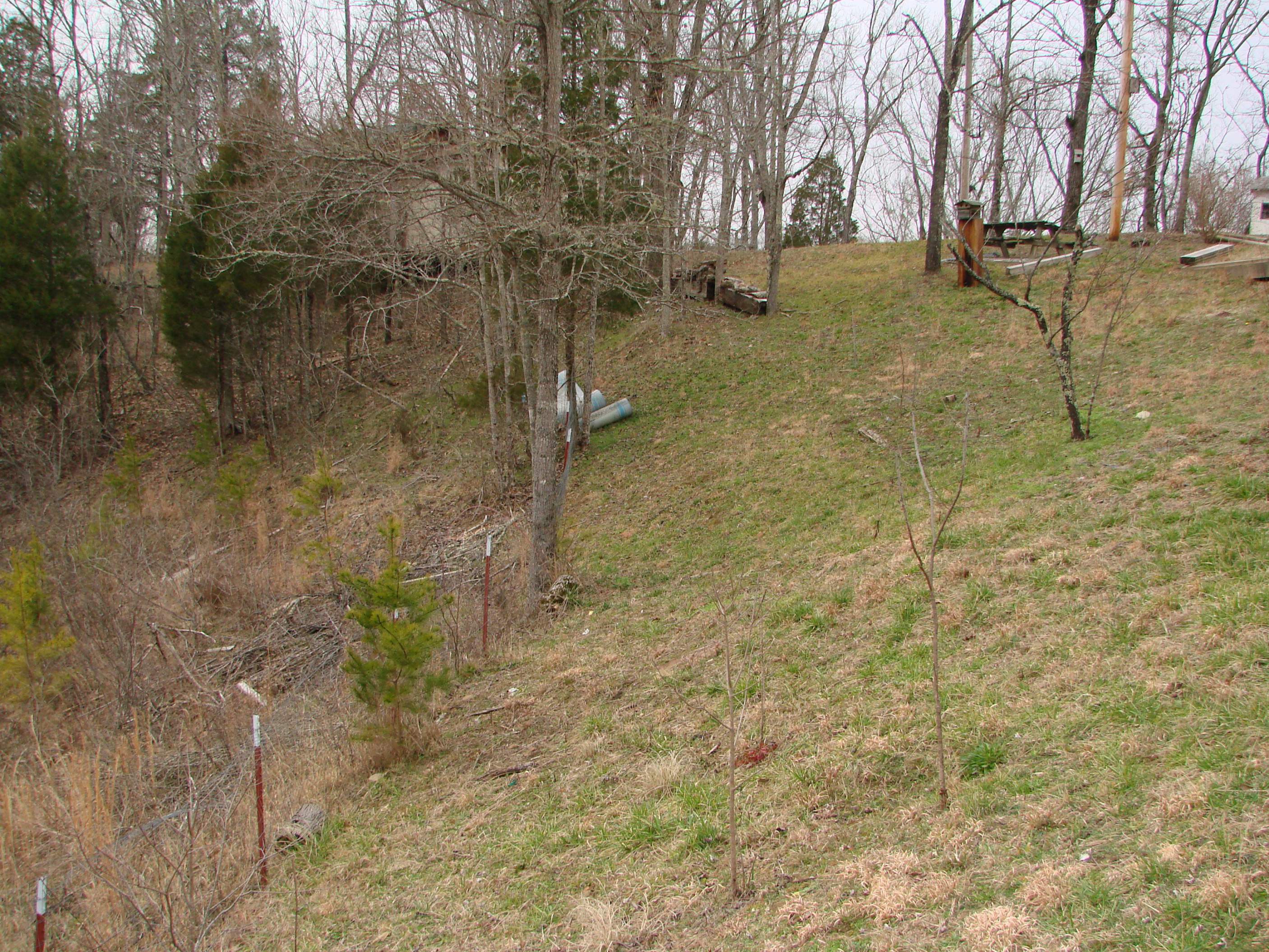

Since my long-range plans have taken a 180 due to a divorce, I'm selling off my planned building tract in TN, and have just closed on a foreclosed "farm" of 15 overgrown acres on steep TN hillsides. The current plan is to be moved in by the end of June, and telecommute for the last couple of years as I fade off into retirement...
There's a few pics of the place in this thread, where I'm asking for input on brush cutters:
http://www.tractorbynet.com/forums/2-wheeled-tractors/243689-brush-mowing-steep-slopes.html
I've attached a few more pics of the property below. So, in prepping my PT-425 for even steeper slopes, and more extensive use, I'm in the midst of round two of major mods.

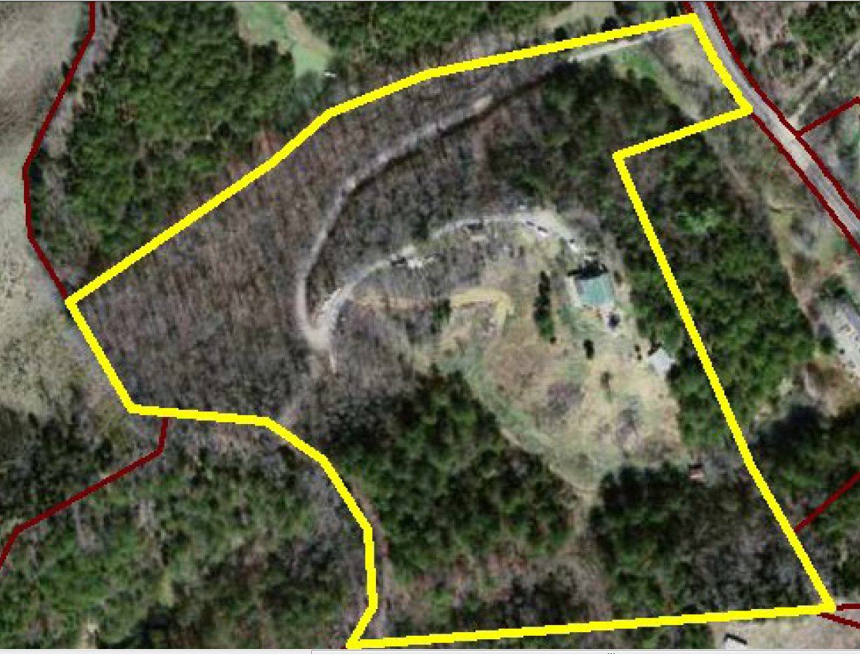

Meanwhile, here'a an aerial view of the property, from the tax site, showing the approximate boundaries. It is essentially an enclosed "bowl" running ridgetop to ridgetop, with one valley outlet at the lower right. I'll get to use the full set of PT implements that I have, since:
1. I have a long gravel driveway to maintain, as it goes across a small creek near the paved road (upper right corner) and climbs the ridge, then cuts back and runs down the ridgetop to the house, which is sited on the end of the ridge.
2. There's two potential garden areas, one in the "creek bottoms" down near the road, and the other in the head of the hollow in the center of the screen.
3. Plenty of woodlot to provide firewood...
4. A good site for a potential future pond in that hollow. Though there's no year-round water flow, there is a "wet-weather spring" in the hollow that flows out, and currently feeds a pond on the neighbor's adjoining property... Hopefully when the original TN tract sells, I've have the cash to both build a garage and have a pond dug/built down there.
The downer is that neither the current metal barn nor the two storage sheds have electricity to them so there's no good garage and tinkering spot... So, the new garage is the highest priority.
