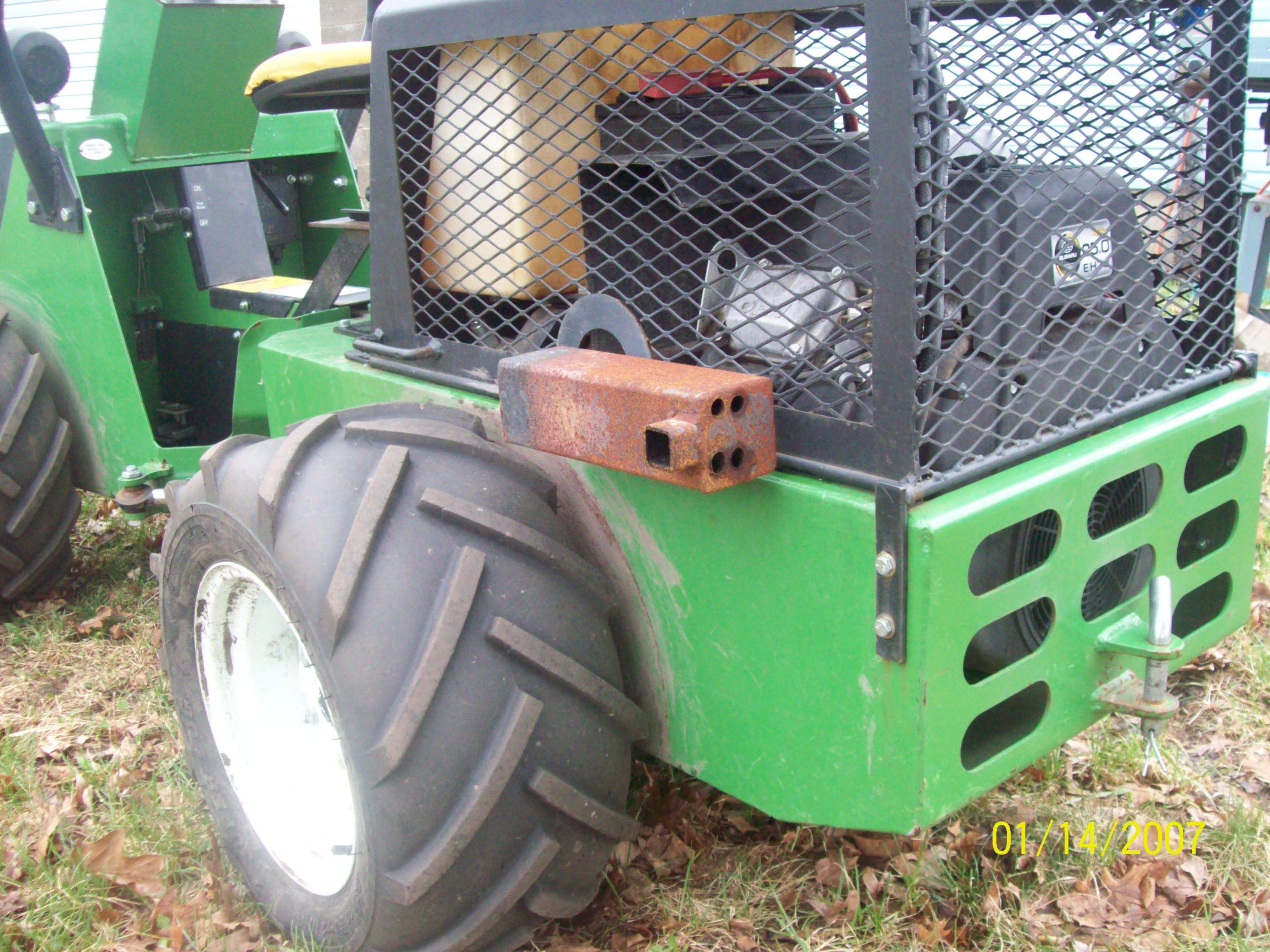

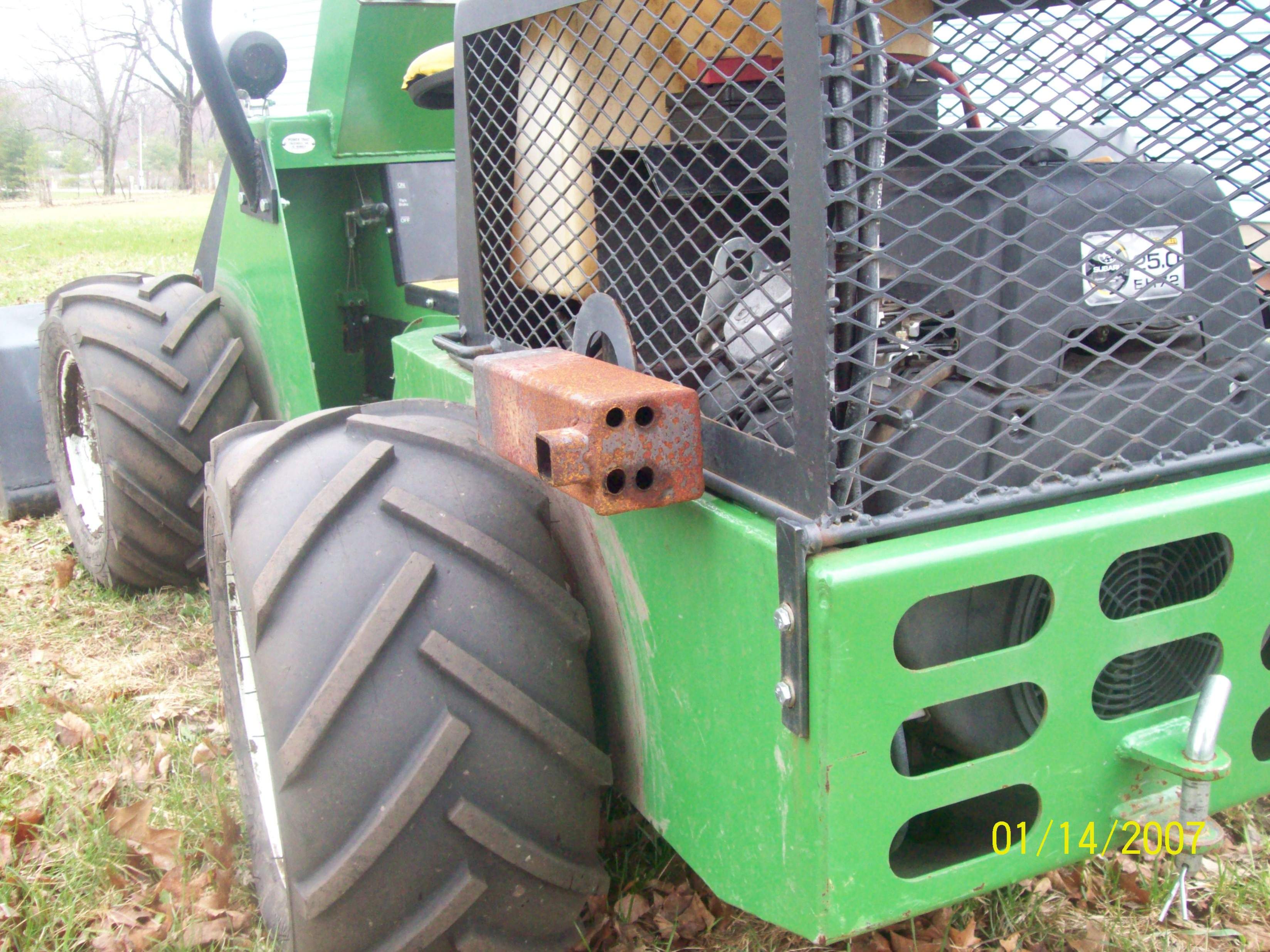

cut open muffler today :eek: in my opinion the exit area of the muffler should be the same as the intake area there is no way this muffler could accomplish this :( after some crude math i now have as much exit volume as enter voume of air :) no noticeable difference in loudness and pipes only glow about 2-3 inches from motor, no backfire/run on when shutting off :) tempted to build custom dual exhaust

[ATTACH]125890[/ATTACH] I apologize in advance if pictures are not sized correctly muffler project has been halted ( truck rearend has to be rebuilt first :eek: oops) I feel that the muffler still does not flow enough air volume cause there is exhaust exiting all openings will be working on a balanced air flow design after I fix the truck
