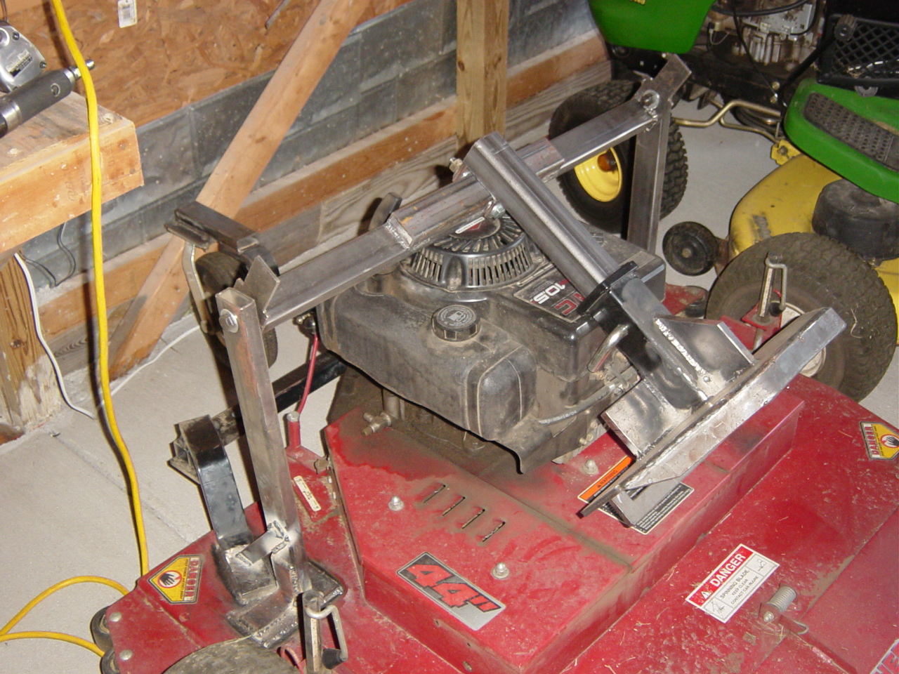

Will upload pics of the pull behind mower attachment experiment later...The camera is inexplicably misplaced. (I think it's in the barn but it's in shambles.):D Since moving out here I have not installed any shelving, work tables....Hmmm wonder how I could use the PT to do that....

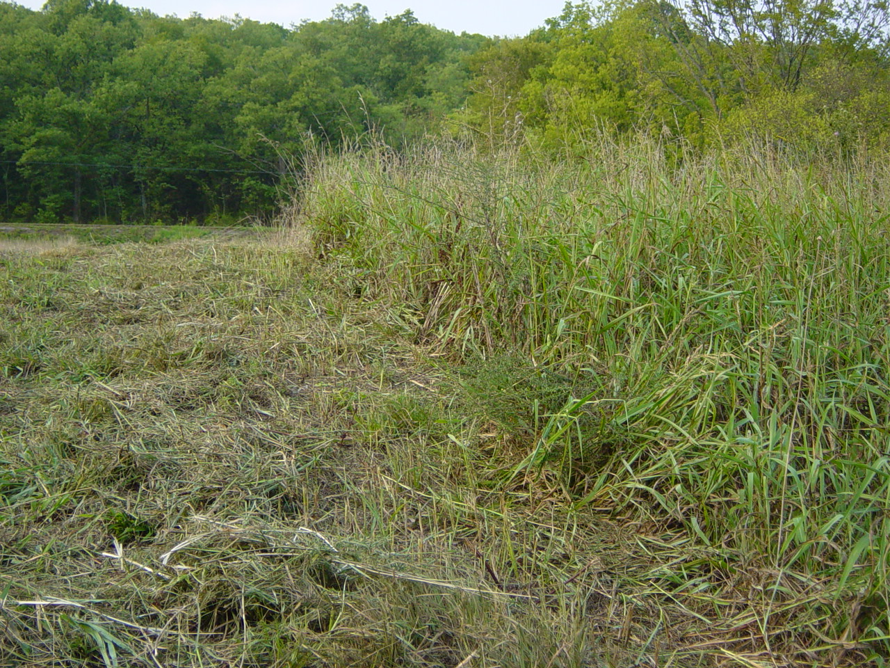

Ok, finally snagged a few pics. Notice the grass pictures...it's thick and probably 2-3 feet high. I was cutting with full bites today with the brush cutter. It's dry though. Never bogged down going about 3 mph (moderate walking pace) through this stuff. Can speed up quite a bit in areas where it thins out.

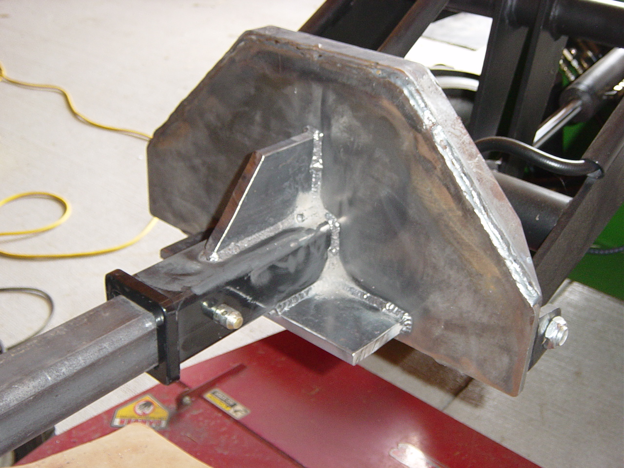

Also pics of my 2" receiver mount and mower.
I'm fabbing up some additional tools for the receiver mount: trenching bucket,
small grapple type bucket, my version of potatoe digger, ...maybe a box blade if I can find the right pieces of steel at the scrap yard.
