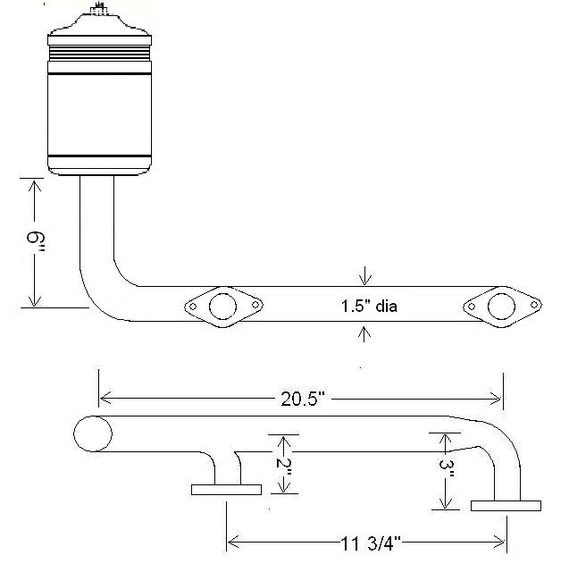

I keep playing around with the idea of dual exhausts also. My PT425 has the external muffler, but the way that the exhaust is piped out of the engine compartment looks like it would cause excessive backpressure and heating of the exhaust pipe, since it doesn't provide a smooth path for exhaust path flow.
However, I am not sure that I am ready to cut a hole in the engine cover, so I am thinking about just making something like the attached arrangement, and putting a supertrapp muffler with resonance chamber attached to the exhaust pointing vertical outside the engine canopy. I am thinking about making the horizontal pipe across the engine compartment out of 1.5" tubing (the exhaust elbows from the flanges are 3/4" nominal tubing), and smoothly curved pipe will do a better job of directing exhaust flow then the 3/4" pipe welded straight into a 1" square tube, which is the current arrangement.

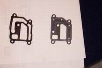

PT fixed installed the new gasket. IMO If you have a PT 425 with the Kohler engine especially if its the model like mine with the tank in the lid and the insulated muffler between the battery and engine I would replace that gasket. The new gasket is much different then the one removed (picture Attached). The older units had the form a gasket silicon which they do not recomend. I am not exaggerating, if that gasket blows it will pump the engine dry in 90 seconds. Also the oil will be blowing out the cooling baffles and under the insulation on the muffler and it will ignite in an instant. It is hard to put this fire out because the muffler is so hot. If the oil that will be all over everything ignites just run. Old wimpy gasket on left neww gasket right.

Where is that gasket located? I'm not clear from the description or its shape.
My PT has about 527 hours on it. Did the gasket fail before that?

The gasket is under the plate that the oil sentry sending unit is screwed into. It is under the air cleaner and throttle linkage in the valley between the cylinders. You can download the service manual on the Kohler web site pretty easy fix... It failed at 368 Hrs.
