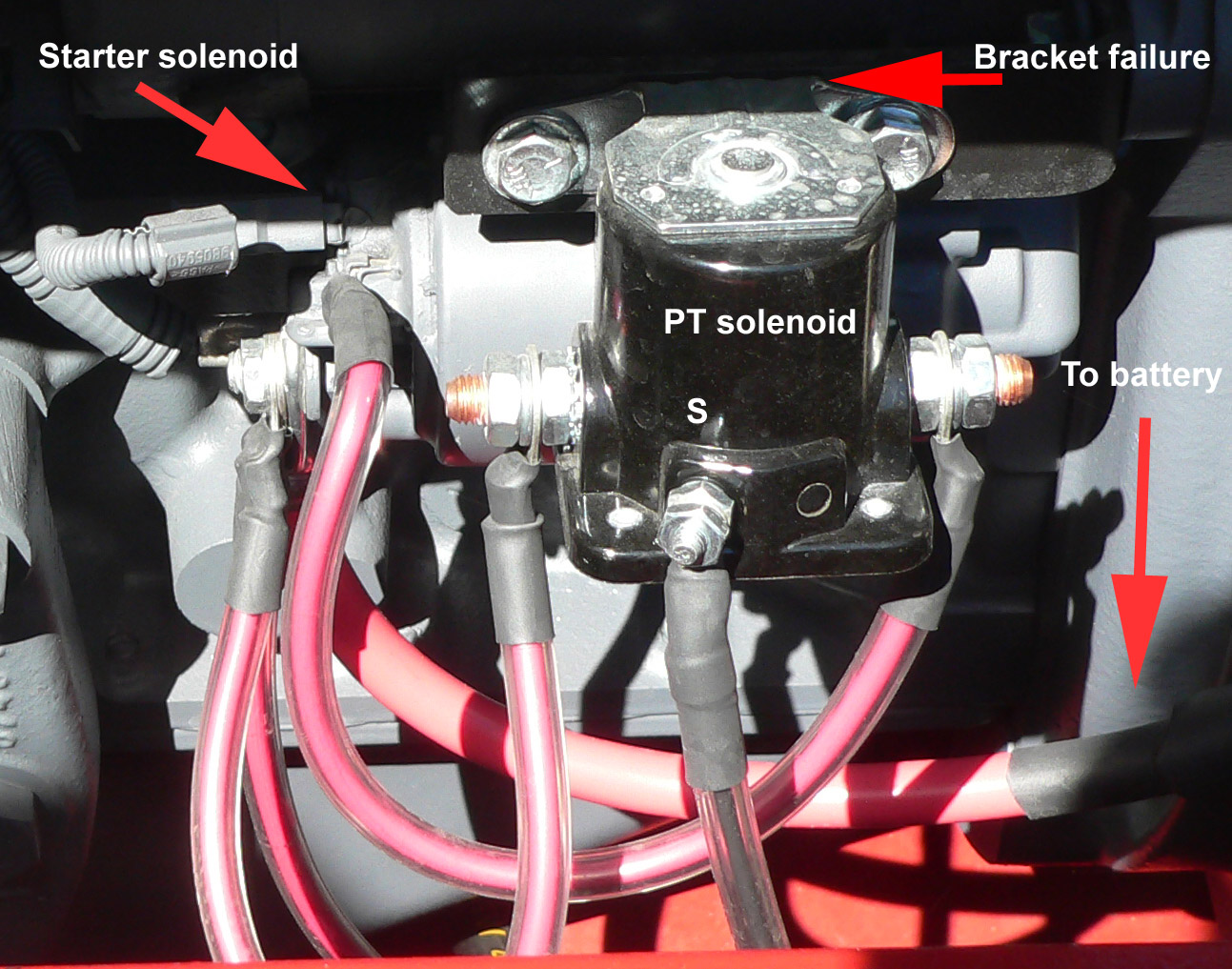

Went out to do a small project before dark tonight and the PT would not start. Since its been cold at night I put the battery on the charger Checked the PTO & Brake sol switches for proper position. Topped off the charge & still no action. By now its dark & time to research the PT forum. I did a search and:

   / PT 2445 Not Starting #2
Dear JT,
Did you hear the fuel solenoid click?
Did you hear the starter solenoid click?
Did you check the ground connection from the battery in addition to the battery terminals? (Obvious, but it happens)
If you only heard the fuel solenoid, you might try a direct connection to(hook up a wire to the (+) battery terminal and touch the) starter solenoid. to see if it cranks.
I've had to tighten a variety of small screws and connectors, but almost never had to re-tighten the same one. While it keeps coming up, it never hurts to check for blown fuses and loose wires.
Good luck,
Peter

With the dawning of the new day I got all the tools, removed the seat cover to access the engine. & set out with my trusty VOM, manual and notes from Ponytug.
Started at the battery & worked back, checking all items on the list. When I got to the starter the problem was obvious, broken wire! Installed a new crimp connection & I was back in business.
This was the wire from the switch to the soleniod. (small one)
Thanks for the suggestions, PT.

Here is a picture. It might look familiar as it came from a previous post by Ponytug.
The broken wire is marked 'S'

   / PT 2445 Not Starting #6
Congratulations! I had the same thing happen mid job. I stopped the PT to load the front bucket. (Mucking out stalls) And presto, no starting. The horses thought it was very entertaining. I have since added some more strain relief on the wire...
