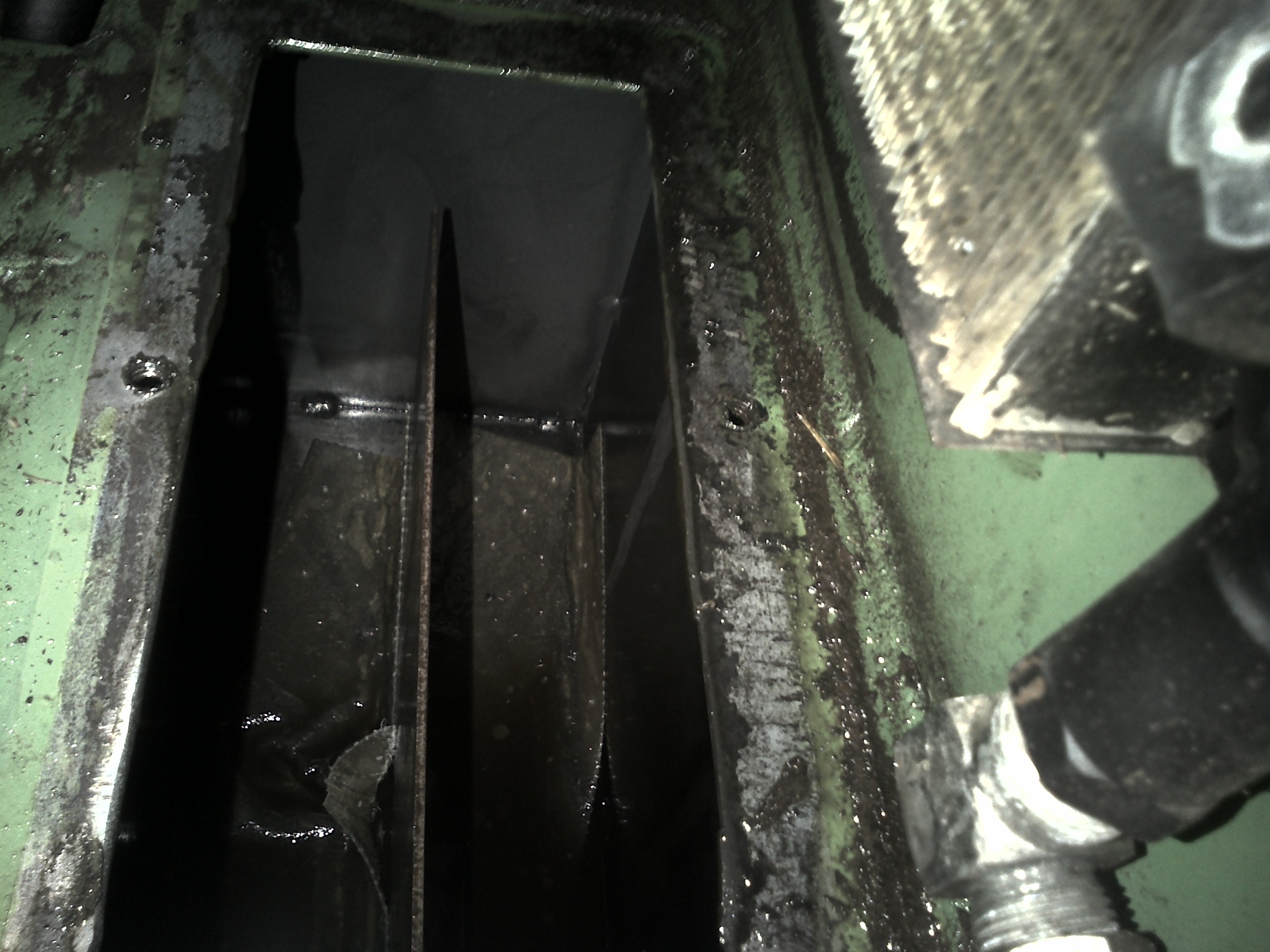

Power-Trac 2425

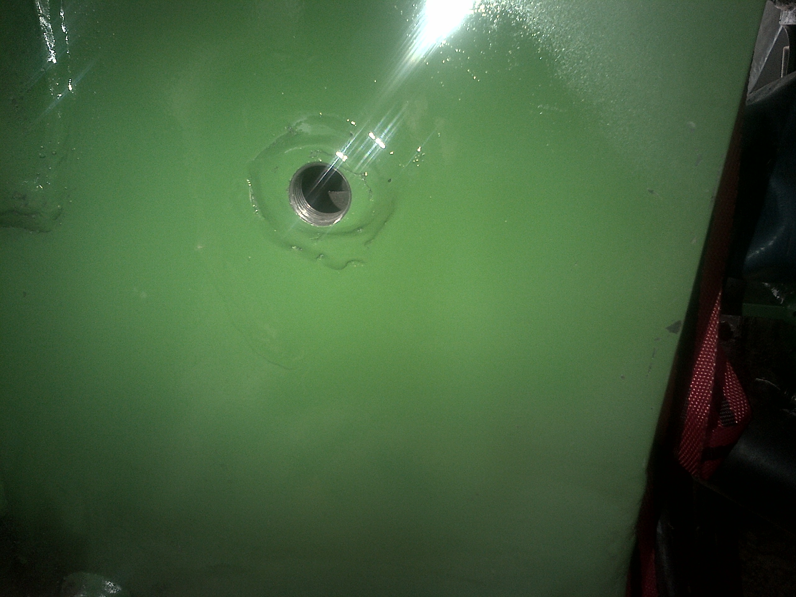

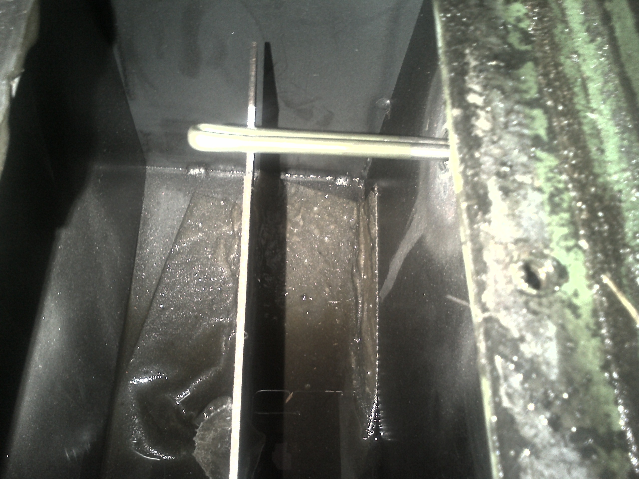

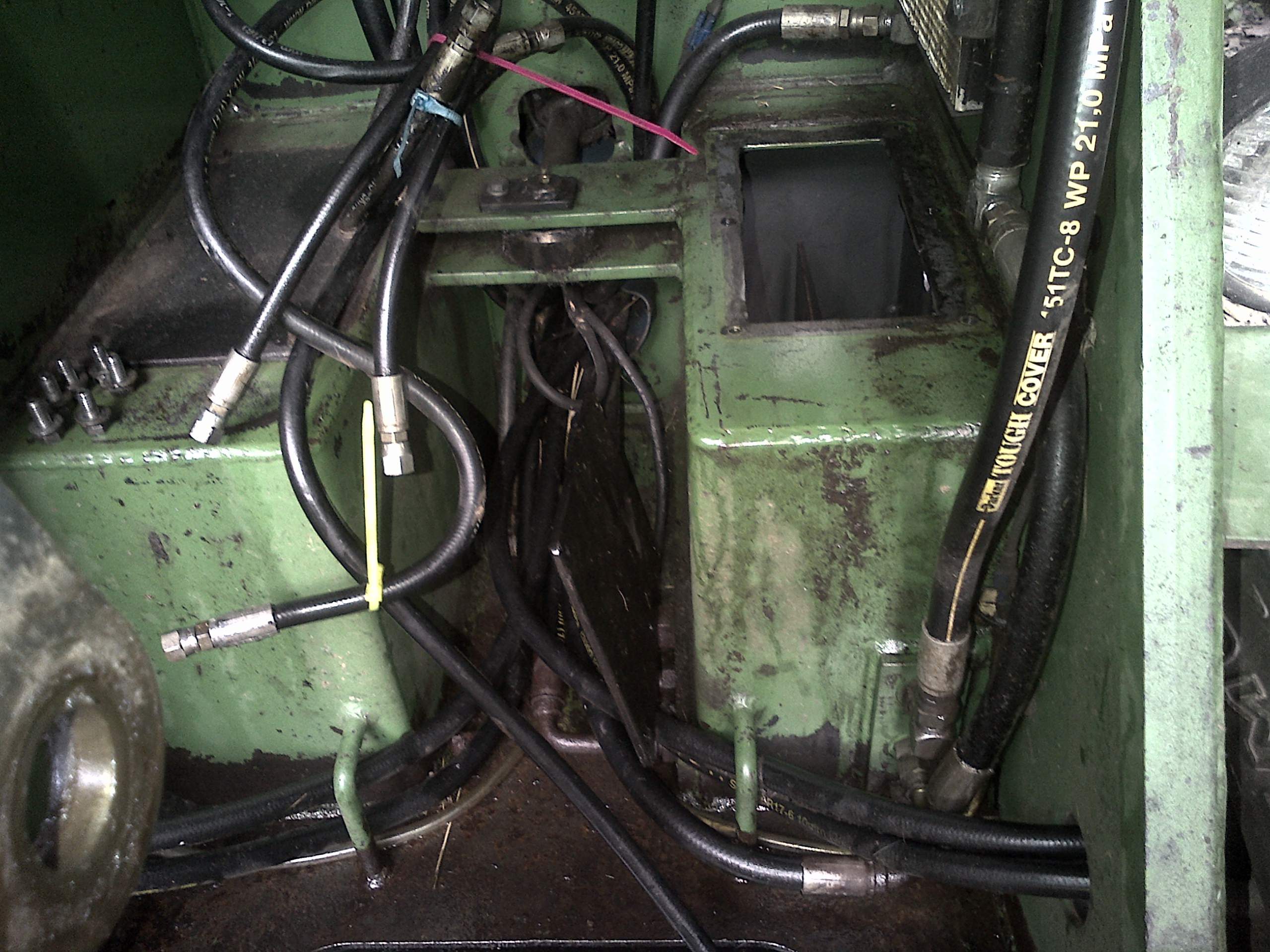

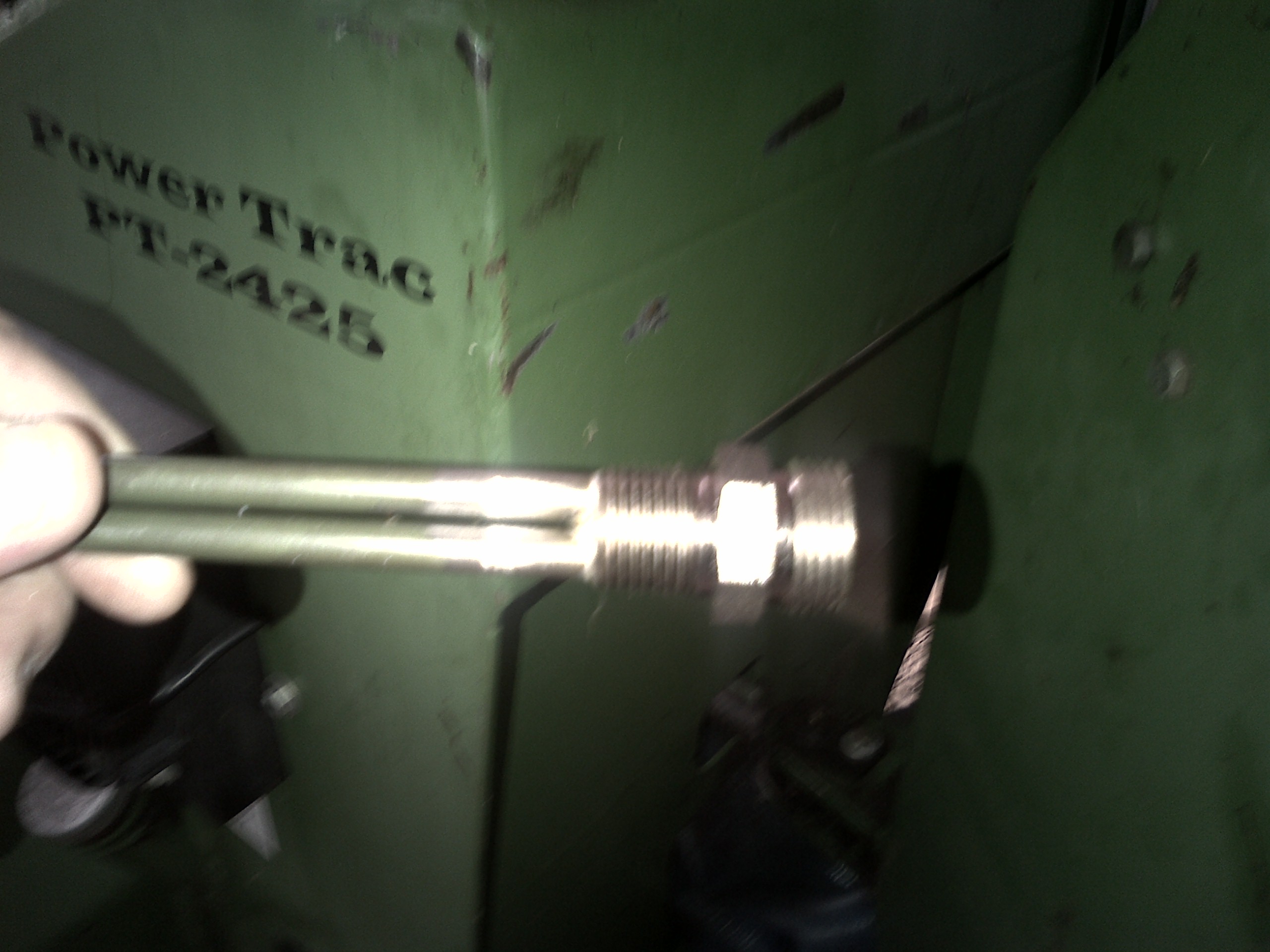

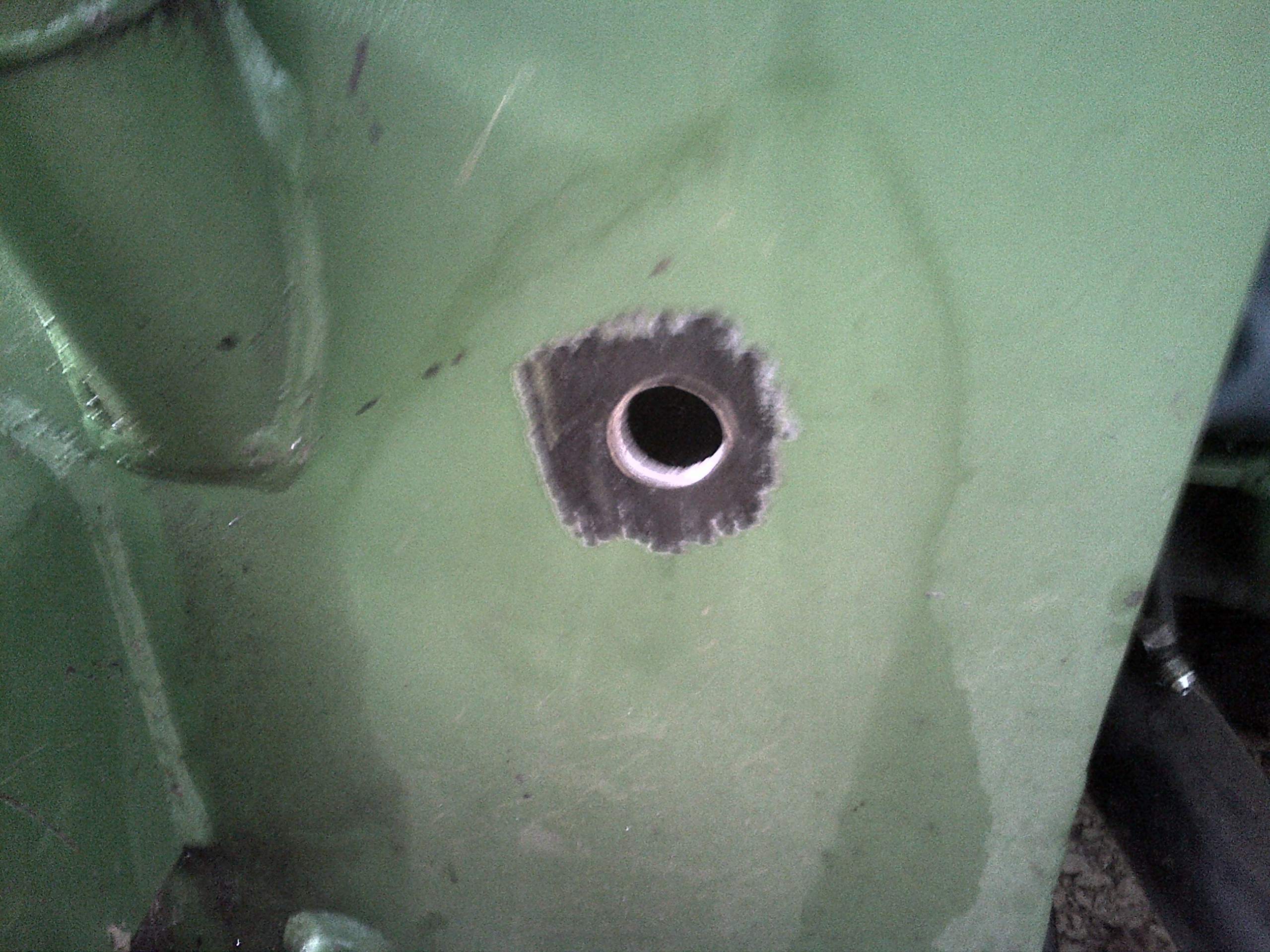

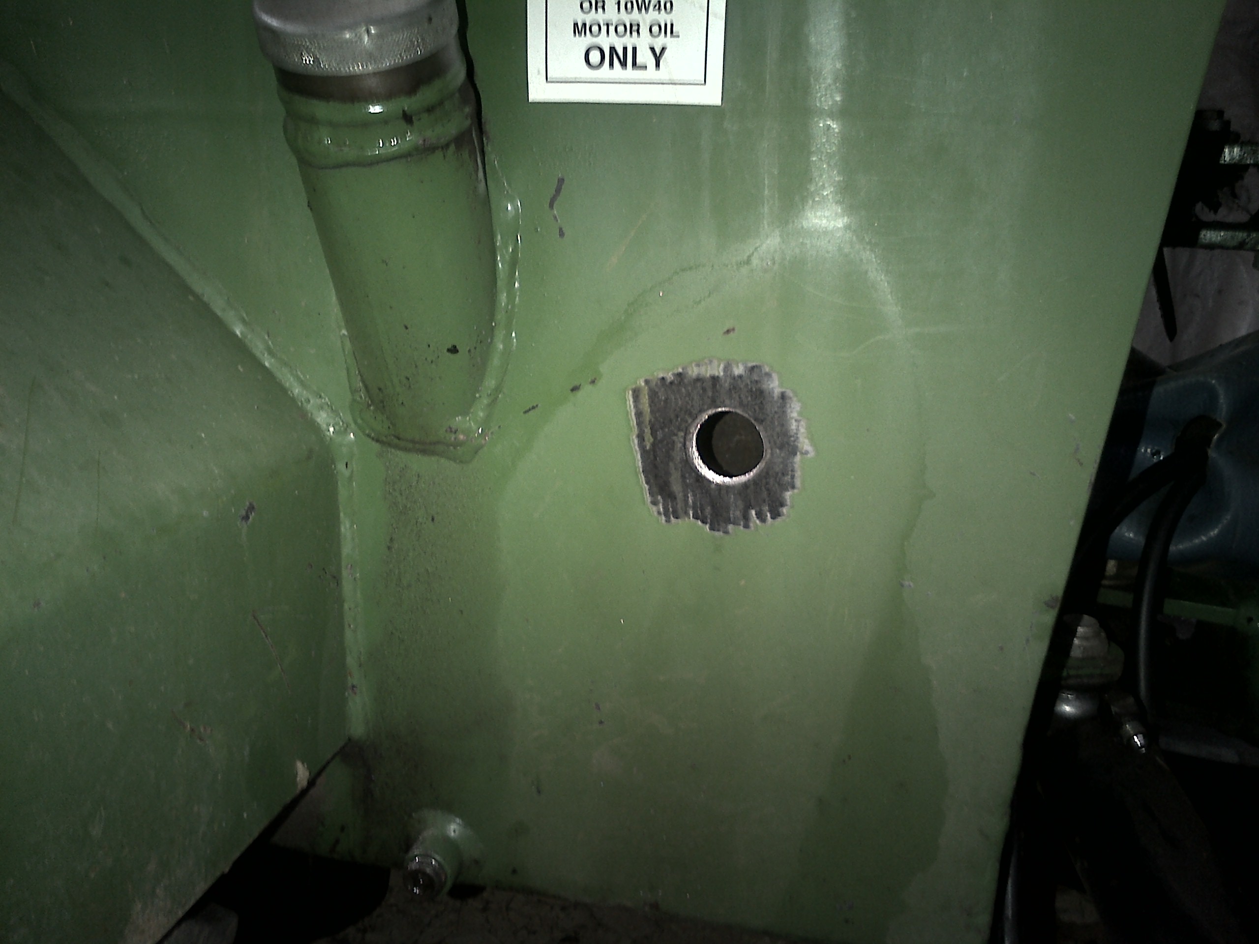

I own a PT-2425 love the tractor but here in the Pocono Mtns. in winter it loves to whine till it warms up in very cold weather I did not like the idea of a glued on blanket so I went for a heating element my tank is not in the same place as most others I have pictures that should explain the process pictures are not the greatest but you should get the point the power cord is removable the element is 110 volts and 300 watts

I spread out the pictures a bit. Nice job on the heater. :thumbsup:
   / PT-2425 Oil Tank Heater #4
with two of them up here in the mountains looks like we're the PT tallboy capitol....lol........it does get cold but I keep mine in a semi-heated garage so I haven't experienced the same problems.........I do appreciate sitting my butt on top of the engine on those days though! Nice professional looking job you did with the heater!.........Jack
