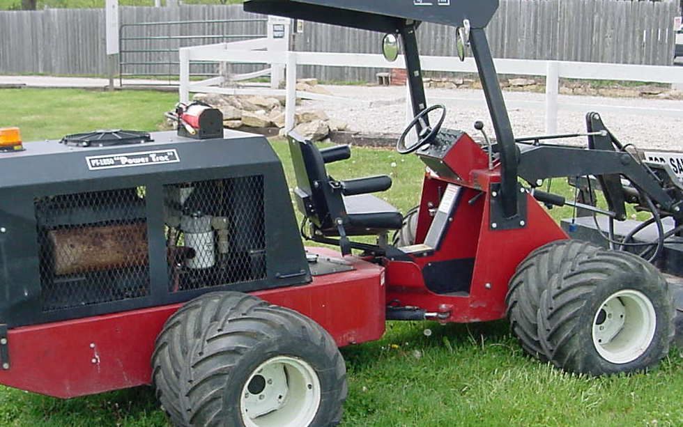

I can buy this used PT 1850 for $13,500 delivered to my door.
It has less than 250 hours on it.
It only comes with a rough cut mower. I would still need to buy $10,000 worth of attachments for it to do chores around the farm. I still would not have a finish mower.
Will this thing still turn fairly sharp with the dual wheels? Can I take off 1 set of tires to skinny it up? I do not want to buy this AND a seperate finish lawn mower.
Any comments or suggestions?
