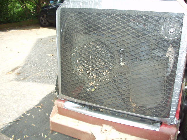

Those reading the blade test thread know that both Sedgeqood and I have had some engine overheating during heavy mowing at hot outside temperatures. There was discussion in that thread about the increased load if four blades per spindle contributing to the problem, which it seems to do, I think both by increased load and by blowing more clippings and dust into the air. With only two blades per spindle, I've never overheated mine, but have had the temperature start to climb, after which I have found at least some dust and debris on the oil cooler. For a while, now, I have blown out the engine oil cooler after each session.
Today, I duct taped some screen over the expanded metal in the engiine cover. After 15 minutes of mowing, the attachment shows what stuck to the screen opposite the engine fan. Without the screen, part or all of that would have stuck in the oil cooler, as would some that fell off the screen while I went to get the camera.
Tomorrow's supposed to be over 90. It will be a good test day to see if the screen by itself causes overheating.

/ PT 1845 Overheating #2
Wow, that's a tough decision. The screen could block quite a bit of airflow, but since it is spread out over such a large area it might stop more debris in the cooler which might be causing more overheating ... That made no sense /w3tcompact/icons/tongue.gif
My guess is that the debris in the oil cooler probably causes more harm than the amount of airflow that you are going to lose with the screen. (that sounds better) /w3tcompact/icons/smile.gif
Let us know what you find.

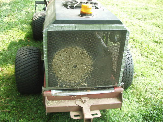

Mossroad, Marrt & Wasabi: Your posts echo my thought processes. After today's tests, it's time to get to Power Trac and work on modifications.
The fan sucks air from the expanded metal back of the cover. The oil cooler iis mounted horizontally beside the engine, so air goes forward into the chamber under the cooler, then up through the cooler. After it goes out the top, a baffle plate directs it out the left side.
Today, with ambient ar 90, climbing to 91 as I ran, the gauge went slowly to 240, the alarm went off, and I pulled to idle. I noticed the hydraulic cooling fan wasn't running, which is a separate problem that I haven't yet solved.
Attached is a picture of the mat of stuff on my screen.
I am sure someone will be tempted to say my screen and the mat blockage caused the overheating. It did, but without the screen the same stuff would have plugged the cooler. Some screen design work is needeed, as is a supplemental cooler.
Duane: The other tractors I've worked with all have screens in front of the radiators, which need periodic cleaning. On my old Jacobsen front mower, the intake is in the rear, like the PT, so it gets a lot of dust. It has a two stage filter, first coarse, then quite fine mesh. Of course, when those clog, it overheats 'til we clean them. The PT has no screen whatsoever, although it has a large air cleaner for the engine intake.
Time for some engineering, but I havan't figured how to make it self cleaning. Any suggestions?
/ PT 1845 Overheating #8
Charlie,
Just a question on your picture there. Is that light standard with the machine or did you mount it yourself. I assume it is some warning light when reversing??
#9
Chris: The rear light is a factory installation. I don't know how many models they offer it on. I bought the 1845 at the factory right after the price drop in January and it had some stuff on it which may now be options

/ PT 1845 Overheating #12
My oil cooler on top of the engine compartment looks the same way after mowing my field. When I shut the engine off, the grass falls down on the muffler and starts to smoke. I am afraid it could actually catch on fire. I was thinking of wrapping the entire inside of the engine compartment in screen.
Charlie, I seem to recall you live in MD. I live in NoVA. We had rain Saturday and I noticed a lot less dirt/dust/flying grass when mowing Sunday. If you also had rain Saturday, imagine how much worse the grass accumulation would be after a dry spell. I agree that something needs "fixed."
#13
<font color=red>You may want to check out Enginaire.</font color=red>
Marrt: That or similar technology is certainly worth a look. I need one about a foot in diameter, followed by a fine mesh.
For the imediate future, I'll knock the dust off my insect screen every half hour, and see if Power Trac can do some effective remedial engineering. I'd try a few things, but my time will be sorely limited in August. (And of course today is predicted to be 98 degrees, so I don't mind sitting in my office.)
/ PT 1845 Overheating #14
Yeah, that would most likely get caught up in the coolers had the screen not been there.
As far as a self cleaning screen goes, it would probably cost way more than its worth. Have you looked into a small 12v compressor with automatic pressure shutoff that you could mount on board? You could plug the ends of your trailer hitch tube and make it into an air tank. A short hose and blow gun could make quick work of the screen debris in the field.
