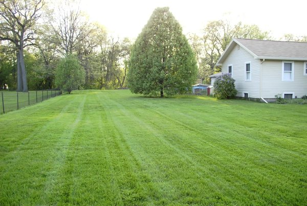

My 425 does an good job with the 60" deck. Power Trac specifically told me the 422 would not run the 60" deck well at all. To me, that means the 422 may run the 48" deck O.K. and the 180 would definitely not run a 48" deck well.
As for quality of cut, if I keep the blades sharp, it does a good job. NOT a great job. But a good and very acceptable job. I do not have a show lawn. And thick grass will bog it down, so I have to cut more often. Also, with the rear discharge deck, the clippings tend to make a windrow out the right side. And it also throws a lot of clippings right-to-left across the front of the tractor, which deposits in the opening on the inside of the left front wheel motor. That windrow on the right side is a problem if you like to stripe your lawn, as on the return trip, you'll double the windrow. The only way to avoid it in thick grass is to mow in the same direction on each pass, which means you cannot strip the lawn.
Anyhow, there's some videos of my mower in action. Click on my little tractor icon in my signature and follow the video links.
   / PT 180 Info #10
Here's a before picture of my lawn.
And here's an after picture. It's an acceptable job for an average lawn, but definitely not show quality.
