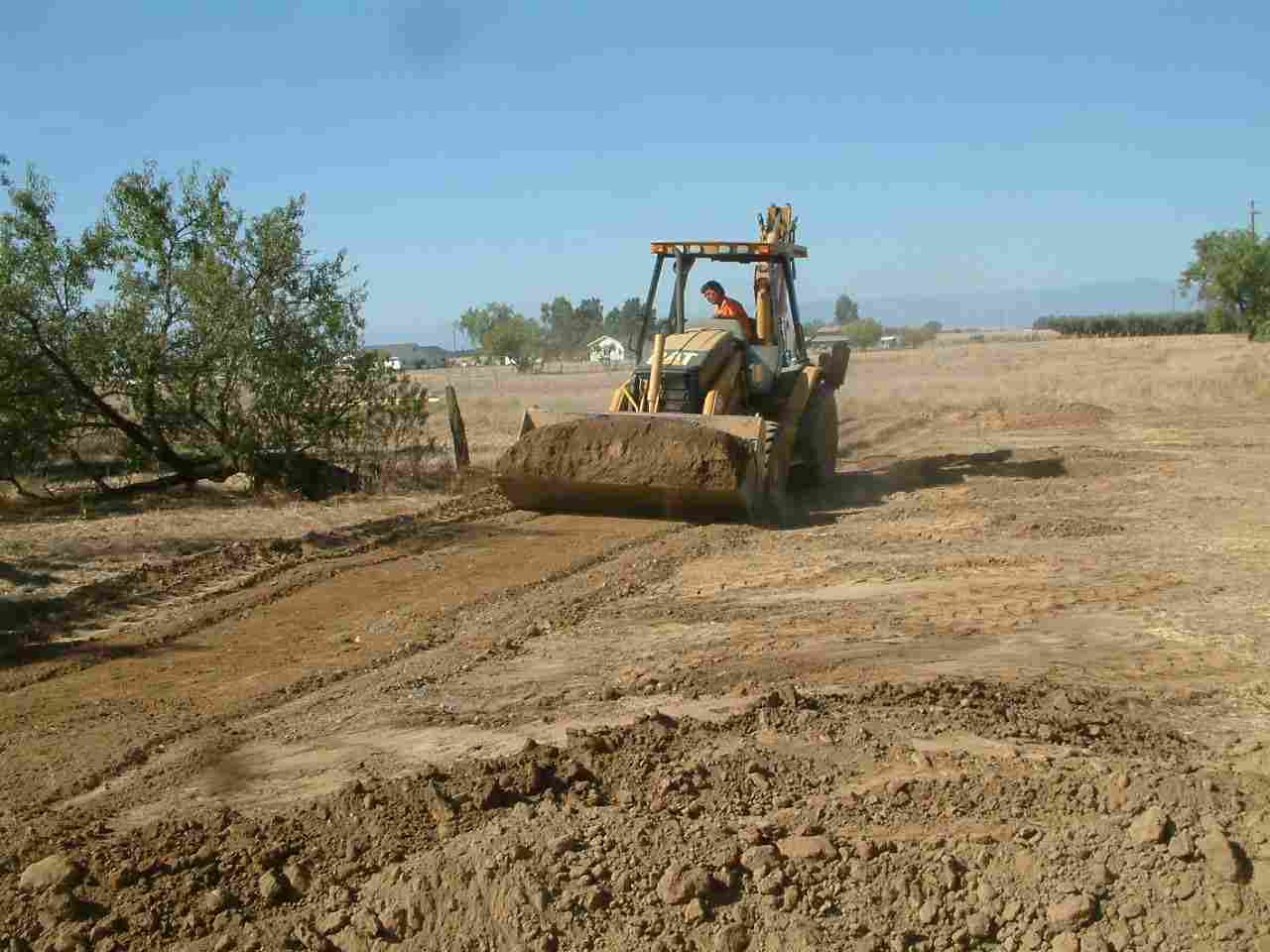

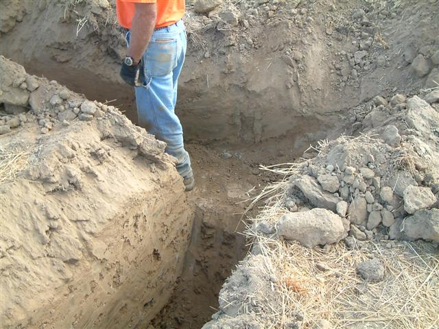

Same here. When my septic system was installed in 2005, the contractor drove his Cat backhoe all over the leach field backfilling trenches and leveling. No problems yet with the septic system.
