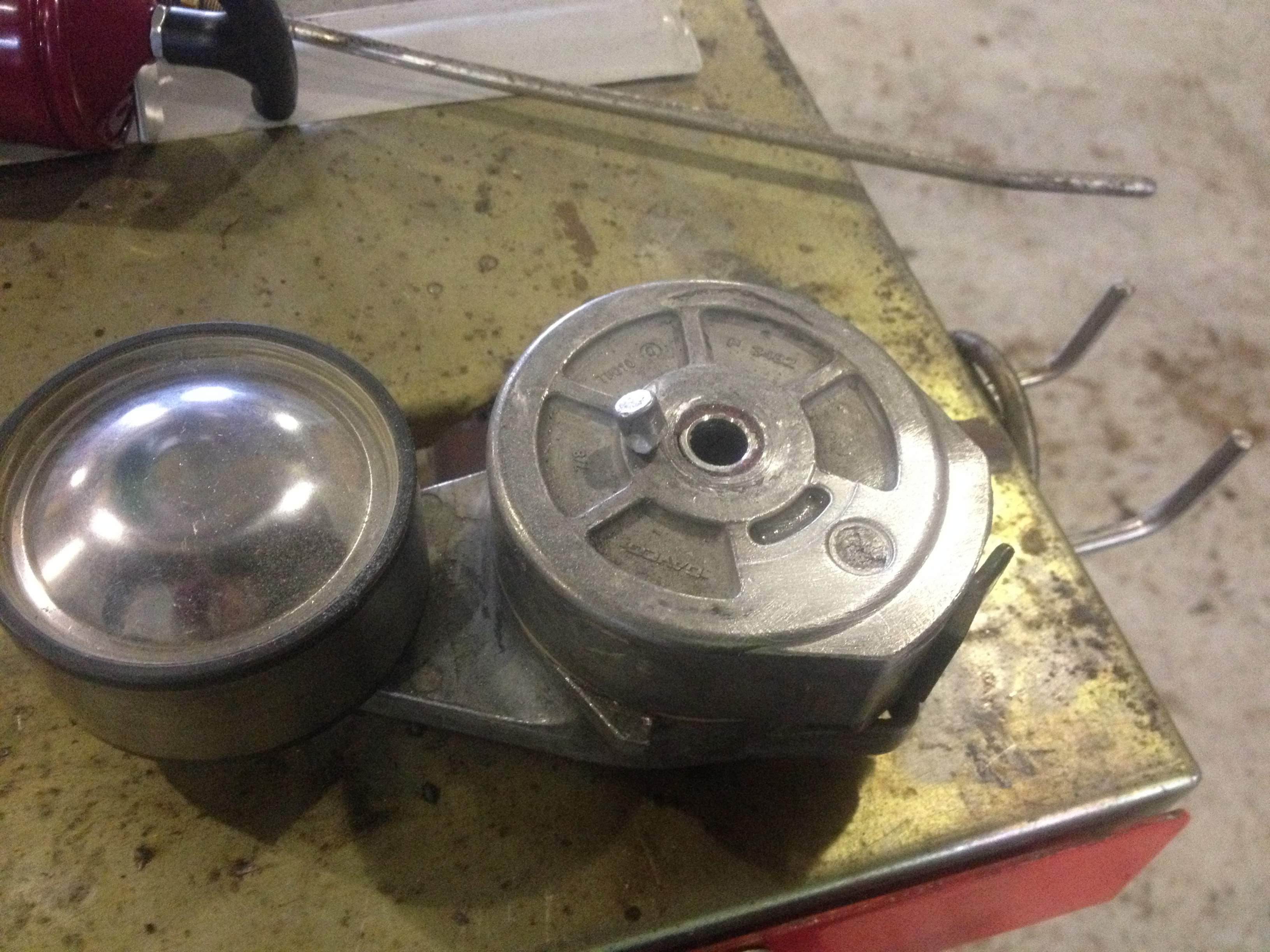

Seems a really poor design all of the spring tension would be on this cast alloy locating lug.Had mine break today seems to be a common problem.If you did not hear the belt squealing or if it broke the belt you could overheat the engine.Any body been able to change it with something better or more reliable?I was able to alloy tig weld the housing and build it up to form a lug to get us going for the day till new parts show up.

Kiwi Mulcher, if you drill and tap a hole were that tit should be and screw in a stud it may outlast the machine.:2cents:
When I get time I may pull the old one apart, as it is cast alloy I doubt a thread would hold and I think the spring in there would take up most of the internal space inside the housing leaving little room for a bolt head.why Perkins/terex use this tensioner seems silly, we have never had a problem with using the alternator to tension the belt on any other machine.Probally driven by making the end user buy more parts.
