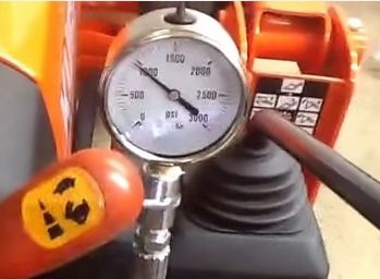

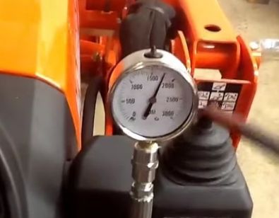

   / PSI/RPM curve for BX 25 #10
BX25D
As you can see by the information below, there is a significant difference in pump output pressure at an idle vs the working rpm range. Do the math and see how this difference equates to force and lifting ability.
Hydraulic Pump Pressure
1500rpm
3000rpm
