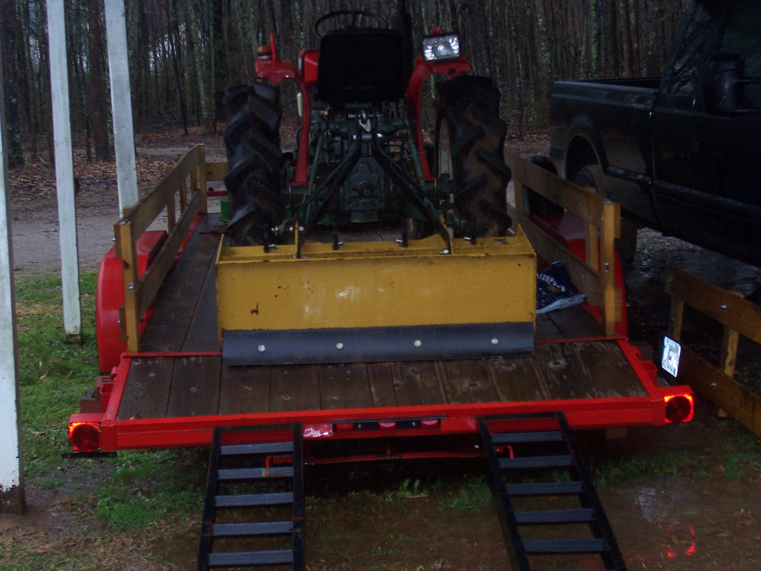

I agree with California. I have 3/4 mile gravel Dr. that I use my BB for mostly. It's 4ft. and works great for all my needs.
With my Rear Wheels spun for the widest stance the BB is the same width which makes it easy to get close to things without catching it. ;)
Carey
