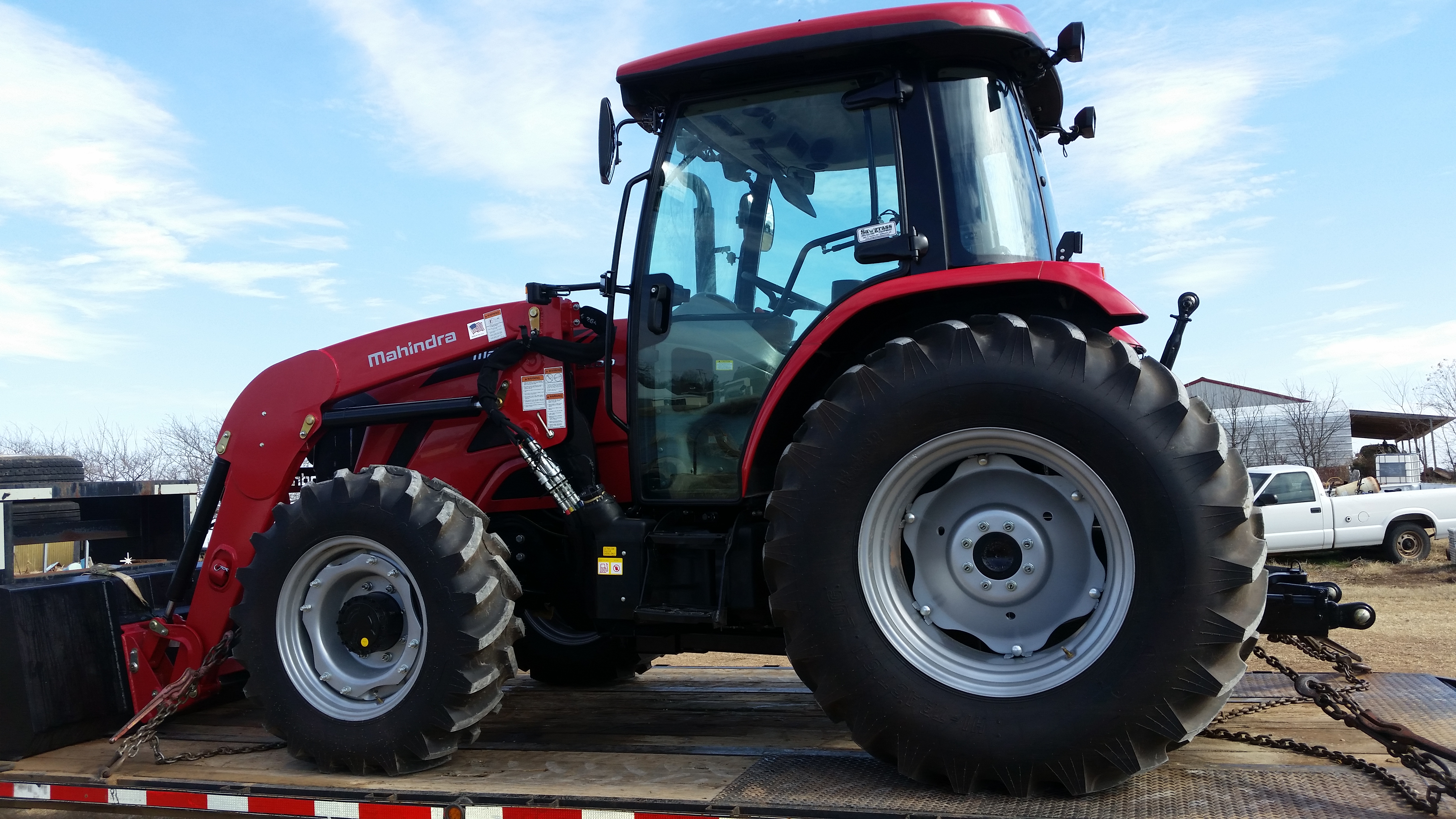

The tractor is a Mahindra 8100 cab, front assist and FEL. Mahindra says its 105hp. They weren't sure how much it weighed so I ran it across the local feed mill's scales and it tipped the scales at 10840 lbs full of fuel and no operator.
Here it is on the trailer fresh from the dealer.

The tractor has a non synchronized 3 speed range box (H,M,L) and a synchronized 4 speed gear box (1,2,3,4). It has a fwd/N/rev power shuttle on the left side of the column plus an inching pedal on the left side of the floor.

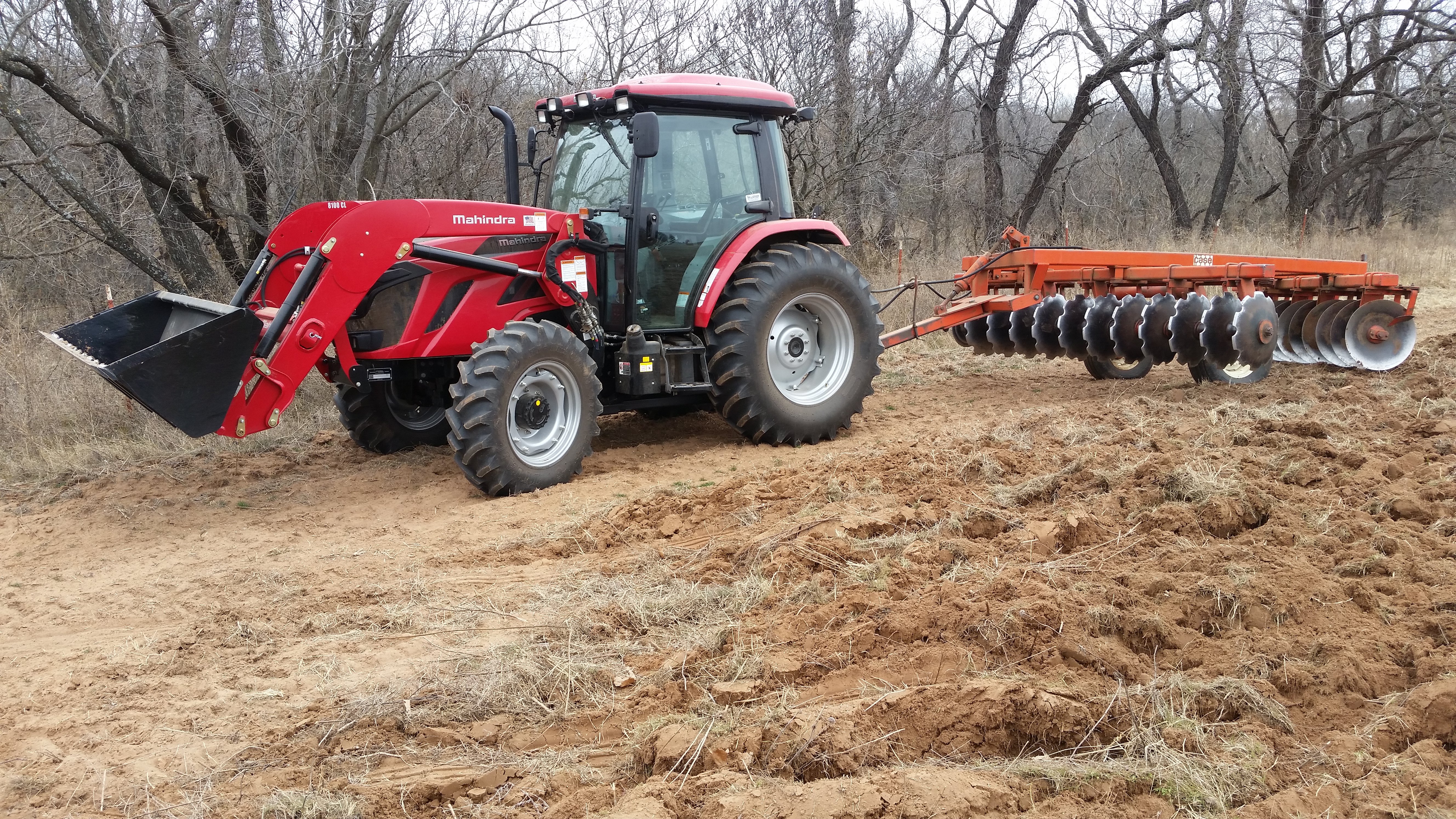

I had a big disc borrowed and the first thing I did was road the tractor about 16 miles round trip to get the disc. GPS had the tractor at 21 mph on level ground. It steered and tracked really well at speed on pavement and gravel.
After checking the fluids and setting the air pressure at 28 psi front and 12 psi rear I took that big disc down to a 30 acre bottom to see what it could do. The tractor had 11 hrs on it and they said to start using it.
The 8100 is pulling this heavy disc buried to the disc axles easily at 4 mph in sand and sandy loam. I could possibly gear up from 2/M to 3/M but the ground is too rough with 45 years of gopher mounds.

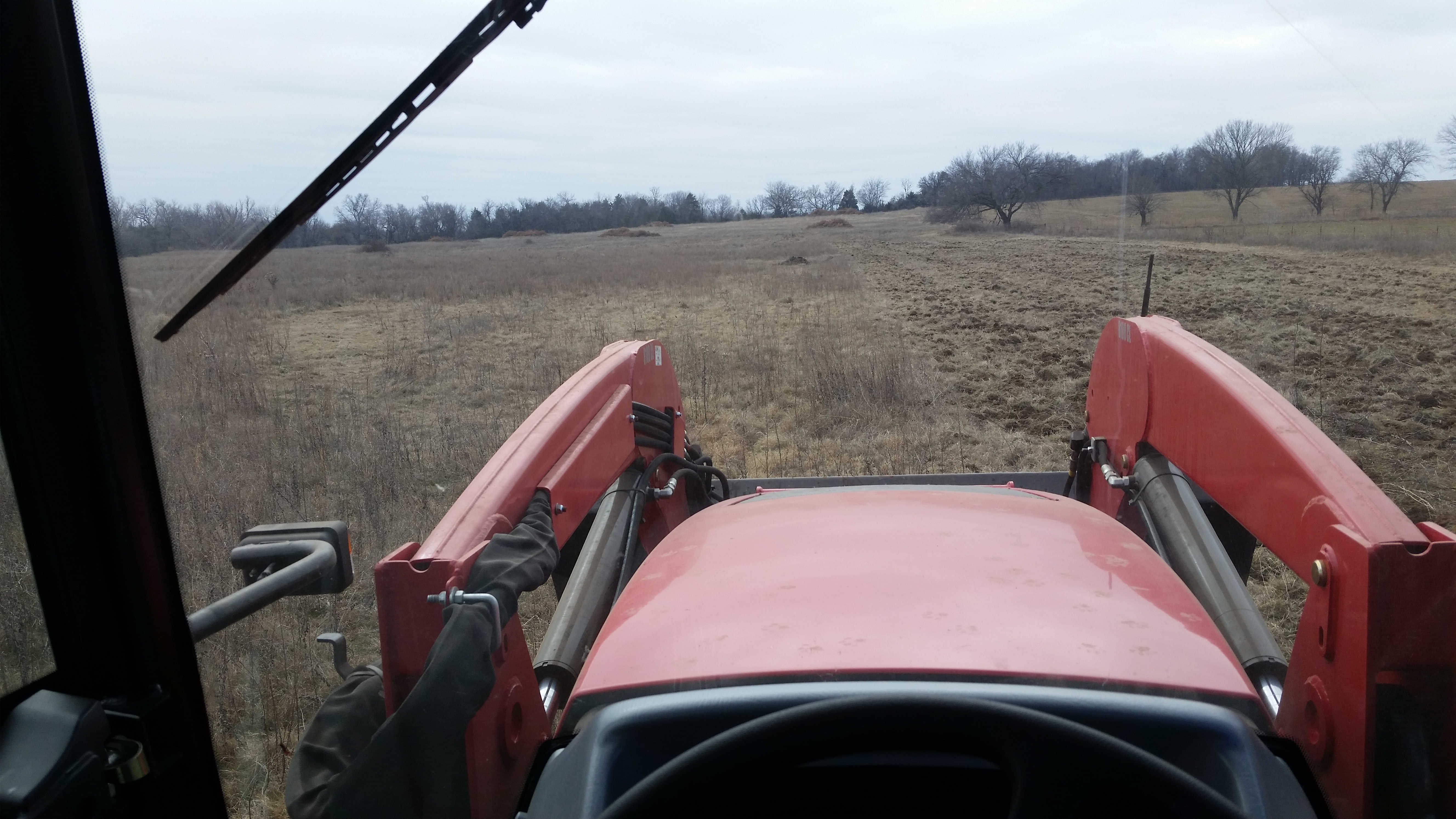

I did get a chance to put out a round bale with it and you couldn't really tell there was a bale on front.

So far I have been running that big disc down to the axles with front assist at 2000 to 2300 rpm at about 4 mph. I don't have any hard numbers yet on the fuel. I will have gallons per hour pretty soon. So far it seems to be doing well.

You say big disk, how big? Looks like an 8-9 footer to me with 22"-24" pans?
   / Prototype Mahindra 8100 shake down
I'll measure it out tomorrow.
