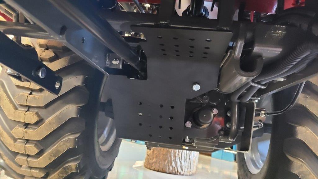

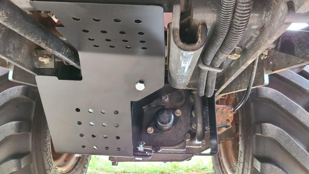

Protector for hydraulic filter and cooling fan for GC 1705, 1710,1715, 1720, 1723E, 1723EB, 1725M, 1725MB
My recent accessory is a protector for the fan and hydraulic filter.(It is black powder coated 1/8" steel plate)
You can install your MMM without taking it off. 50 hour maintenance 3 bolts you are all set.
It also has protection if your MMM drive shaft would come loose. Uses existing holes/nuts NO drilling.
You can have just high grass get caught on the fan and shaft taking out the O-ring.
The O-ring is about $8 but the labor to replace it is $$$ just like the fan.
I made one for my GC 1710 it will also fit GC 1705, 1715, 1720
Here is the one on a GC 1723E is will also fit GC 1723EB, 1725M, 1725MB

Louisiana Tractorworks & Projects John did a video install and review on the one for GC 1710, 1705, 1715, 1720
The one for the GC 1723E, 1723EB, 1725M, 1725MB is the same
except it U bracket is shorter and four bolts go to existing nuts that are welded to the frame rails.
This makes the install quicker.
